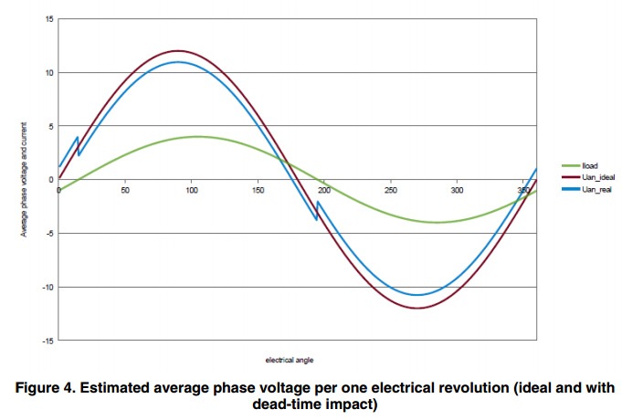

Dead-time only turns the MOSFET channels off, but the body diodes remain operational, allowing the flow of the commutation current, clamping the output voltage to one of the buses (Vdd/GND) according to the load current polarity (sign). This pulse-width error causes a volt-second loss corresponding to the dead-time, equal to (Vdd/2) * td / ts. However, this error is deterministic and can be easily compensated for, within the modulator itself.
As the dead-time error switches direction with the load current, the exact voltage error is rather sharp. For inductive loads (typical Class-D case), this voltage error doesn't occur at the zero crossing, as the load current is lagging the voltage. However, for resistive (academic) loads, this error looks somewhat similar to crossover distortion, as voltage and current have the same phase.
The following waveforms give an idea of the voltage error for an inductive load, but please note that in actual practice, the changes in output voltage (filter capacitor voltage) are not as sharp as in the picture. So, that also explains why decent a Class-D modulator must also sense the load current.
Also, please note that the picture in post #42 shows load current (A) and not the average output voltage.
For my understanding, are you assuming a circuit that switches between three voltage levels, positive, negative and zero? Or between positive and negative, with a (near) zero level occuring only during a dead time during switching to prevent overlap current?
Assuming it's three level, does that mean that for a small positive output signal, you switch between positive and zero with a very small duty cycle and for a very small negative output signal, you switch between negative and zero with a very small duty cycle?
I'm assuming the regular two-levels namely Vdd and GND, and not multilevel.
Also, there's no middle level for inductive loads, due to the commutation currents flowing through the body diodes that instead result in Vdd/GND voltage levels, even during dead-time.
If load current is positive, the dead-time output is GND and if it's negative the dead-time output is Vdd. This causes a fixed pulse-width error whose sign is opposite to that of load current.
I_load > 0 => V_out < V_ideal
I_load < 0 => V_out > V_ideal
However, in both the above cases, the absolute value, | V_out - V_ideal | is equal to td / ts x (Vdd/2). But, by sensing the sign of load current, the modulator is also able to obtain the polarity of this already known error and therefore fully compensate for it.

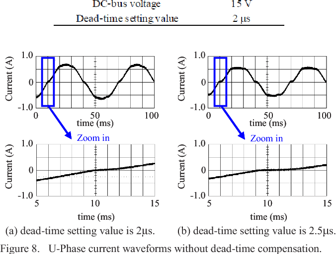

Besides, if you look at the dead-time voltage error, you would find it to be a square-wave at fundamental frequency (same as load current). In order for the loop to clear this error without dead-time compensation, a large number of harmonics of this square-wave must fall within the control bandwidth of the amplifier (harder as one approaches 20kHz). And, if this error is already cleared by means of an internal mechanism, that is something that makes the job easier for the feedback loop, and I guess something, is much better than nothing, isn't it ?
Sure, I just wonder how one can get it good enough.
I mean, suppose you have a two times 100 W class-D amplifier driving 90 dB at 1 W, 1 m loudspeakers in a room with a 1 m reverberation radius. You then get a maximum sound pressure level of about 113 dB.
When you use that equipment to listen to soft music, you probably want this square wave-shaped distortion product to be below the threshold of audibility, which is around -7 dB SPL at frequencies of a few kilohertz for young people with good hearing. So all in all, this square wave has to be attenuated to about -120 dB with respect to the maximum signal level, or maybe -100 dB if you count on masking by background sounds.

If your try working out the dead-time error magnitude for a 100V amplifier with a 40ns dead-time switching at 400kHz, you get something like (100/2)*40ns/2.5us = 0.8V, which is probably smaller than the ripple voltage itself, especially if you're operating at a high modulation index. This kind of error would be insufficient to cause audible distortion anyway.
Nevertheless, if the aim is Class-D that challenges linear amp performance, then every known error would have to be taken into consideration and improving the open-loop THD is almost always the starting point, since the closed-loop THD directly depends on it !

I think that what I was missing is the fact that at low signal levels, the sign of the load current is determined by the ripple rather than the signal, so you get an ultrasonic error rather than one at an audible frequency, except at very high volumes.
A 0.8 V peak-peak (is it peak-peak or peak?) square wave in the middle of the audio band in quiet surroundings would have been very audible: 20 mW of power into 8 ohm, so 73 dB SPL at 1 m with a 90 dB at 1 W, 1 m loudspeaker, and about the same at large distances in a reverberant room, typically around 76 dB SPL when it is a stereo system.
