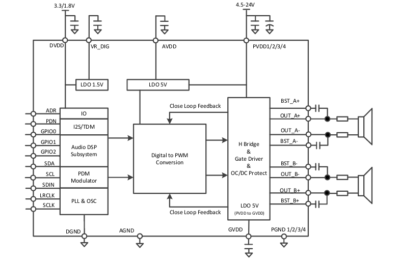

The TAS5825 spec has a couple corroborating statements "the audio path of the TAS5825M consists of a digital audio input port, a digital audio path, a digital to PWM converter (DPC), a gate driver stage, a Class D power stage..." Also - and pretty much a discerning feature of the patent; "The TAS5825M supports Spread Spectrum with triangle mode". You enable it by setting a register value.
I'm wondering more and more if the TAS5825M is the product embodiment of the tech described in patent US 7.626,519 B2...

Indeed. The TAS5825 block diagram fits better with the patent US7262658B2 that jjasniew referred to in another thread.
Yes, that's more like it and it seems jjasniew is really after the TAS5825, matching it up with the content in various patents, in an attempt to understand all the nuts and bolts within.

Maybe we don't see a full loop out to the speaker binding posts due to not so much lack of good ADC but the brutal level of errors and potential unstable loop situations? Would it suffer the same problems as to why bass motional feedback only works up to say 100Hz or so...
