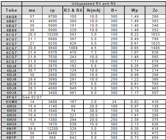

I will start building the BCF with 6N1P and anode voltage = 165V. I chose the recommanded values for R1,2,4,5 = 47K, R7=1M. For C1=2,2uF, C23=0,1uF and C2=3,9uF. I omitted the C3 and C4. Correct me if I am wrong or if you have better suggestions.
The problem is that I don't know witch value to use for Rk. The BCF manual recomands 300ohms for 6N1P with B+ voltage 240V, but I have 165V. I should compensate this voltage diference putting a bigger resistor than 300ohm or it will work fine with lower voltage too?

Attached is a table using different anode voltages and sizes for Rk(last 3 one), so I am guessing a 330ohm will be a good choice in my case
