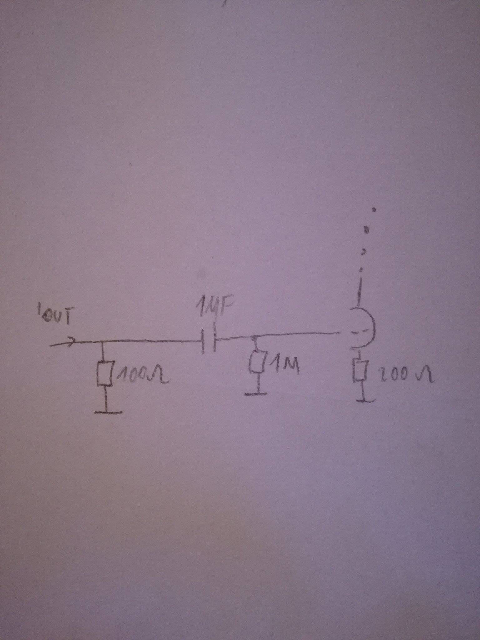

So add a capacitor between output of the DAC and the grid. 1uf and 1M from grid to gnd. You can leave the 100 ohm between DAC output and gnd
Something like this?

Adding the cap and resistor suggested in a previous post should do the trick provided the chip itself is not damaged in some way.

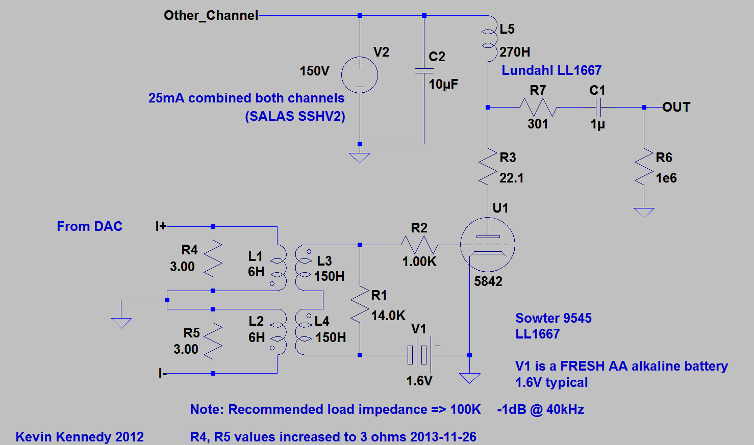

User clivem had used the BCF circuit with his PCM1794 DAC, then mouved to another aproach using transformers and tubes like in the attachement.
What are the advantages/disadvantages for using a transformer vs BCF?
I am not sure why clivem switched from the BCF circuit to transformers, but for your decision it depends on your preferences.
There will be sonic differences, but it depends on the type of sound you prefer and what you're trying to accomplish in terms of design.
THe BCF circuit is very tailorable to your sonic preferences, and can use any number of octal or noval tube types (depending on which circuit board you order).
Cost wise, the Sowter 9545 (obsolete, I think, replaced by the 1465) is expensive at GBP £105, and you'd still need a tube preamp circuit like the one you've drawn and a power supply.
The BCF circuit can be built under US $100 plus a power supply and sounds pretty nice using passive I/V from the PCM1794.
