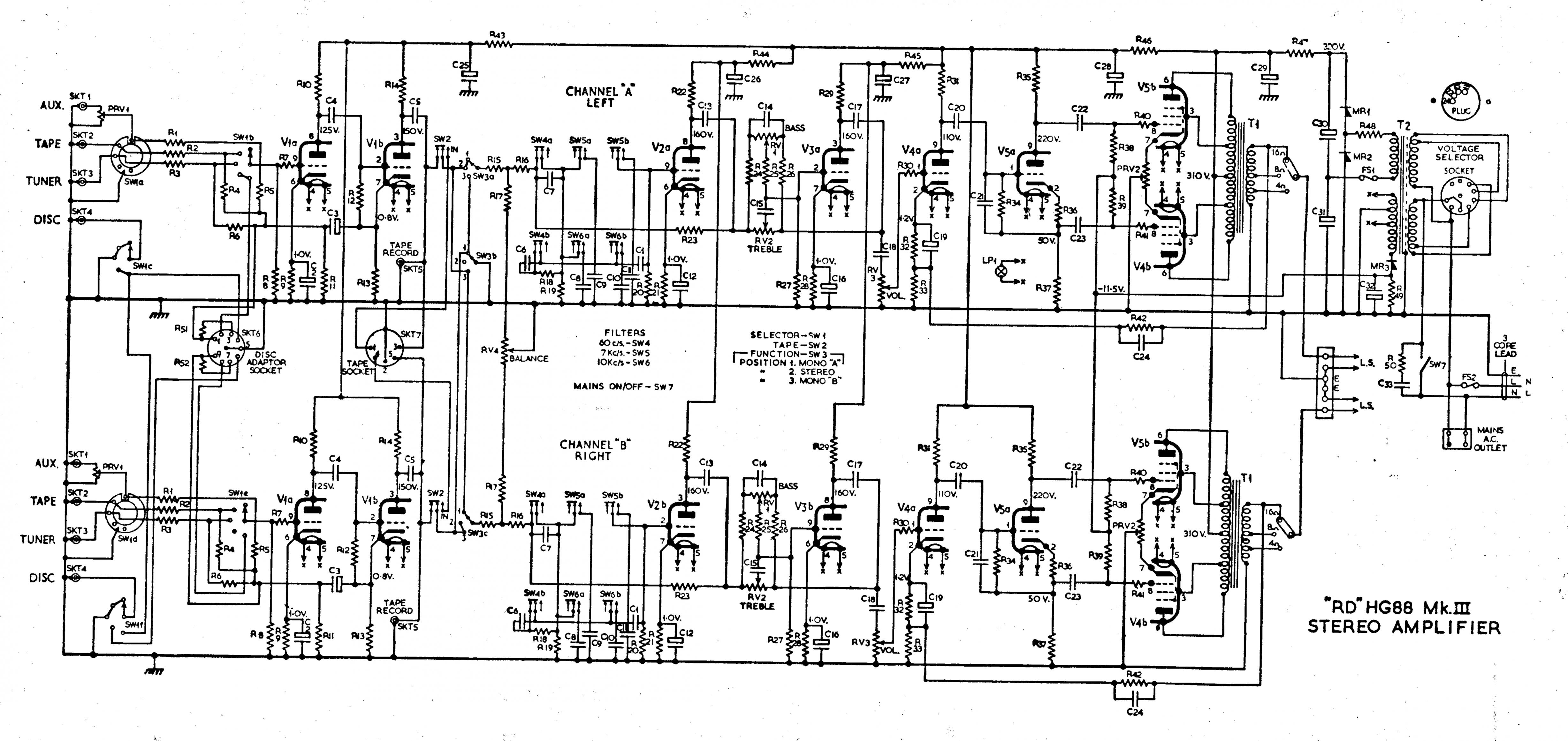

I'm still using my Rogers HG88 Mk III, which is the big brother to the Cadet Mk III, and I'm running it into vintage Wharfedale RS12DDs!
The push-pull ECL86s of the HG88 III run in fixed bias to produce 15+15 watts (+0/-1dB) at 1,000Hz.
