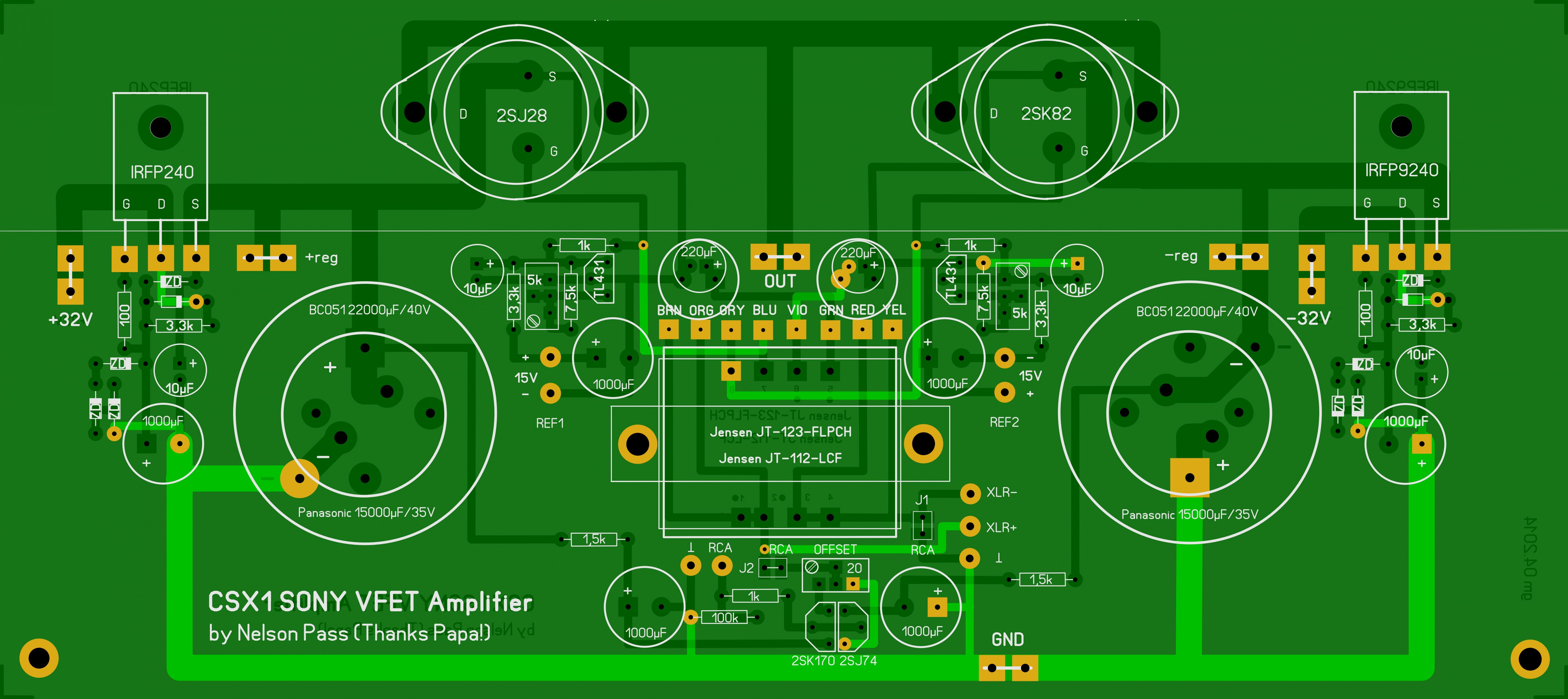

i have one question on the PCB , what is the purpose of the two 15000/22000 Capacitor in parallel with the regulator output ? i don't see them in the original schematic , is it for the VFET load or just to do a CRC filter for the Buffer?
These are the "buffer" caps of the VFETs' powersupplies. They grant a sudden powerfull ease IMO. They are not mandatory and you may leave them. I like their tonal signature yet.

thanks for your reply i was just worrying about the stability of the reg but if you use it like this and like it better it"s fine for me, do you have tried to bypass it with small MKC or MKP ?
