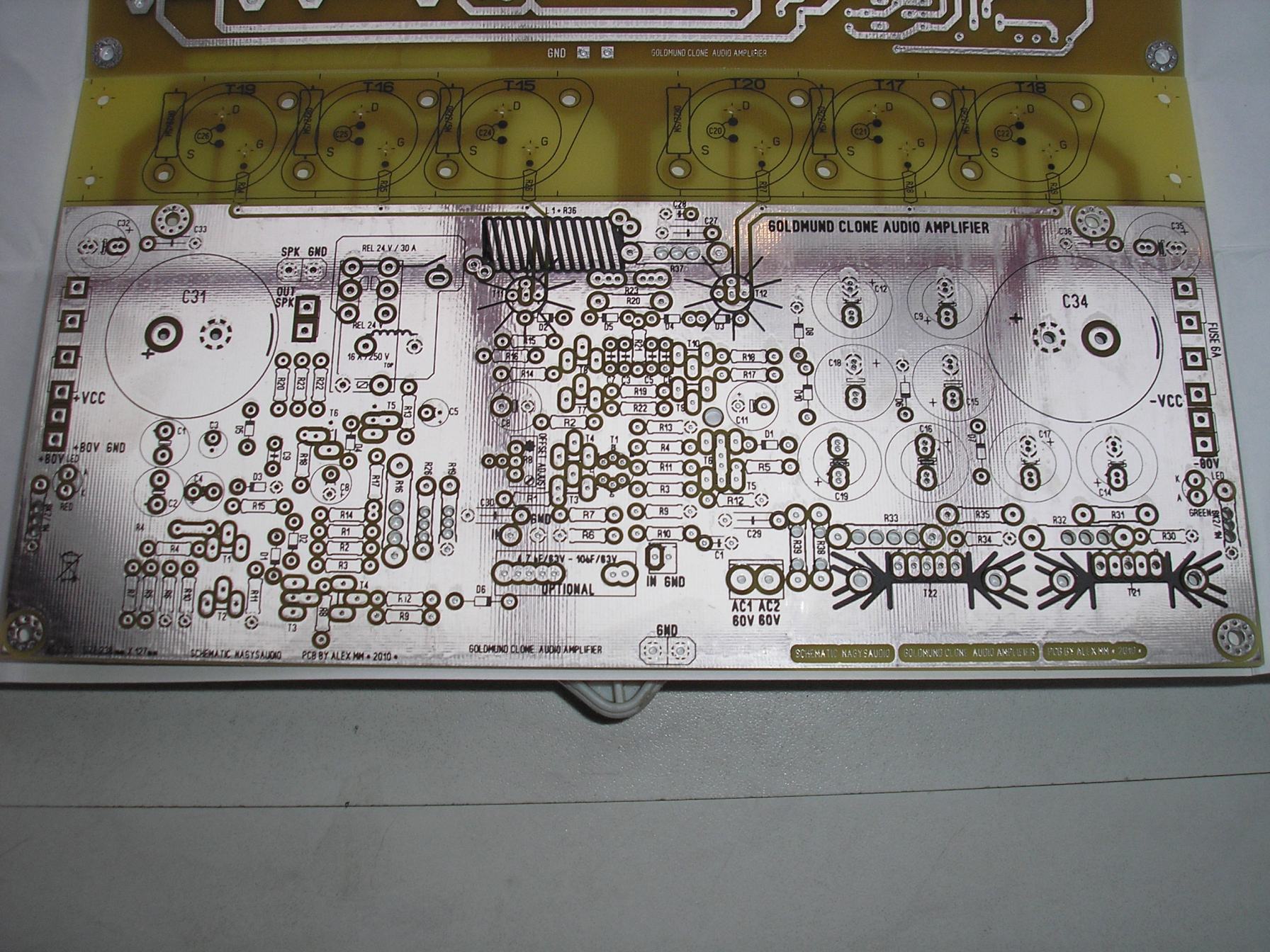

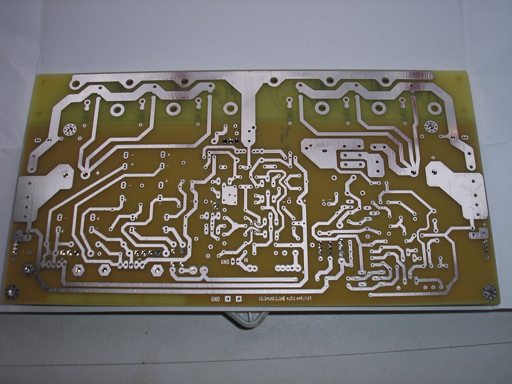

The Goldmund boards arrived
Hallo all,
The boards arrived here in The Netherlands Bigpanda thanks.
It’s difficult to make a good picture, I make the pictures close by the window.
Rudy

Nice boards. Thank you. I hope to order a pair extra for my friend Roar Malmin
later. Its depends on if my attempts will be a success or not.
Questions: Protection: R24/C6/C7. They are not on the original schema, and I do not find any place for them on the PCB.
Explain this for me, please.
R 25? Where. Underneath???
C1 on the amplifier is orginaly 47 pF. This can be changed to 4,7-10 uF and placed on "optional". Right???

protection :
the resistors and caps that you mentioned are on the original protection schematic that I have. Please see the other link. They are actually on the main amp. circuit and it takes me a while to recognize them when I first examined the protection circuit.
main amp :
C1 is 47pf but not the optional one. The optional cap. is there when I first receive the pcb file from alex and since it is purely optional, so I just leave it there. There are 2 signal inputs, one of which includes the "optional" while the other doesn't.
"My data book says that the BC 546 B is equivalent to BC 182 B. But I mean to remember that in a previous post it has been mentioned anything that the T5/6 must be BC182B". Nagys mentioned that we can use BC546B for T5/6 in his former posts, please check. I am almost 100% sure that's what he said though I don't know if that is so. There are extra pad holes for these alternatives (also bc449 in protection), please do not put into the wrong hole!!!!

"protection :
the resistors and caps that you mentioned are on the original protection schematic that I have. Please see the other link. They are actually on the main amp. circuit and it takes me a while to recognize them when I first examined the protection circuit".
It is R24/C6/C7 we are talking about:
PCB consists of a protection section on the left and the amplifier section on the right side.
Alex has "moved" R24/C6/C7 from the protection section over to the amplifier section on the right and given them "new names".
Now R24 =R37. C6 = C28 and C7 = C27.
Bigpanda I think it would be a good idea to create a small explanatory note about this on your attached pdf files.

Hi Liliya
if you look at this from the "other link"
I had made some changes (or additional) in red : the elec. cap polarities, the components designator and also 2 red square. The red squares are what you are doubting. I also mention this in some past post in the original thread. If you are going thru the old posts, please find for me where they are. Tks

Bigpanda van you please explain:R 25? Where. Underneath???

I had some ‘crippled’ boards when my vendor made a trial run for my order 3 months ago. I had examined them last week and come to the conclusion that with some touch-up, they can be used.
For the 10 medium size electrolytic caps C33, C35, C9, C12, C18, C15, C19, C16, C17, C14 in the main circuit, the pad holes are undersized. For these 10 caps, with the exception of C18, C15, every lead has a ‘spare’ hole which was first implemented to take care of pitch problems. If we drill thru 2 holes (1 for each pole), destroying the plate-thru in them, its "shadow" hole which had not gone thru any rework will still provide connection between the top and bottom pads. For C18, C15, we can overcome the problem by drilling an extra hole next to the original hole connecting the top copper plane but not thru it, retaining the plate-thru within the hole. For the ‘partner’ hole which has no connection to the top copper layer, we can drill right thru it w/o problem because it is soldered on the bottom side where tracks are running into anyway. We can also use this method for treating the electrolytic caps (which do not have spare holes) on the protection circuit also. But of course, the soldering will not be exactly like normal for the reworked pads and these caps will be slightly off position when view from top of pcb.
You can have these for $34 / pair (which includes shipping + handling) Please send order to tony_chan_cf@email.com with forum ID, paypal a/c, no. of pairs, /w subject : "order white silkscreen GM boards".
