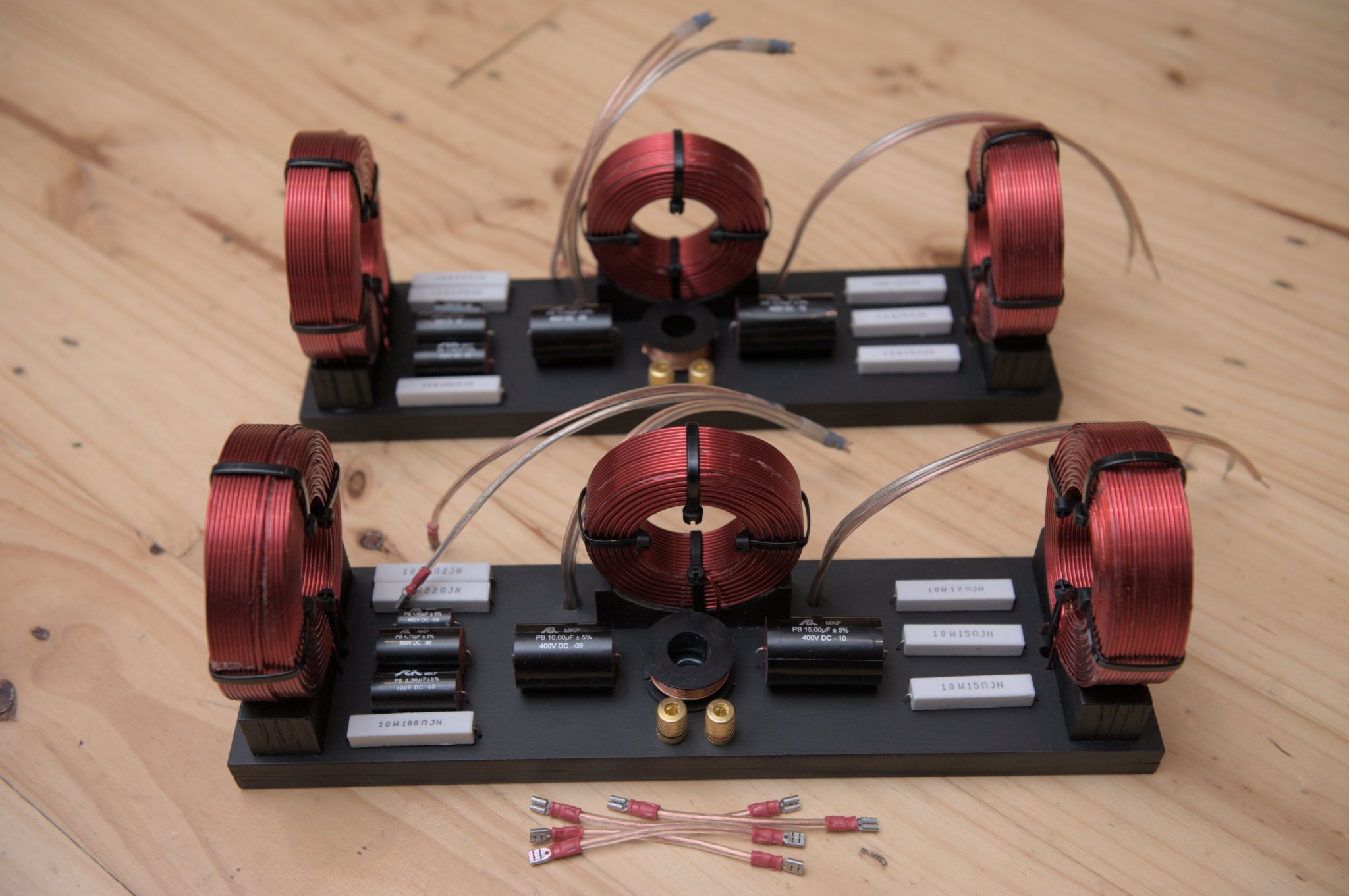

I had to stick with what I had available, 1/2" Corian that could be cut to size. Once I securely mounted a sizable ground wire, the other connections came easily. I am against ty-wraps and found a good silicone adhesive that held anything in place that needed to stay put. epoxy was used for a few spots, and finally, strong, quality , spring loaded connectors were used for the drivers. To make taking the crossover out of the cabinet easier, I used banana connectors inside of the cabinet.

Corian leftovers from a countertop maker. Easy to work with using a table saw, drill or sander. Solid not flimsy like what I see or have worked with before. "Famous" speaker maker who charges zillions for his work, used a flimsy, and yes, I mean flimsy, thin breadboard to make a crossover on. If you can't start with a decent base, you already don't have my respect, no matter how much the other components cost.
