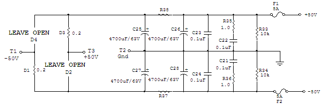

Hi Sheldon,
Using an external PS will work fine. Just make sure that you bypass D1 and D3, and not D2 and D4. Here's a schematic you can use for reference.
Al
Thanks too, it will be very useful in my project to revamp an HMA-8300
Some questions :
1) purpose and ratings of the 0.2 resistors replacing D1 & D3 ?
(why is a simple strap not suitable ?)
2) do we still need C25->C28 el-caps if the ext PS has already a good filtering capacity ?
