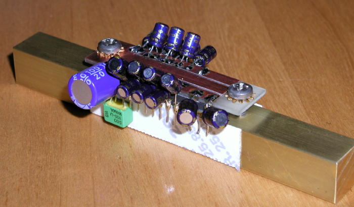

How do you think chips secured by soldering their legs on Veroboard pads - then legs and components connected by hardwiring would work out?
Argo
Dead bugs!!
Ahhhh, thanks for the advice. I knew a tech who used to do his hardwire dead bug style. Never knew why he did it that way.... but now I do. Very interesting idea. I'll give it a try 🙂

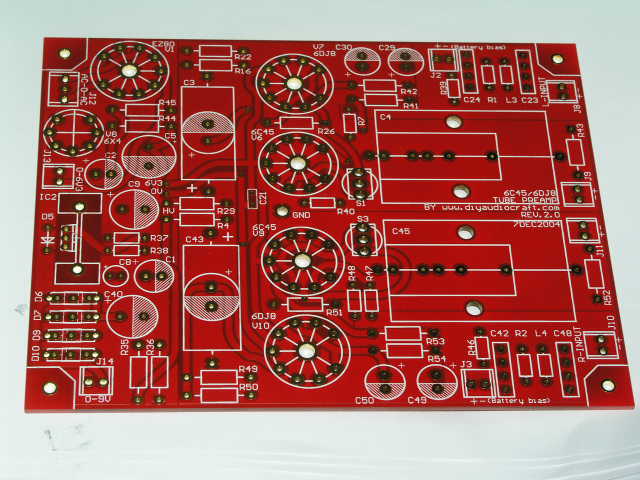

Dear TV man,
this is the tube buffer test print of the twins TDA1541a version II pcb.
This new PCB was added battery bias for 6C45/6Dj8 SRPP tube buffer. Also one more socket was added about for it. It is in Tube rectifier place. Then this pcb can use ez80,81.we412a & 6x4 tube.
thx
thomas
