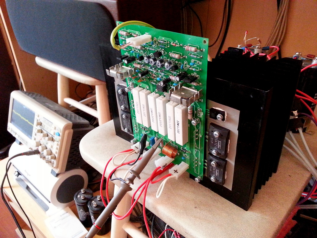

did this one in 2011

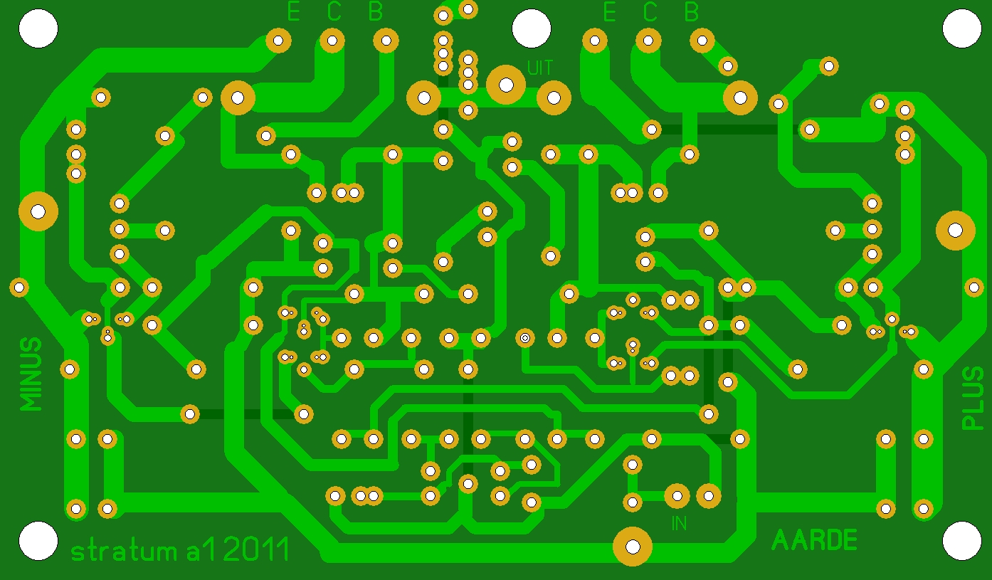

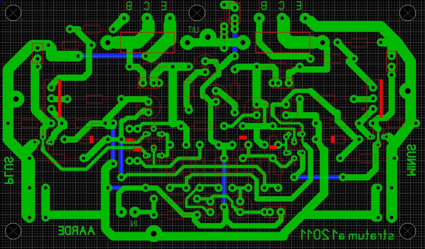

I have built many many own versions of the A1, A100 and A1000 since 1991 till 2012. Mostly on veroboard but this one I redesigned to make myself some pcb's.
You see the pcb from above with x-ray. You have to sort out which component has to sit where.

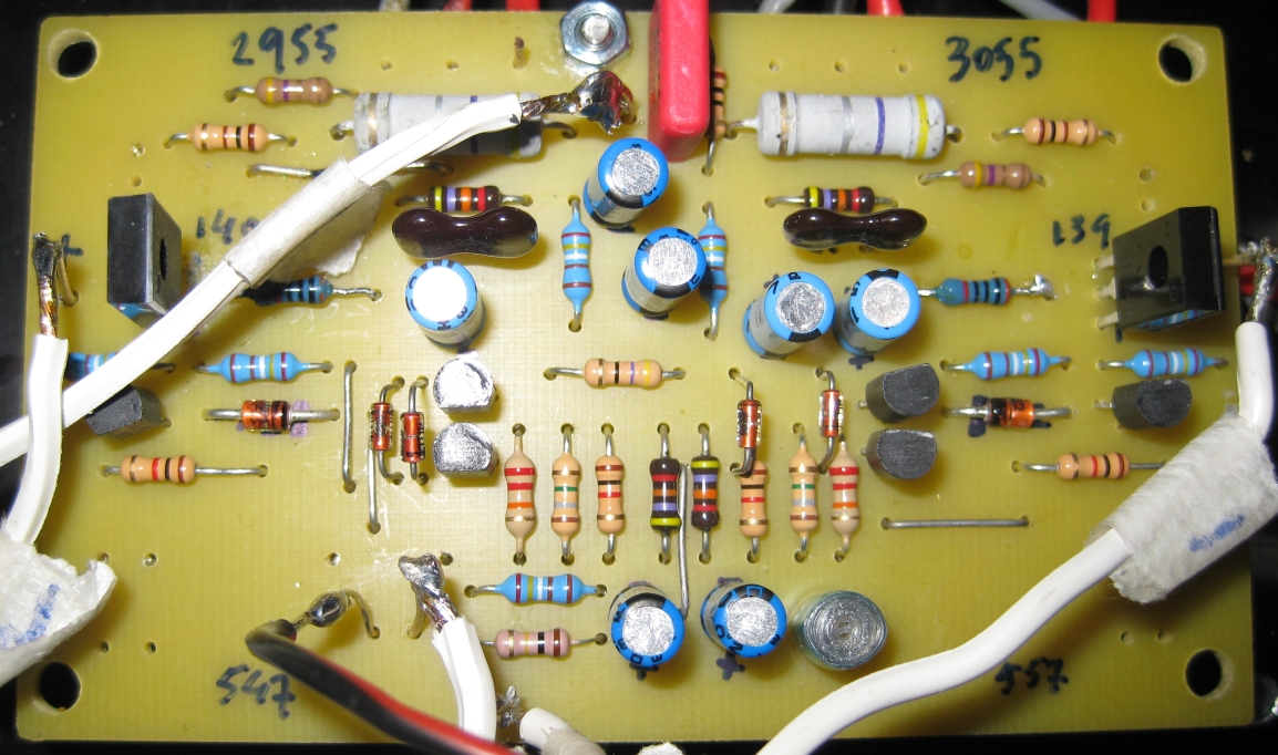

As said I made tens of copies. I'm probably the person who tested the most variants of this circuit in the world (is it? I'd like to hear others):
- several layouts
- pcb and hard wired
- own design and copies from china
- a1 and a1000 (parallell versions)
- fancy components and cheap versions (as is the original)
- small power supply, heavy power supply
- big cooling and moderate cooling
I have to pay my respect to MF for making so musical a design with a minimum amount of components and money. It is quite hard to accomplish this task yourself! I needed 10 years to come to this conclusion ....
Yes, it is way better to buy dead piece of original one and remake that one. But: the original becomes too hot, so thinking creatively about cooling the stuff will pay off.

Thank you very much Mr. rmgvs for the pcb layout and all the other informations.
No thank needed mr Georgescooo (well, you can see my name on the pcb ..). I would appreciate your findings when building your amp. Even after all these years I'm not totally sure what exactly determines the sound of this amp. I'm quite sure the small caps (22pf, 680pf, 333pf) do make a difference soundwise (the values of course, but also the material and brand used).

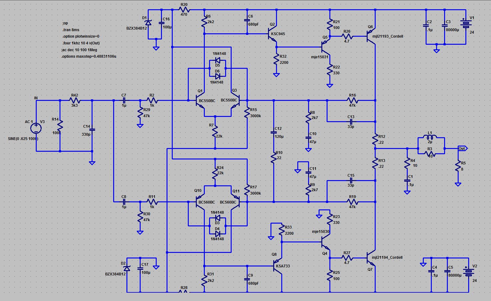

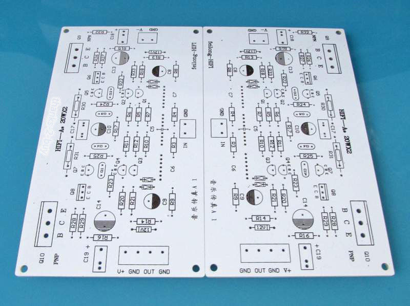

I bought some clone PCB's from an eBay seller and I took time to simulate the A1 amplifier with the parts I am going to try out. I have the parts on hand and I am ready to stuff the boards as per the schematic from my LT Spice simulation. The simulation seems to check out pretty good.
Is there any conflicting advice I need or do you think I should proceed as per the simulation? I guess I'm looking for a sanity check. ???
