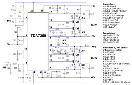

I have all the components for the TDA7250 amplifier with output transistors 2SC5200/2SA1943!

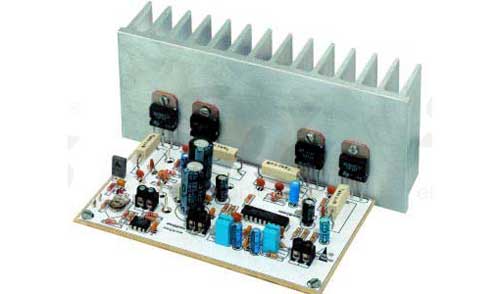

Neither can we understand ... I need the TOP PCB layuout (See picture above!)!

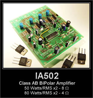

Here is the web page.
You will need different transisors for their board. The circuit is a little different from yours.
You will have to ask them about the price for the PCB as it is not listed.![]()
As opposed to discrete designs, the IA502 uses an IC to drive the power stages.![]()
The entire power amplifier circuitry for 2-channels are squeezed into a tiny TDA7250 10-pin IC. All that's required are four power darlingtons and some passive components to complete a high performance stereo amplifier. No biasing is required as the IC auto biases the output transistors.
The IA502 lends itself well to multi-channel amplification.
A 6~8 channel power amplifier can easily be constructed even by beginners.
IC Chip Amp IA502 (Measurements by RightMark RMAA) - AmpsLab

I need PCB (Figure not Picture) for stereo amplifier with TDA7250 with output transistors 2SC5200/2SA1943, not Darligton transistors!🙁
(See schematic above)
