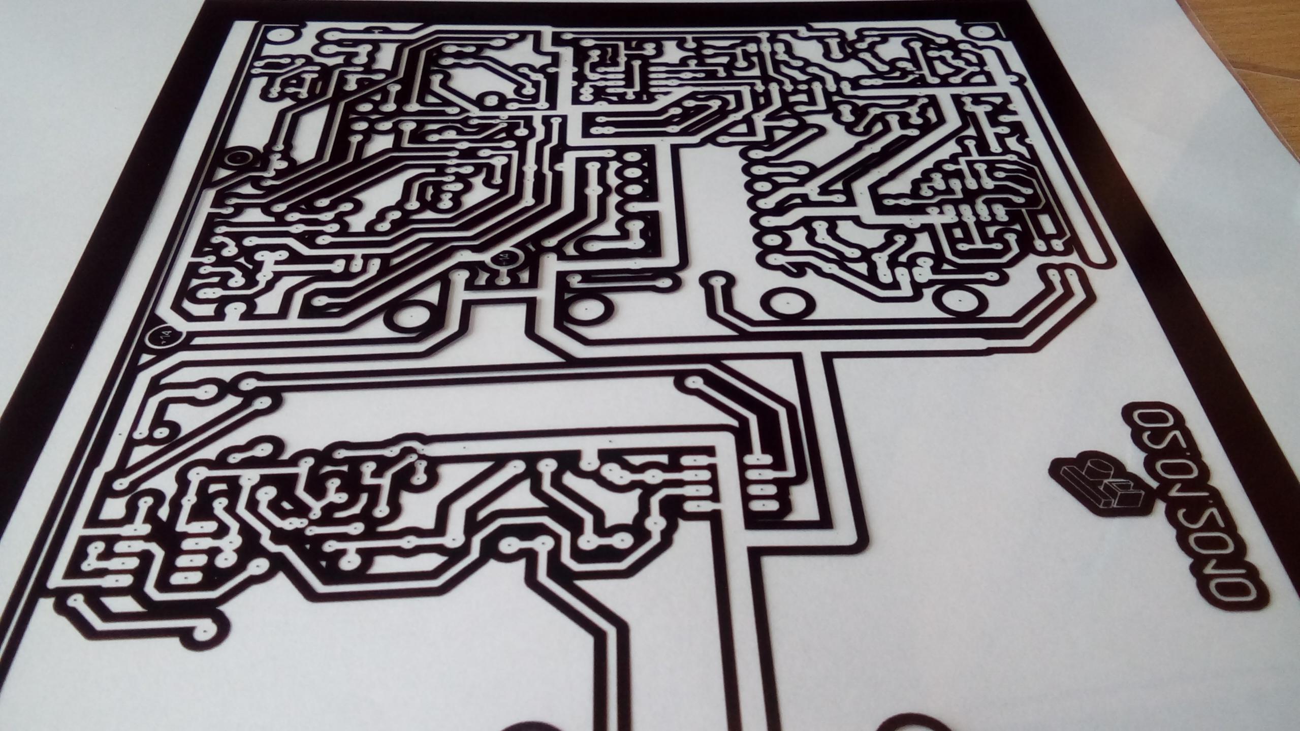

I did made a negative artwork with Gerbv but it give a black border because it is colour inverted to get what I want, I do not now if there are other ways so the black borders are not present, maybe here I get a answer. I get it from gerber output to postcript with gerbv.
thanks
IF your process requires negative image, then you need the black border too, which would mean a copper free area in the final PCB .

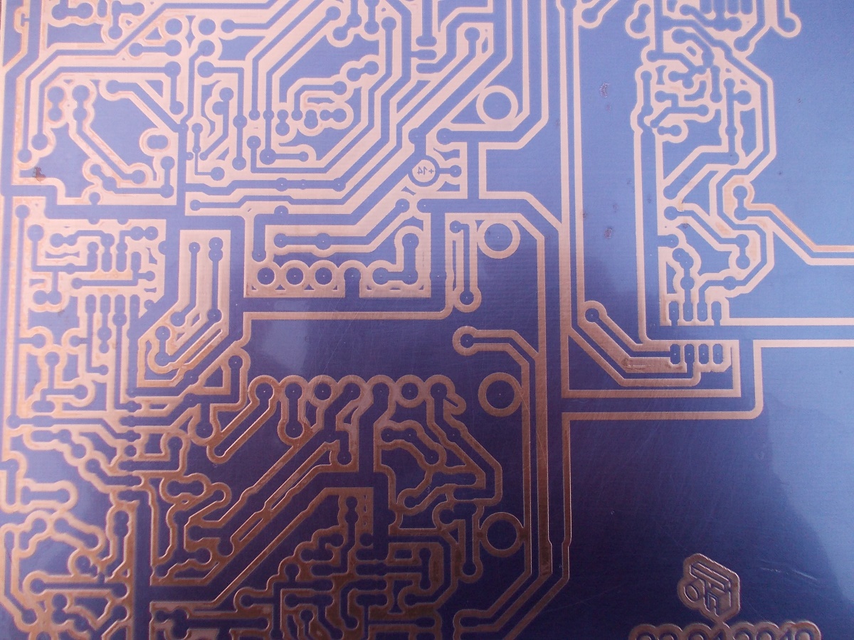

I have now made the print after making the film, I have found ink who is so black nothing go through, I have the negative resist and have the temp of the laminator 120 degree, I have change the rolls in that laminator so 1.6 mm can go through by putting copper sliding bearings in it. that works like a charm.
I did print high photo resolution with also use of the black cardridge, it did very wel, never had such black result. pcb is sharp developed just try some cardridges, I did use cheap ones from local store.
I need some practice to get resist on pcb without wrinkles, but tips are welcome afcourse.

I find that "floating" the resist on under water really works well. Just put board and film in a container of water, slowly lift the board up to the film, lift out of the water and gently smooth with your thumb to get all the water out from under the film. You can gently dry the film at this point if you want (I use a squeegee, gets the water out without wrinkles). Found this method in one of the many on-line videos on board making. Note: use water around room temp. Too warm and the film will stick to the board before you can get it smooth. Too cool and the film will not stick, making it difficult to keep aligned and un-wrinkled when running it through the laminating machine.
I put the board with film in an absorbent, paper carrier and then run it through the laminating machine. this keeps the film from being wrinkled by any slippage or differential motion going through the rollers (keeps the roller clean, too).

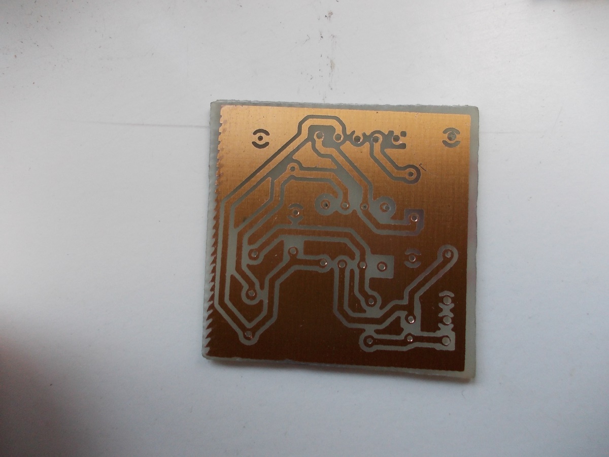

I found a brother B&W laser printer with doors on the front and on the back ,it says it will run card stock ,so I'm going to try some different thickness of circuit boards to see if they will make it through it ,and come out like I want it too. Has anyone got this to work correctly,I am going to warm the board up before it goes through,it ran 4 sheets of paper easy so i will try it.
Will any toner work with any printer ,I have search on the net for black plastic toner but most are made for a specified machine.
Nice boards Kees52,I will try that if the printer won't run the boards,

Generally people apply the toner to a transfer vehicle, not to the PCB itself. Then, the transfer paper/film is laminated to the PCB. One reason is that the PCB is such a heatsink that it's likely that any printer will not be able to fuse toner directly to a copper heatsink.
The imaging drum in a printer is usually pretty hard. I'm fairly confident you'll destroy the drum - or at least scratch it beyond repair - if you feed PCB material through. Then add that most (all?) printers have photo sensors that will cause the printer to stop printing if a non-standard paper size is detected. Surely, you don't want to cut all your board material to standard paper sizes.
I'd stick with brochure paper and just do the toner transfer. It's pretty easy and the results are generally good.

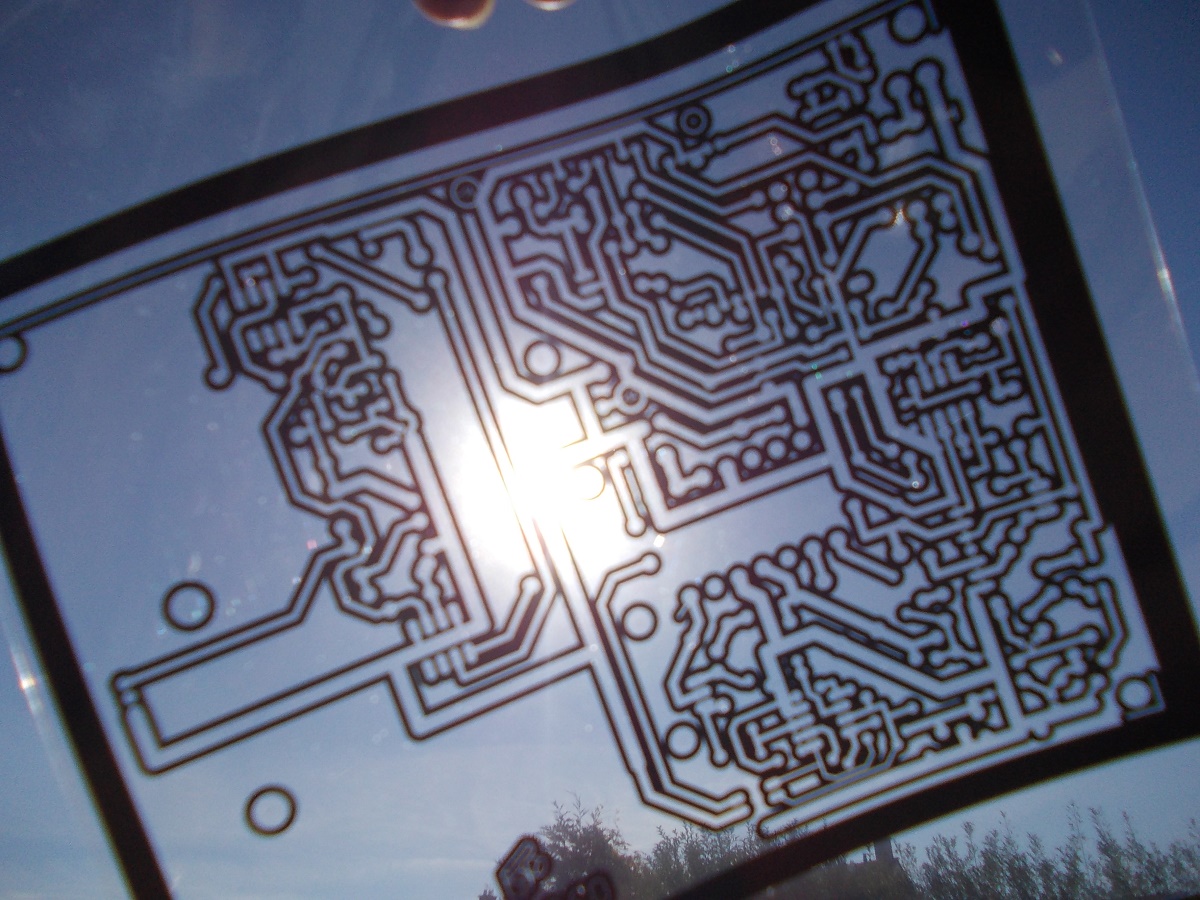

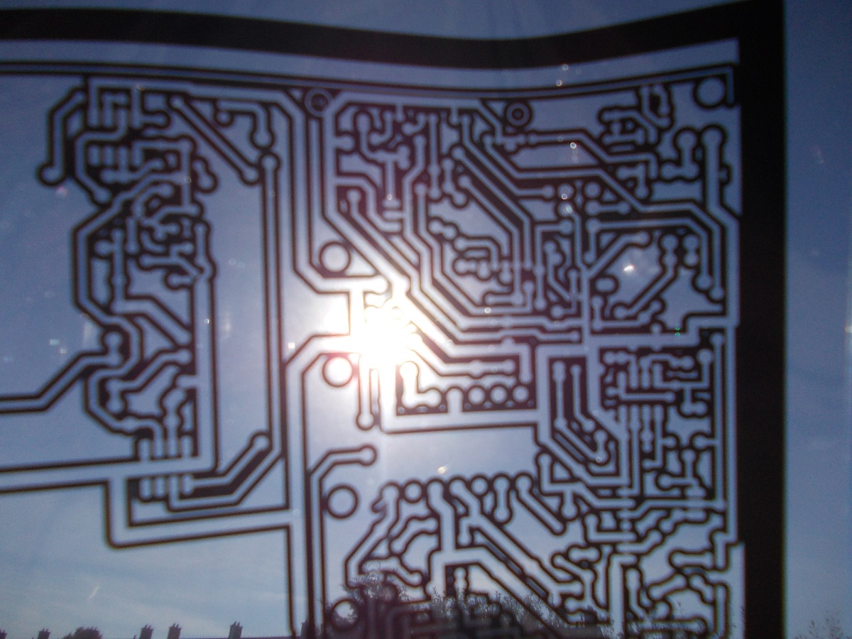

Putting a board through a laserprinter wil not work, it will be damaged because the path is never straight, and card bord is 0.2 mm thick and can bend, a pcb do not and is 1.6 mm thick, I did it with the epson inkjet DX8450 in photo mode.
Make pictures with a very bright sun behind it, in freehand so it is not sharp, but give idea how black it is with that cheap chinese ebay transparancies.

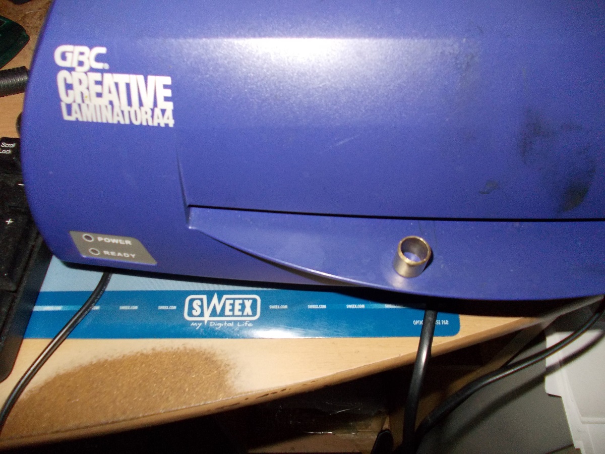

I have bought this laminator second hand, a nice thing who can even as high as 160 oC.
however it is badly damaged by the mail office who send it to me (Kiala).
https://www.youtube.com/watch?v=71QqBL6qmYA
But is a very strong one.

Nice industrial type,LOL. That's should last a long time,I didn't know about foil,pretty neat.

I have a crack in the silicone roll.
