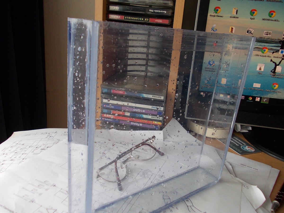

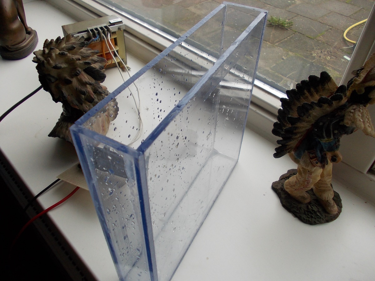

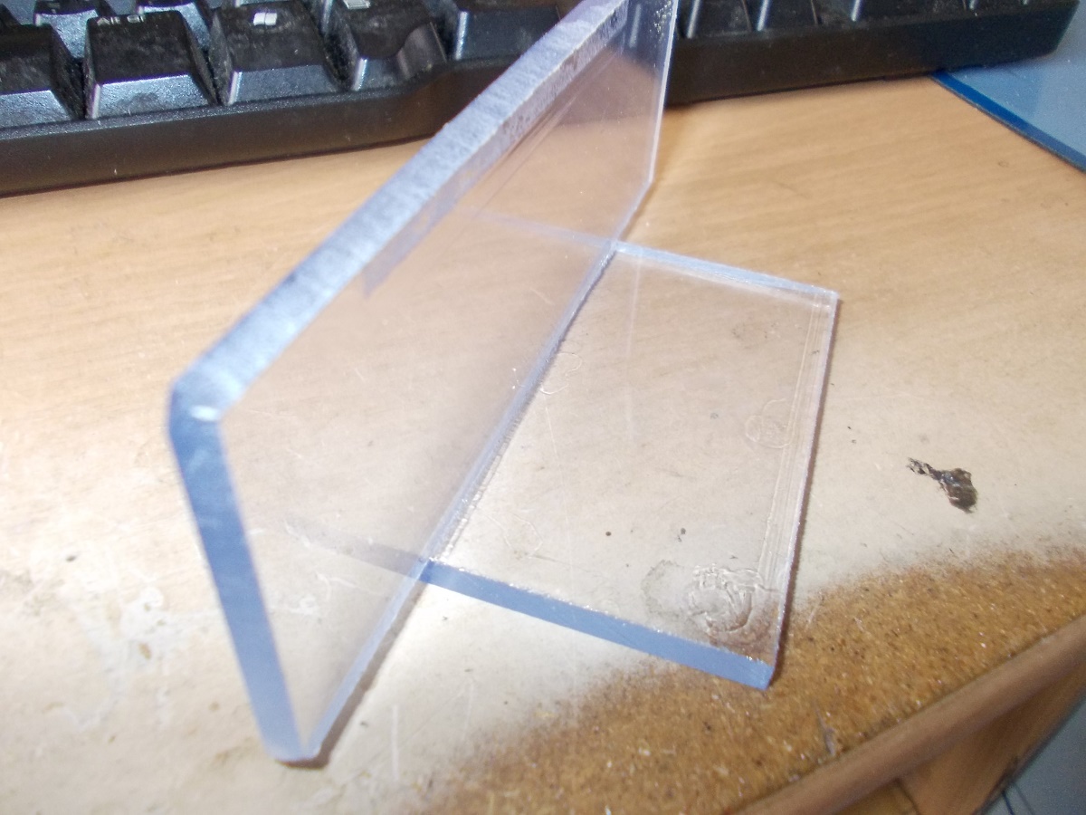

Ihave make some photo,s from the idea to make a tank from plexy glass.

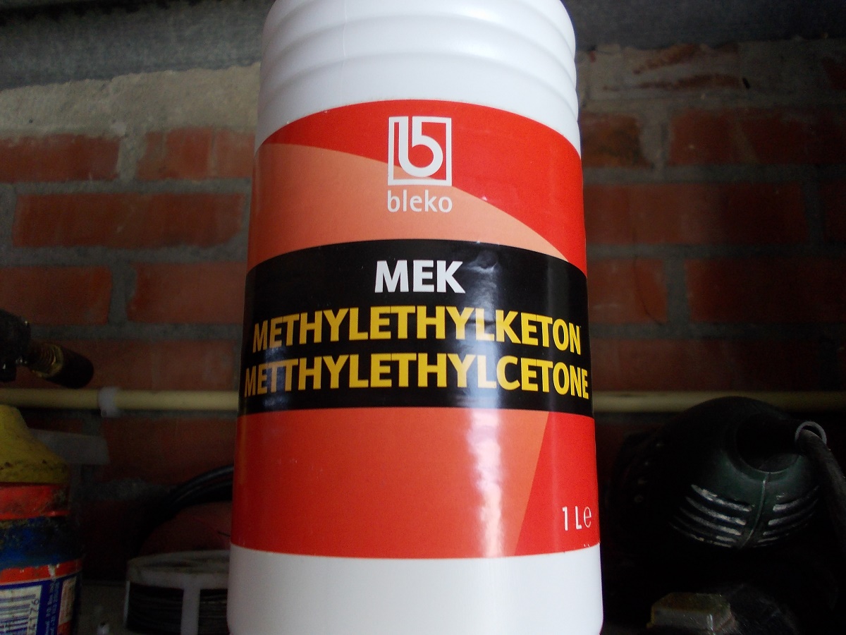

I do glu it with MEK, it do well, unbelievable strong.
Do not breath the fumes, but it stinks like acetone, this stuff is used by painters to get fat off.

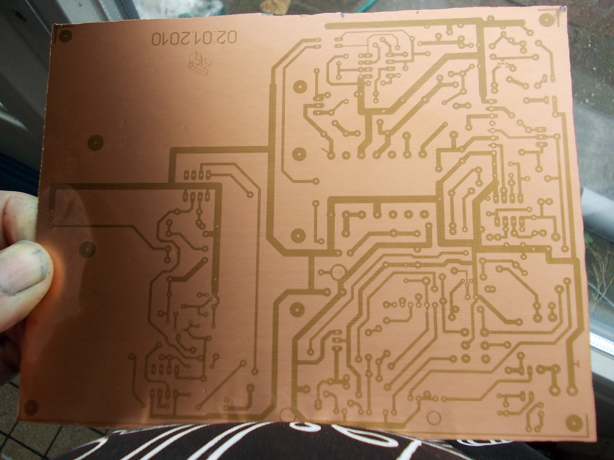

I just use a tray for etching, preheat the etchant, and (carefully) slosh it around. I try to keep the exposed copper to a minimum, so I use up less etchant (ferric chloride), and this has the nice feature of allowing me to see the copper etch away under a bright light. The copper etches into a brownish plume, which largely stops once the pattern has been etched. It's easy for me to then see when the etching is done, and control the amount of side etching (undercutting) done to partially compensate for the squished toner.
The toner transfer part is the tough part, and I suspect that my printer's toner is more of a PITA than others. But, what can you do… it's not practical for me to find or use an ancient LaserJet.

Making the etching tank like I tell above is very easy and looks good, just big enough and small for the biggest I ever pcb I ever do.

That's where we part company, I use the UV and transparency method. A standard inkjet printer will do stuff as fine as anything you might see on a commercial product.
I actually agree with you there too - my complaint is more with the imprecise nature of toner transfer, and not the quality of the laser printer images I get - they're crisp 600 DPI images, and I've tweaked the process so that the software doesn't mess me up with half-toning stuff or the like, which might be fine for documents, but disastrous for resist and etching!
With toner transfer, fine traces and features can get sabotaged by tiny flecks of toner that don't get transferred, and also sometimes by small features 'spreading out' during the lamination process. For example, I just can't seem to get an SOT883 footprint to work, but that's usually not a big deal - alternate packages are usually available. With care, I can do a DFN1212-3, so it's not hopelessly sloppy, but just not quite as good as the smallest packages require.
I've thought about using UV and transparencies, but at this point, I can get a cheap and 'good enough' single sided toner transfer board for a breadboard circuit, and I really need to start using commercial processes so I can use multilayer boards with solder mask and holes. For me, this would make more sense to spend effort on… 🙂

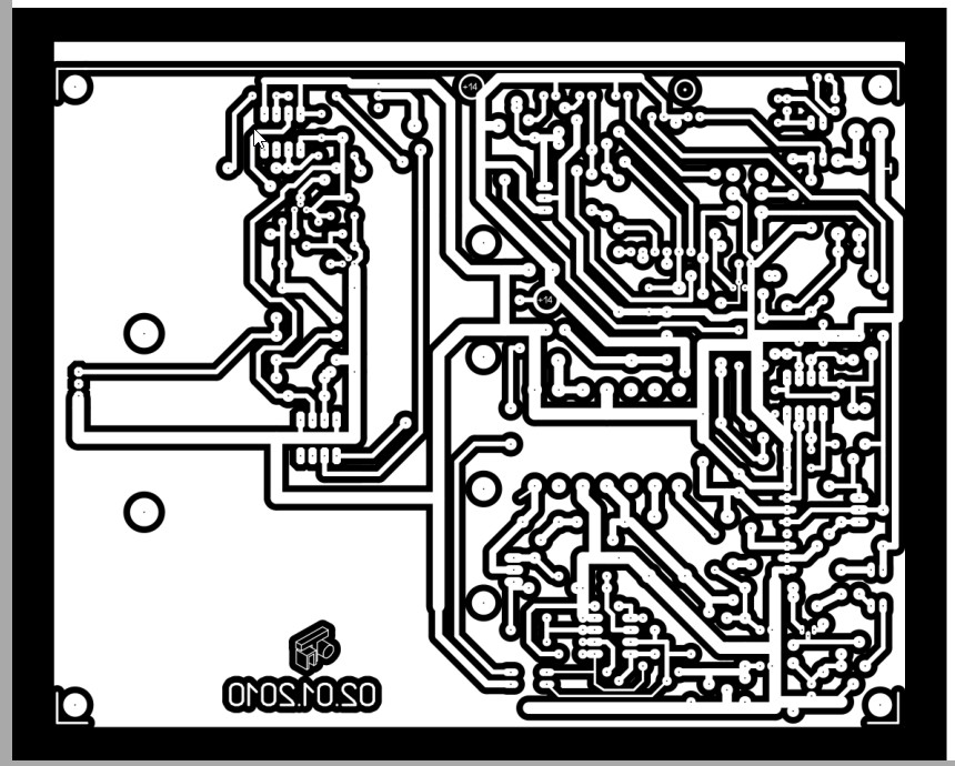

I did made a negative artwork with Gerbv but it give a black border because it is colour inverted to get what I want, I do not now if there are other ways so the black borders are not present, maybe here I get a answer. I get it from gerber output to postcript with gerbv.
thanks
thanks
Usually, there is a setting in Gerber tools that lets you define the outline. I don't know Gerbv, so I can't say anything about it's settings. Any postscript tool that allows you to trim the outline ???
I did use ghostcript for printing and did not find that option.
can try gerber tools but that is a soft with a license I think.
But is not a problem, I can use it as it is, I go search for some tools who maybe can first.
thanks for thinking with me.
