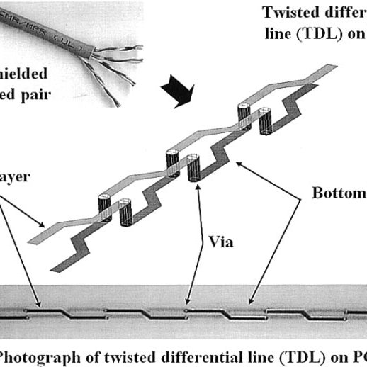

  • Schematic-and-the-photograph-of-the-newly-proposed-twisted-differential-line-TDL_Q640.jpg

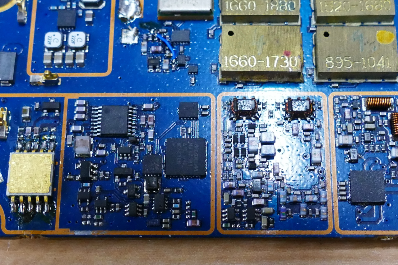

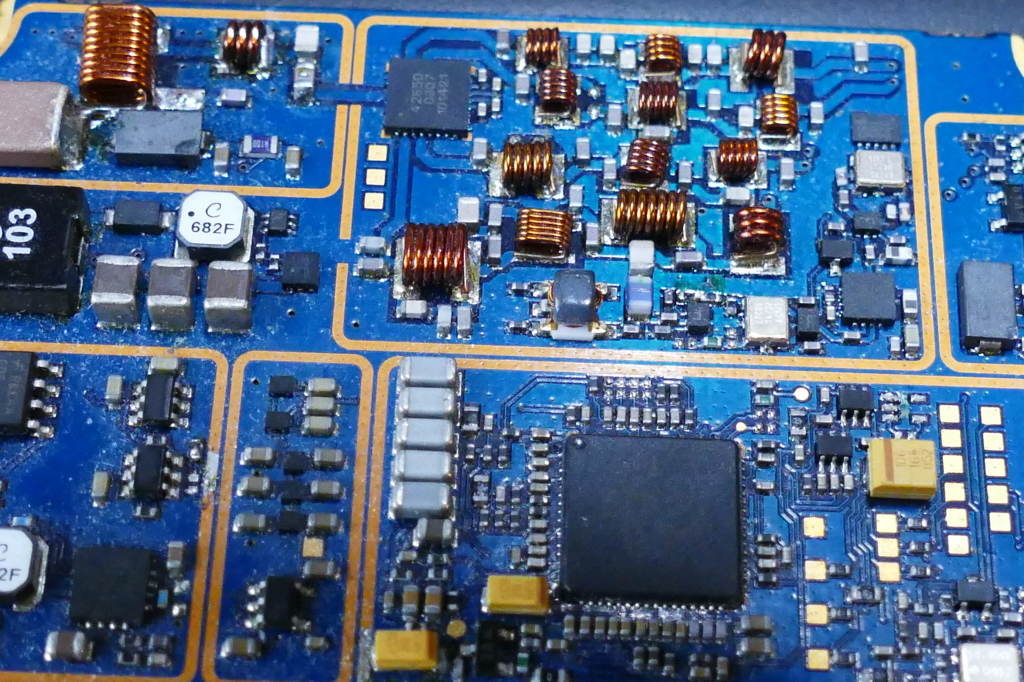

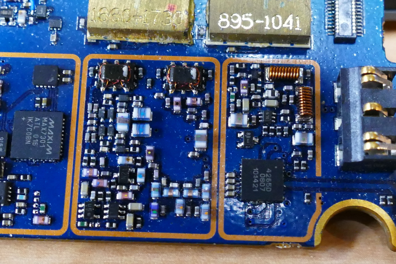

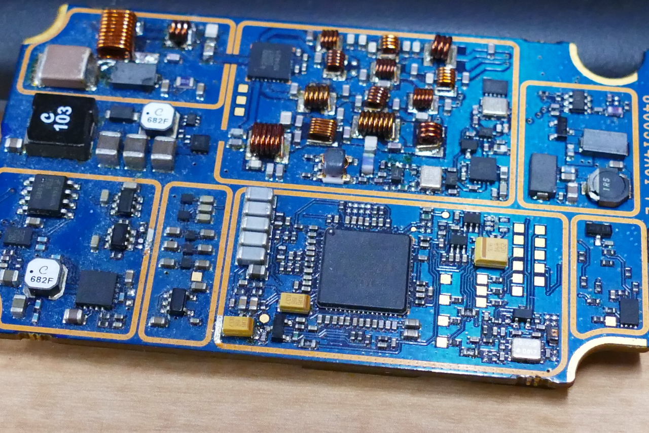

Here are some photos of a PC board I laid out about 12 years ago for a prototype two way radio. This is the RF board that mates with a separate digital / audio board, so there is no low level microphone audio on this board. There is 5 to 8 watts of RF power from 136 to 941 MHz, low level RF receiver signals in the less than 1 microvolt range, digital communication over SPI, I2C, digitized RF at 22 MHz, and a boost converter producing 28 volts at half an amp from a 6 to 10 volt battery pack.
This is a 10 layer High Density Interconnect (HDI) board. It has a conventional 6 layer layer core, with two additional thin outer layers of traces and vias photographically deposited onto a thin (1 to 2 mils) layer of material similar to the solder mask on each side. Very tiny 1 to 2 mil vias can be placed on these layers for very high density required for high pad count BGA chips.
Each subsection is fenced off from anything that could interfere with it, or to prevent interference to other subsections. After stuffing the board metal shield cans are soldered down on these tracks. They are not on these boards since these are prototypes for testing. Those are the gold tracks seen in the photographs. Very tiny via holes can be seen in these tracks tying all the outer layers together. There are lots more scattered throughout the board, but covered by the outer blue solder mask. You will see a few larger vias that tie all the grounds together on all 10 layers.
Most of the RF runners are on the outer HDI layer, or the outer conventional layers (not visible). The noisy digital buses are sandwiched between two ground planes in the middle of the board and heavily fenced to create "virtual coax cables" inside the board.

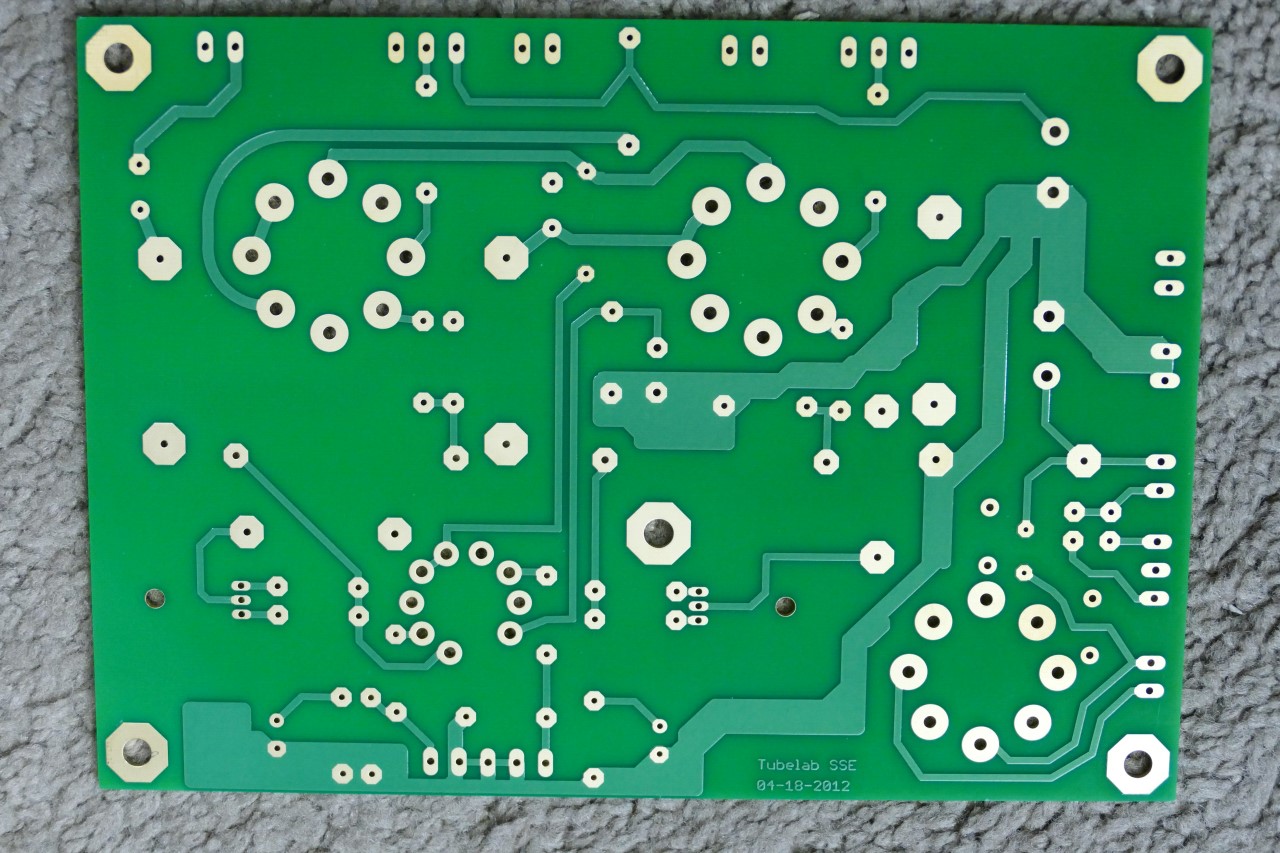

When laying out a simple audio board, especially one containing a power supply, the designer needs to consider all the current loops in the design and keep them separated, usually joining together at one point, often called the star ground. This is usually the negative terminal or common terminal (with split supplies) of the main filter cap(s).

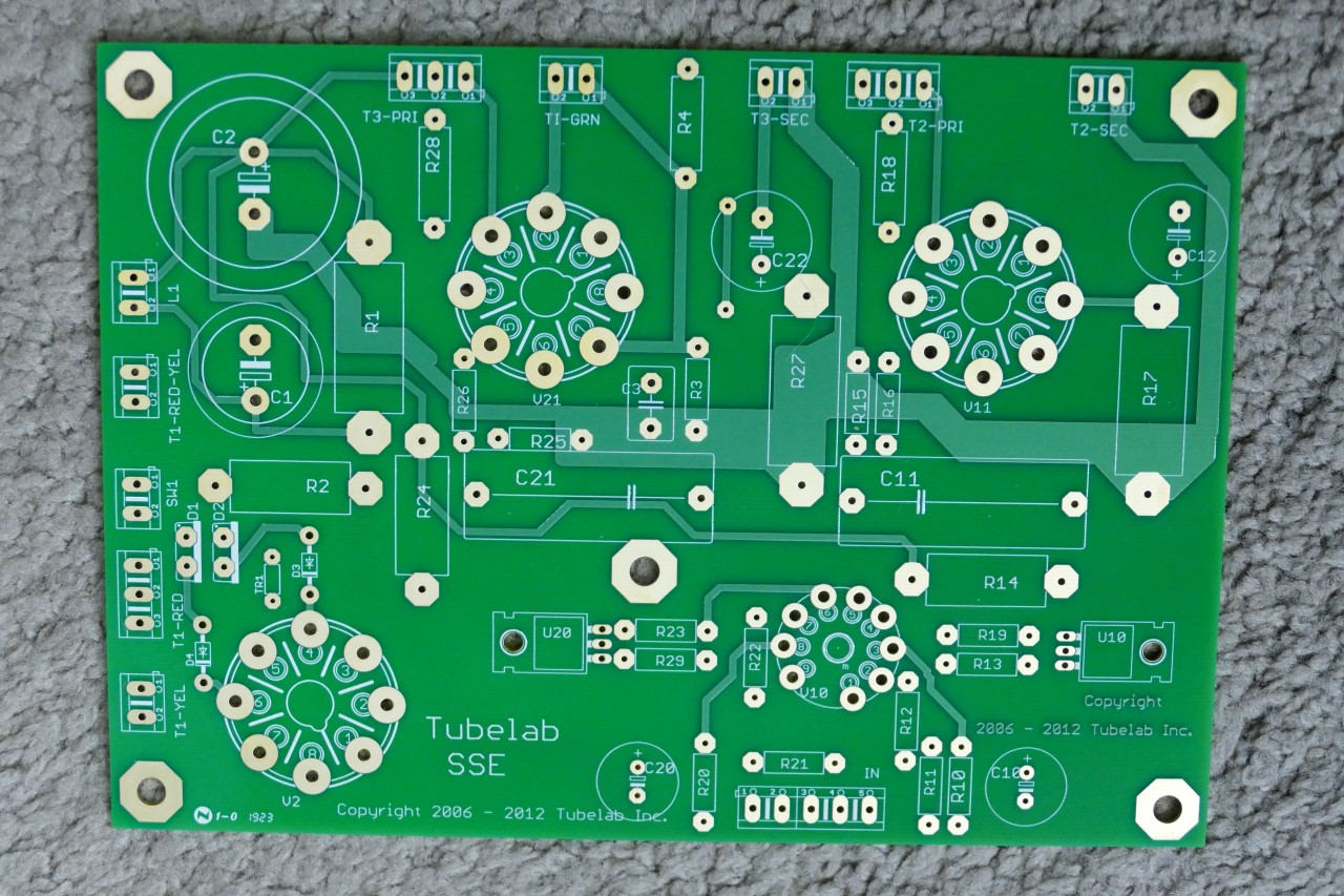

Here is a picture of my Tubelab SSE board from about the same time period as the radio board (2006). The grounds from either side are joined by through plated holes for component leads. The star ground point is the negative terminal of the big filter cap in the upper right on the back side of the board. There is a fat runner to the terminal connector on the right side. This is where the HV center tap on the power transformer is connected. The rectifier tube is below this. All of the noisy charging currents for the filter caps are constrained to this area, walled off by ground from the rest of the board. There are brief high current pulses topping off the filter caps on the peaks of each cycle at a 100 or 120 Hz rate. These must be kept out of the audio sections.
You will also see a fat ground trace going downward and left across the board to the input connectors, This is the return ground path for the signal input and driver section of the board.
There is also a fat trace extending leftward across the center of the board, it continues leftward on the front side of the board after passing through three parallel component holes.
Because of the high current the path mentioned above (C2 to R27 and R17) is duplicated on both sides of the board. This is the discharge path for the power supply capacitors through the OPT's and output tubes. B+ is routed to T3 (an OPT) on the top side of the board, and T2 on the bottom side of the board. The returns from the OPT's are routed to pin 3 of the output tubes, whose cathodes are connected to R27 and R17 then back to ground at the filter caps. This is the high current discharge path for the power supply. It is a separate loop from the charging path, meeting only at the "star ground" point. Keeping these two loops separated is key to low hum and freedom from oscillation.
The driver section has it's own separated loop from the power supply. There is a dedicated trace from the positive terminal of C2 to R24 and R14. This provided power to the CCS chips which feed the plates of the 12AT7 tube. The CCS chips provide a 60 dB reduction in residual hum, providing the driver tube with clean DC which flows back to the star ground through R20 and R10. This is a third separate current loop, again separated from the other two, meeting only at the main filter cap.
Heater current is a completely separate loop. Entering through a connector at the back of the board. It is biased to about 45 volts above ground by R4, R3 and C3. The ground tie point is to the fat trace that returns output tube current to the star ground. Do not connect this to anything near the input of the amp.
Mastering these techniques are key to making a good WORKING audio PC board (or a PTP design)....... the pretty ART is up to you.
