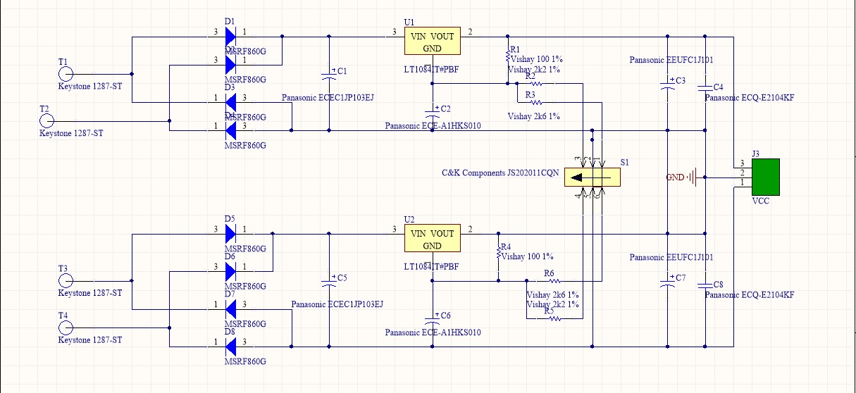

Knocking up a chip-amp power supply PCB and have a quick question - using dual positive regulators (LT1083) with the positive/ground connected (to form quasi-dual voltage), is it better to have pours on both sides of the PCB for + and - and earth traces, or a single pour on the top for just earth and power feeds through (thick) traces?

Ok, so here are some photos. While I am good with the practical side of things, I am fairly terrible with PCB design (as will be evident).
Schematic. Fairly stock standard stuff - however I have a DPDT switch in there between swapping out two resistors (will be wired off board) to change the output level depending on what speaker impedance I am using; I've just thrown some approximate values in so far so these will change depending on what voltage output I'm getting.

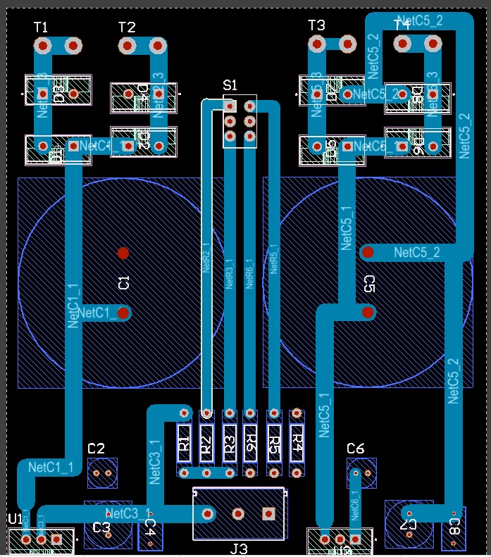

Components and traces. I really struggled to find a 'logical' layout; if they were positive and negative regulators I'd just mirror one side but as they're both positive I couldn't find something that looked ok with both regs in a good position to heat sink. The legs may need to be bent slightly to allow them to clear that trace right on the bottom of the board (which I guess I could move to the component side)

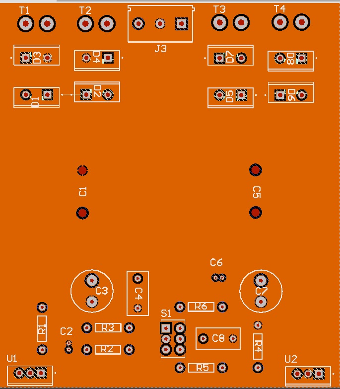

Ground fill. Nothing fancy.
Thoughts/feedback/etc? I'm aware it probably sucks haha

Your layout problem starts with the sch.
It is wrong.
pin2 of S1 should read the output voltage at the bottom of C4. Similarly C2 needs to reference that same output node.
Your layout then needs to implement that node. This is where the OUTPUT Zero Volts is.
I think there is comment in the LM317 datasheet that the inductance between 317 out and R1 should be low. This would require R1 to tap onto the 317 Output trace, instead of tapping into the output voltage.
This makes it important that the output +ve node should be kept very close to R1 and 317 out, to minimse the voltage errors that will exist along that trace.

Because you are using a top side plane, each of the nodes can be a small area of plane and the plane minimises the inductance. Make the plane work for you, you don't need theoretical "point" nodes, close proximity is probably good enough.

C4 is just a bypass cap for C3 - 100uf electro and 0.1uf MKT respectively. C2 is Cadj for the regulator (mentioned in data sheet to improve ripple rejection >60Hz). I need to increase the size as I've just noticed it's the wrong value going through the data sheet (should be 25uf; not 1uf).
Regarding the resistors - I've put a few adjustable regs together before (this is a LT1083, fyi) and I was under the impression that how I've set them up is correct - R1/R4 develop the 1.25v reference voltage and set current, and R2/5 OR 3/6 to the zero-out (also in this case, the -ve rail) via the switch set the output voltage. Pins 2/5 on the switch are connected to the zero-out/-ve too, so as you flick the switch it changed the output voltage dependant on the formula (in the realms of 28 and 32v as listed).
If I have done this somehow wrong, could you please sketch it up quickly as I am struggling to see how your explanation of what I need to change is exactly what I've already done

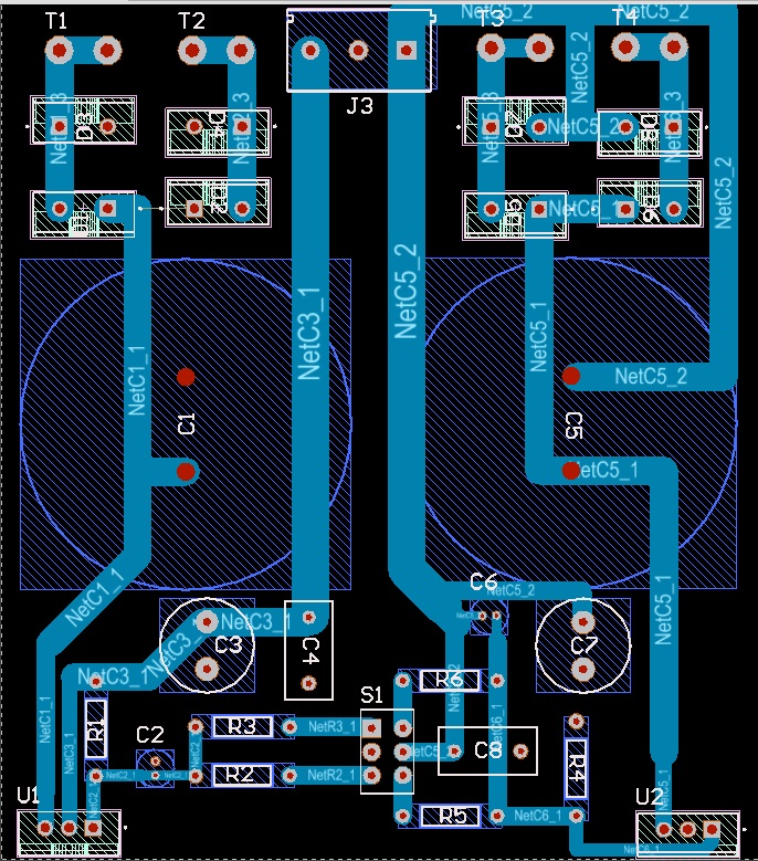

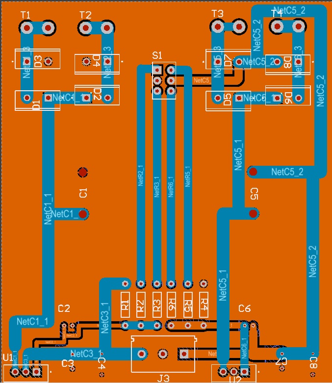

Ok so I got way better at this. I'm still 99% sure my schematic is correct - can somebody else confirm?
Improvements:
*input/rectified rails are almost symmetrical and running adjacent to each other
*output rails symmetrical and run opposing each other
*'R1' and output caps physically close to regulators
*components almost completely symmetrical
*majority of traces now 1/8"
*0v (incorrectly labeled as GND) has more copper to through-holes
Things to change:
*fix labeling
*remove copper between two input pads for blade connector
