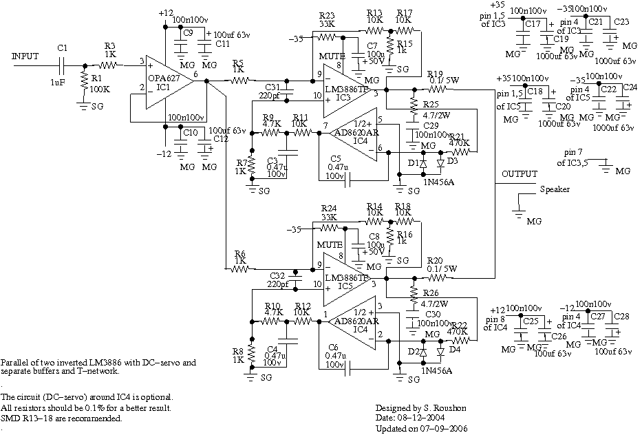

PCB design of parallel of two inverted LM3886 with buffer and dc-servo.
Getting back some gain
Finally checked after shifting the attenuator at the input of the buffer. No problem
now, the sound is excellent except for two minor issues:
1. Need to raise the volume almost halfway to make the amp audible, which
I do not mind much.
You're currently using the OPA627 as a unity gain follower. Its fairly easy to make up some of the lost gain (from snipping out the 100R in the T-network) by configuring this opamp to give you, for example, 20dB gain. Your attenuator circuit gives a maximum -6dB so at the very least it makes sense to run the OPA627 stage at +6dB to make up for that loss - I'd go for turning it into a X10 stage myself (18k feedback, 2k to ground).
If you want to keep the attenuator at the output of your OPA buffer, I think that's been the cause of your problem since it has an output impedance of 10k, and the input impedance of your LM3886 stage is only 1k. If you still have it between the OPA and the LM, it will only give you a gain of around 6dB from the power amp stage and plenty of instability as the 3886 doesn't like such low gains. So, instead of the 100R in the T-network, use a 1k in this position and your problem is solved.😀

all is well
Replaced the t-network by 1K. Now both the channel are silent. Although
initially some noise was appearing in the faulty channel when volume was
raised and voltage also was flactuating. Needed to do lots of isolation
of diferent power cables and speaker wires from ground bass to get rid of this
noise. Now everything is perfect.

You might be getting RFI-induced sibilance. I've encountered that on many of my chip-amp circuits. The first thing to check is the grounding for the input cable. If the screen of your input cable connects on to the PCB, that's probably the problem. In my experience, the solution is to run a ground cable alongside the input signal cable connecting the input ground terminal (presumably on an RCA-phono input connector) to the star earth. Disconnect the screen of the input cable at the PCB.
If this does indeed solve the sibilance on applause it will have other beneficial effects on the sound stage too.

opened!
Could not wait for the vacation. Just spent a day opening the amp and made
the following changes. Left it in its parallel form.
1. removed the 1 mfd input capacitors
2. moved the buffer in between the amp and the attenuator to avoid the
impedance mismatch
3. removed the 1K t-network resistors to move the gain down to 20. this
also solved the not-so-zero-volume start problem
4. solved the grounding problem: input cable screen sent directly to the
star ground
Now the advantages: zero RF, zero hum, sound seems to have more opened
