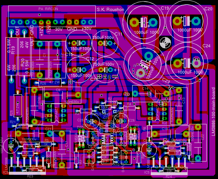

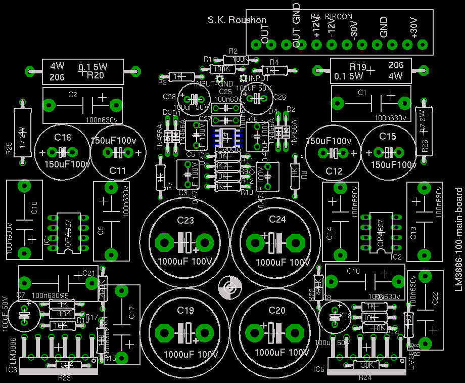

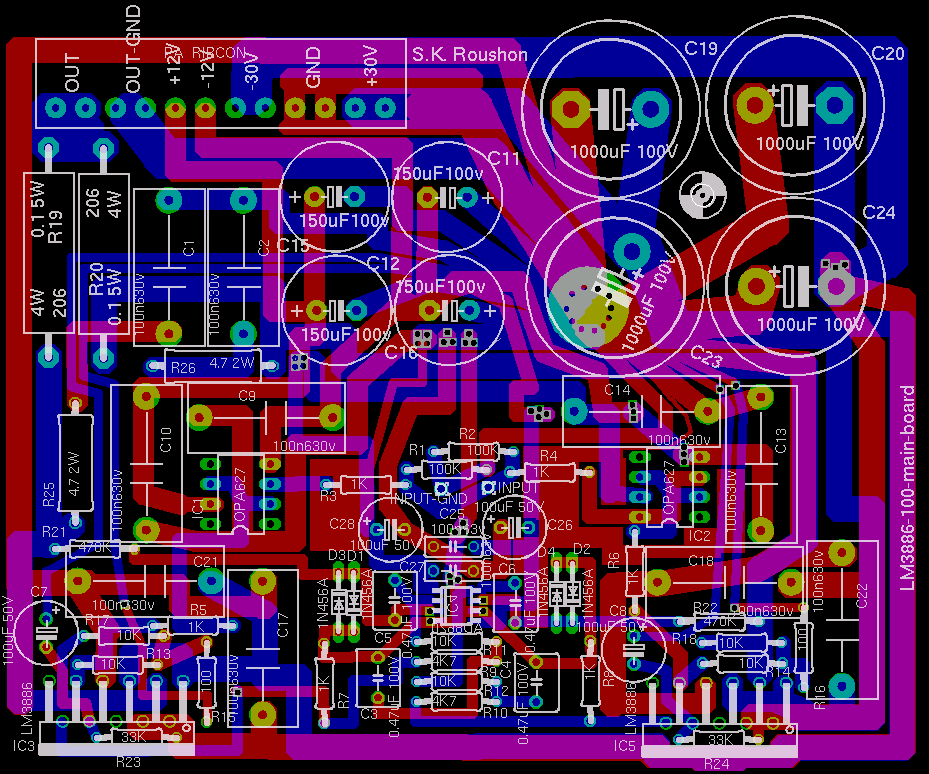

PCB design of parallel of two inverted LM3886 with buffer and dc-servo.
signal gnd and pth corrected
signal gnd now direct to star. less pth.
pouring copper
Is it safe to pour copper on the empty areas, connect them together without making any loop) and finally connecting it to the star ground by an independent path? In the above pcb I did a similar things, but not sure if it is OK.
I have filled all the empty areas by copper and connected them to the star ground through different path. Also as the output of the right side LM3886 is making a round on the board ( which is worrying me) I will attach a 220pf between the input pins (9 an 10) of LM3886 on the solder side and directly on the pins. That should take care of any unwanted signal.
Any suggestion....?
Thanks.

U need holes for mounting the PCB.
It is too much to go through but a noticeable problem is that the filter caps are too far from the LMs. Should be as close as possible. It would be better to swap placement of servo with the filter caps.
Gajanan Phadte
Gajanan Phadte
I will attach some small caps directly on the pins of LMs. That should solve the problem,..I dont know. Otherwise I have to start from the scratch......thanks for your suggestions in any case.
