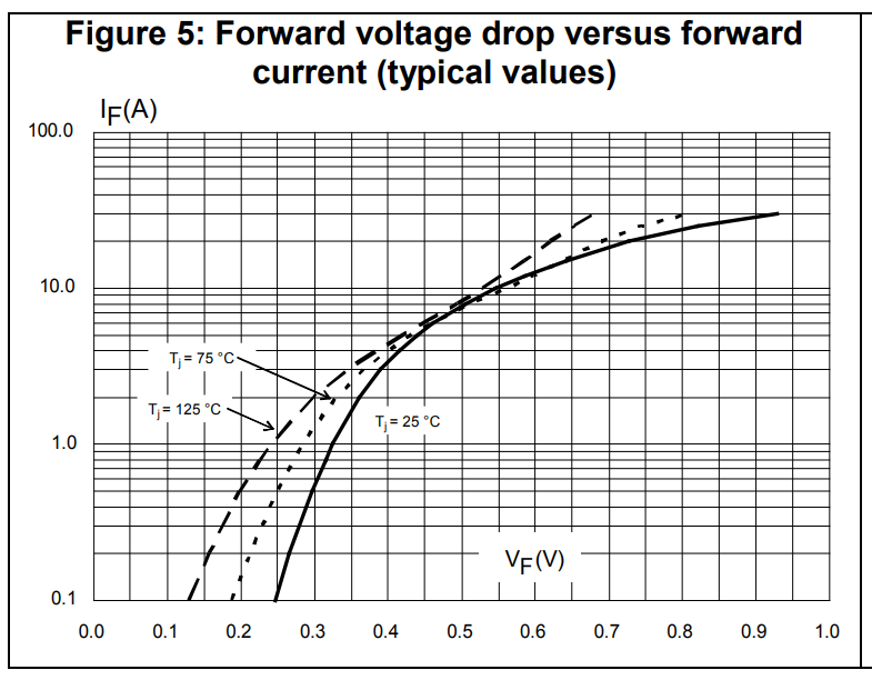

- It has footprints for three-leged TO-247 or TO-220 diodes with pinout A-K-A. This gives you the option to install the fancy new "Field Effect Rectifier Diodes" from ST Microelectronics. A good choice would be the FERD30H100 diode, whose Mouser part number is 511-FERD30H100STS. This FERD has extremely low forward voltage drop, see datasheet Figure 5. Admittedly it's a "slow" diode (reverse recovery time is a microsecond, not 75 nanoseconds), but that doesn't matter if you're using a C+RC transformer snubber with damping zeta=1. As you surely will be after consulting Quasimodo test results.
- The low forward voltage drop of a FERD (or a Schottky) means the diodes will dissipate less power (P = V * I) and produce less heat. That's valuable when trying to run three amp channels out of the same box, without cooking the electrolytic filter caps and other heat sensitive parts.
