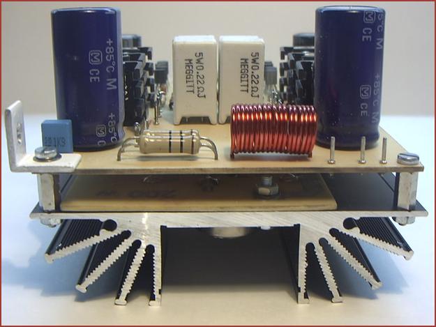

The real dimensions of the PCB, they are 140x96 for the part of control and 276x68, for the part of the end.

Photos the 400w.

Photos the 200 w.

I think that will not be warmed up, to see the photo.

is it me or did you put the tip41 and tip42 wrong? base is placed where the emitter is supposed to be... ¿? the amplifier would work great with an oscilloscope as a heavy load...

to see if this scheme is the correct one, warm greetings.
: Confused:: Confused:¿your build?: Confused:: Confused:
