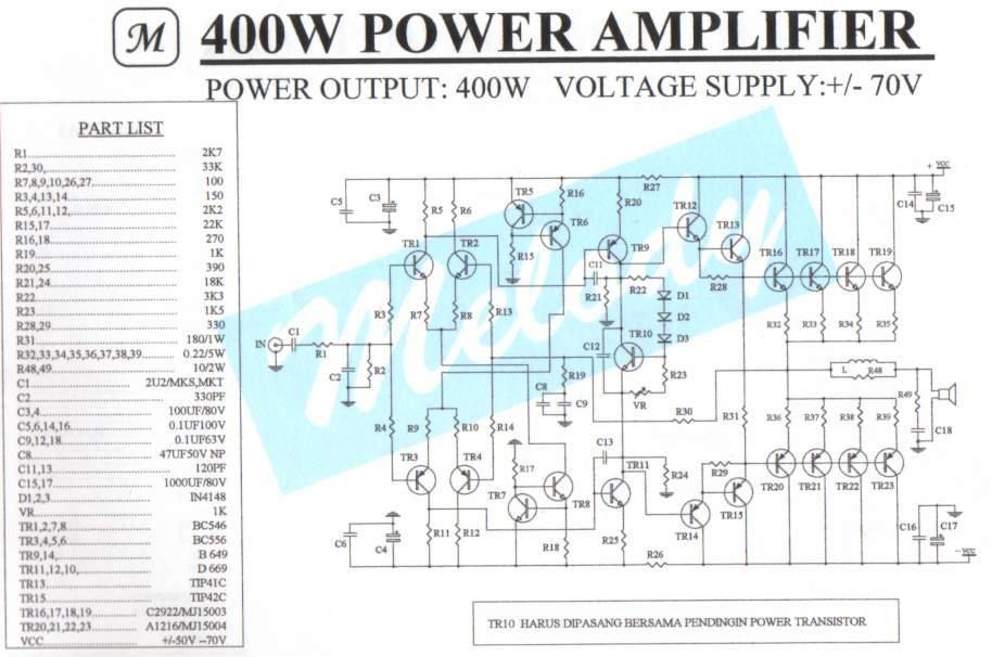

to see if this scheme is the correct one, warm greetings.
ACD said:Three pairs of output devices are still not enough to safely handle 280/350W at a 45 degree phase angle
PL400-II (almost the same schematic) used 3 pairs of MJ15024 at 80V rails!

The Phase Linear 400-II are notorius known for their weak output circuit.......
I have personally repaired/replaced output devices on app. 20 different PL400's over the year, even though the PL400 never was very popular in little Denmark and I have never worked at an official PL workshop

Not having touched one before, was the heatsinking adequate? Didnt Bob carver use a 125v mains cap with 130v supply in one design?
Heatsinking was ok I think ...
However I never actually measure the temperature
Bob Carver did made some strange choices in his desig, however so did many others....
Remember the Onkyo M504 ?? Output caps did go all the time, even though it was a good amp
Just because it was a commercial amp, doesn't make the circuit right.... That's why we make DIY

fjromero said:
fjromero
Yes, look very good schematic circuit!
No problems use MJ15003 / MJ15004 with TO3 package. Very good!
MJ15003-4 has been used many, many times before.
In good hifi power amplifiers by good professional audio designers.
....but
lineup, me personal, thinks
MJ15024 and MJ15025 .... a little bit better ....

Lineup, whats your pref with going with 15024/25 over the MJ21193/4/5/6?
I have used the 15024/25 and did not like the sound in a couple of designs/ The 15003/4 sounded better in the same circuit.
Krell used (I think) the 15024/25 in the KSA-250 and I found the same edgy steely sound in that too... Dan D then had MOT design newer TO-3's which then spawned the MJ21193/4/5/6. That sound better.

K-amps said:Lineup, whats your pref with going with 15024/25 over the MJ21193/4/5/6?
I did say I prefer MJ15024 / MJ15025 over MJ15003 / MJ15004.
I did NOT include MJ21194/3 in this compare.
I said this with the following reason in mind:

If somebody can find MJ15003-4, it is a fair chance they also can get MJ15024-5.
This is the choice most people of the world have, if even there is such a choice.
