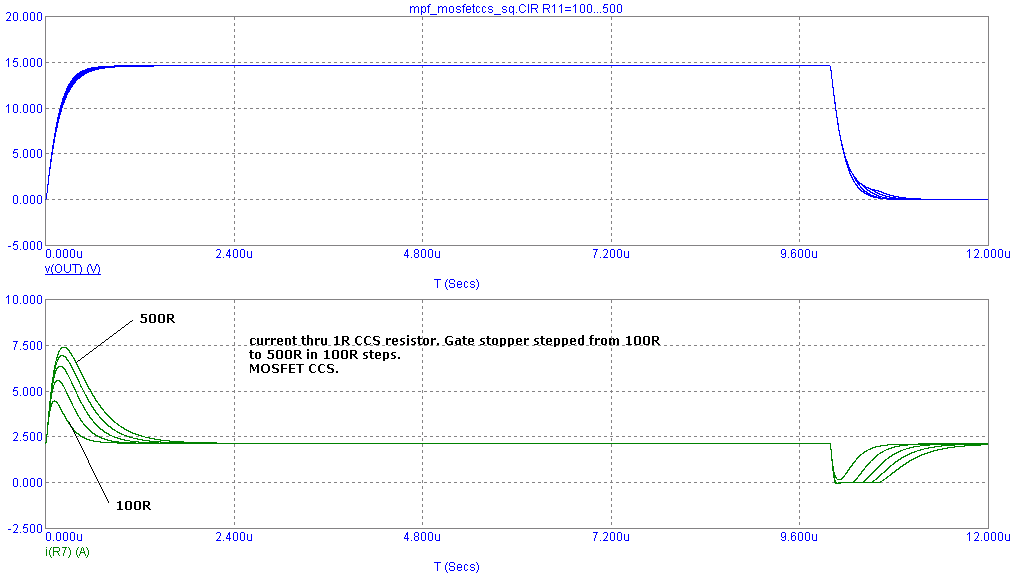

Gate stoppers don´t cause spikes.OK guys, here is my reply why not to use MOSFET CCS.

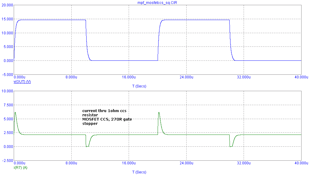

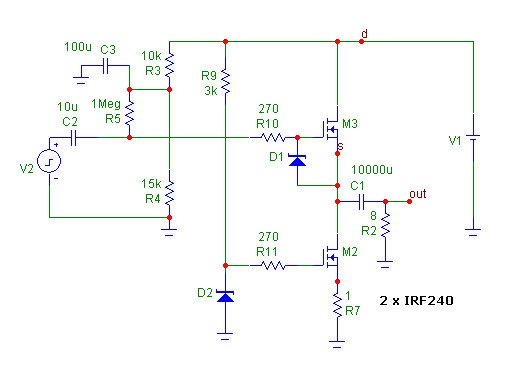

Lumba Ogir - would you show your results? Simulated or better measured? The stoppers increase gate charge storage issue.

you have a particularly idiotic simulation program.
Definitely. Any professional comment?
BTW, this was the analyzed circuit, R11 stepped.
That's odd..... I have used n channel mosfets in SE amps for years, and no spikes, no problems, no RF. Gate stoppers are 220R, current is 1.45A, Vds is 25V.
I daresay if the input is a square wave with very sharp rise times, it might cause a small but temporary hiccup in the current, but nothing more...... this is acceptable.

I do not want to persuade anyone. Please anyone who likes it, feel free to use the MOSFET CCS in the Power Follower. To me, such transient behaviour is unacceptable.
What the simulation program predicts is quite true, but both for MOSFET and for bipolar transistors, although those old 200V MOSFET have quite high "miller" capacitance, particularly in comparison with bipolar transistors. I don't know why they are so appreciated for audio. MOSFET miller capacitances are strongly non linear, 300pF at 10V d-s, <100pf at 30V d-s, they are nice "harmonic spray" generators.
In the end a good layout is required in order to be able to use a low value gate resistor without oscillation problems and get "current source" behaviour up to high frequencies. Stability and performance have to be tuned with oscilloscope and signal generator. The bigger the capacitances, the better tha layout has to be.
Anyway, 2.4us settling time is very good for something that is not expected to operate above 20khz.

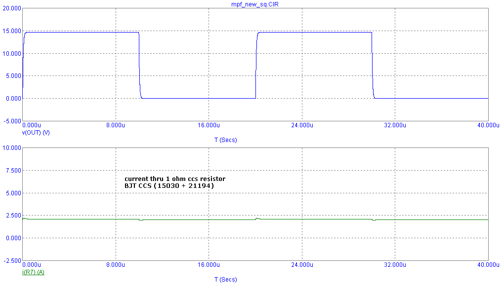

Well said, Eva. Anyway, there is much less transient load effect in the CCS built with MJE15030+MJL21194, compared to that built with IRF240.

- Pavel's MOSFET Follower - No Darlington Mod
