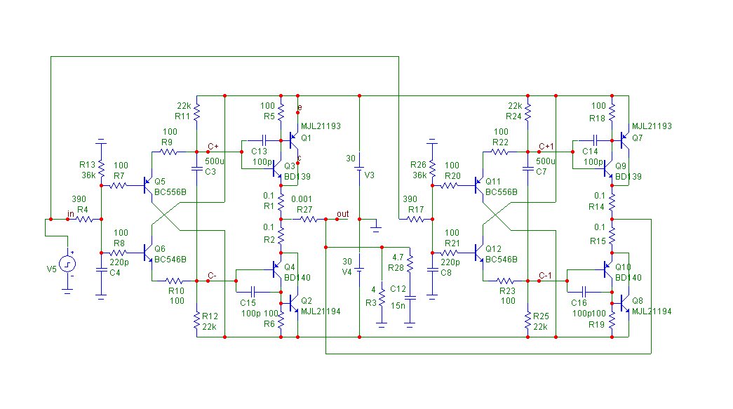

back to the follower, everything depends on your load resistance, and how much power do you (and your MOSFETs+heatsinks) agree to dissipate.
Say, you have 8 Ohm load, and can't tolerate more than 100W on both transistors (or they can't tolerate more).
The current source have to provide current no less than peak current on your load (speaker). If it's impedance is 8 Ohm, 50W dissipation means idle current no less than square root from 50/8. Now, you can calculate a voltage of the supply dividing 100W on idle current.
Got it?

Dear Shaan;
Got it?
The follower's idle current is 2.25A. Max voltage is 40V. Dissipation should be 90Watts(45w per device, DoZ pre used to divide voltage into halves at output.). Looks like it is 90watts. The small heatsink needs a fan to remain touchable. Load impedance indeed is 8ohm. So I think I got it. Please don't ask me to go deeper coz I am not in the mood and ain't so bright. 😀
But the follower didn't ever have a problem with dissipation and still doesn't. I know how to calculate max idle current based on load R. I have no problem with that part of the theory, and unlike the oscillation problem it really reflected into the real world too. Lower supply causes earlier clip; not some problem.
thanks for your concern.
