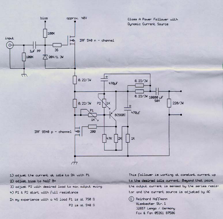

For me the most interesting version is those with BjT PNP boosting (Sziklai darlington - Ladislav Bunta's advanced circuit) - go therefore to
ImageShack® - Online Photo and Video Hosting
diyAudio
check also my post 924 and associated about follow link:
http://www.diyaudio.com/forums/pass-labs/66822-sewa-seven-watt-amplifier-93.html
To get Aleph emitter follower one must implement additional devices according the second picture (German version).
diyAudio
For me the most interesting version is those with BjT PNP boosting]

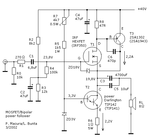

with regards Pavel's circuit:
Given that the Darlington has much higher transconductance than the FET it should have less distortion ? in other words, use the FET as the current sink and the Darlington as the Follower ?

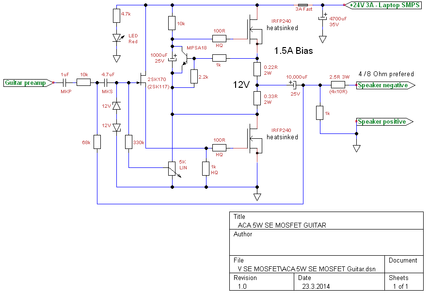

Guitar Amp
If you want great low power guitar power amplifier, look at my slightly modded ACA (Amp Camp Amp by Nelson Pass).
bump...
What is the advantage of the Sziklai variation?
Better for clean or the guitar option?
I think I have some of the '1302's, some power Darlington's but the only megamosfets I have right now are some 47N something monsters.
Does the Sziklai pair option make MOSFET choice more flexible?

If it's for guitar, then the clipping behavour and sound, while clipping, are most important imo. That's why tube amps always sound better with guitars.

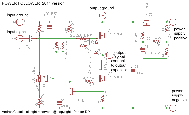

Hey Lineup, great to see you back!
Don't forget Ciuffoli's classic (w new PCB):
the Power Folllower
( virtual gnd; 'batt supply')
Re, vis a vis
Power follower 99c Vs Zen
Pavel Macura's MOSFET Power Follower
Cheers Lineup
- Pavel Macura's MOSFET Power Follower
