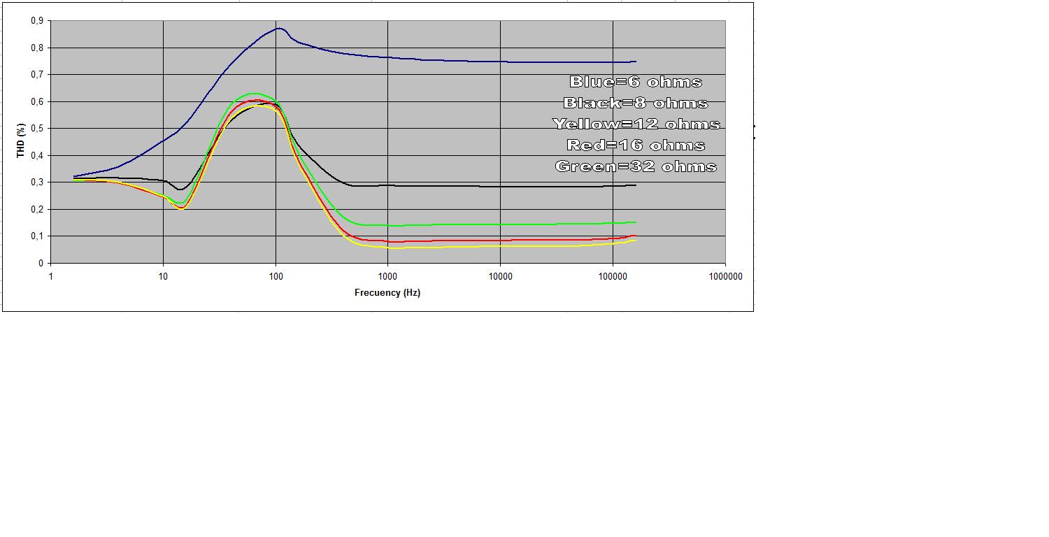

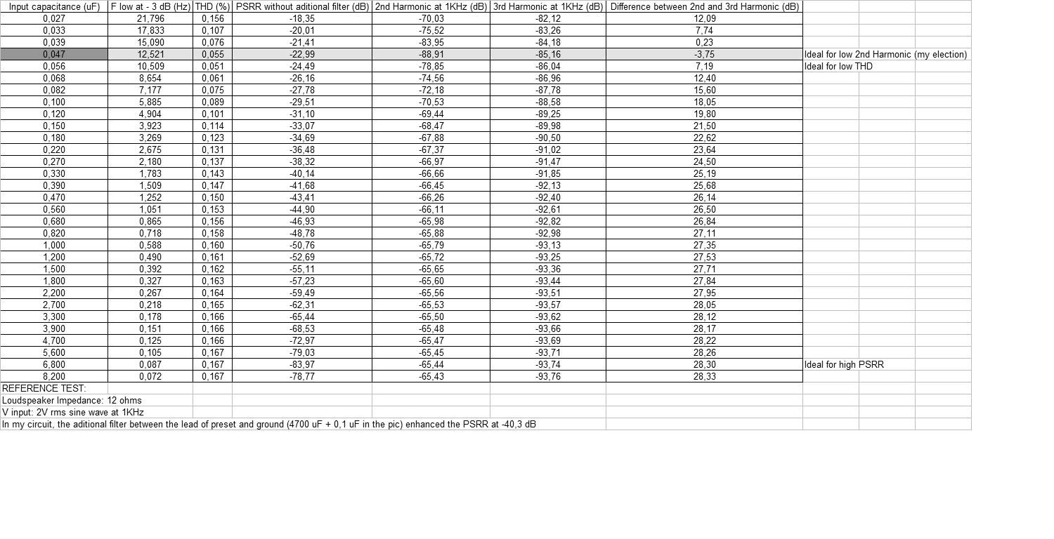

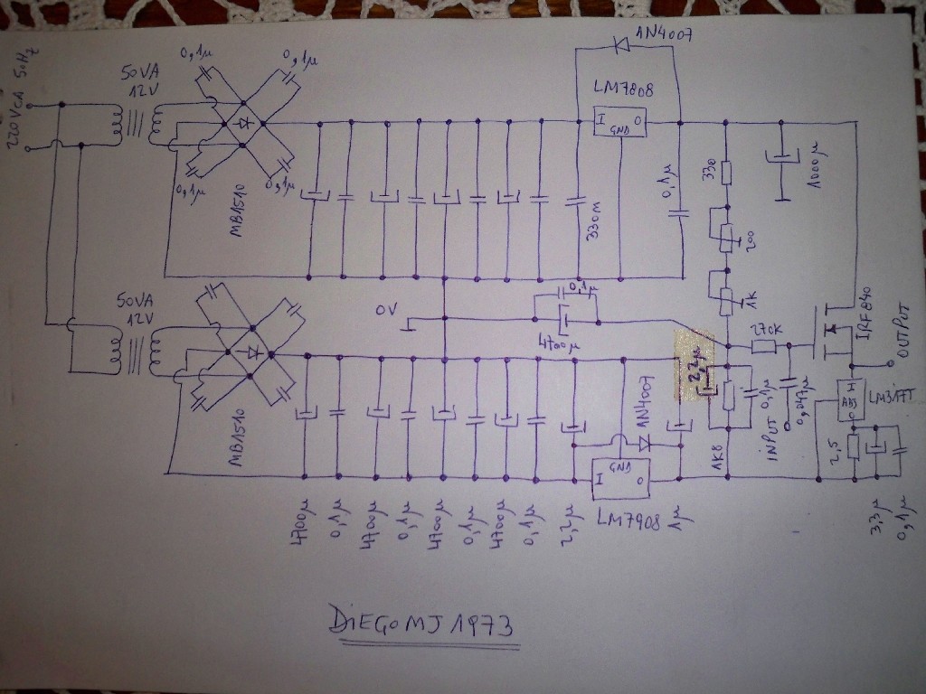

Hi all!
It´s my design of mosfet follower. Runs in pure class A. Direct coupled in the output. I use it with my CD player without any preamplifier. The sound with my two way loudspeaker is wonderful.
Here are some data of simulation
Greettings
