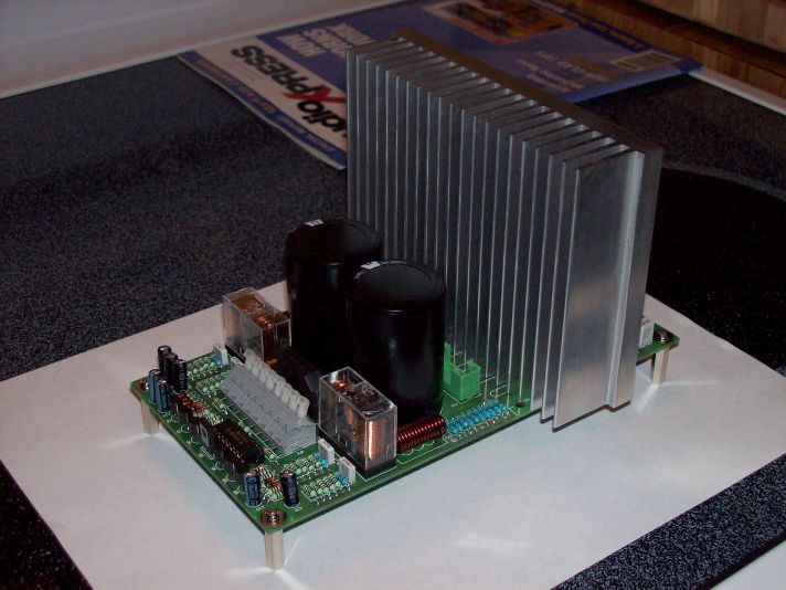

Another PA03 finished.
Pavel,
Finally got my amplifier together and I cannot say enough good things about it. It sounds INCREDIBLE!! Thank you very much!
I will comment more when I get it in a permanent enclosure and test it with some good speakers.
I ran it for a little more than an hour last night and the heat sink was barely warm.
If anyone is thinking of building one,go for it. You won't be disappointed.
Here are a few pictures of it. I will post more when I get it in it's enclosure. Thanks again.
-claiborne
