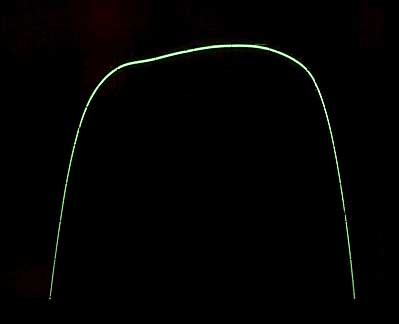

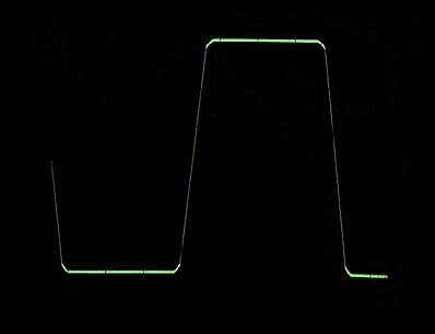

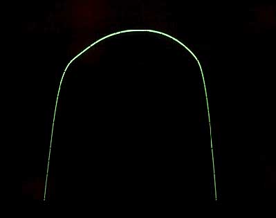

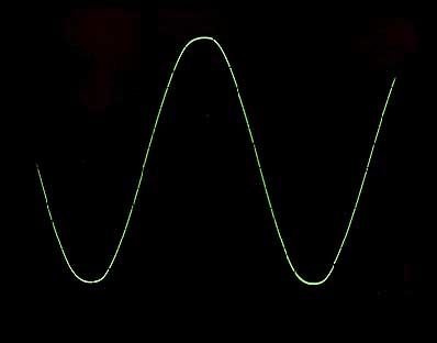

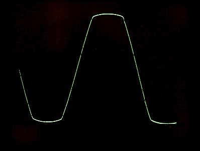

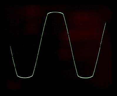

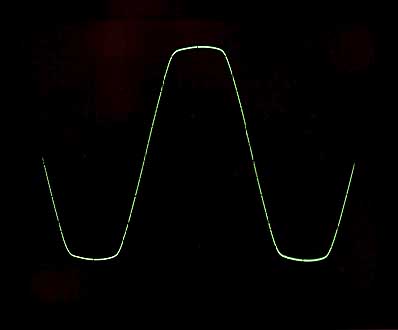

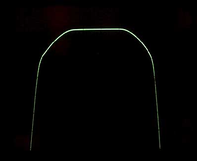

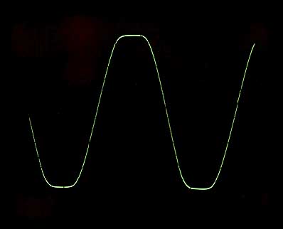

1 dB overload, 100 kHz...

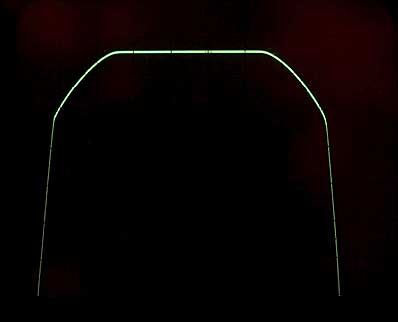

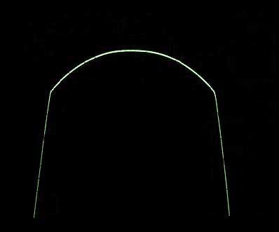

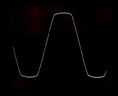

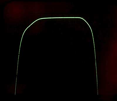

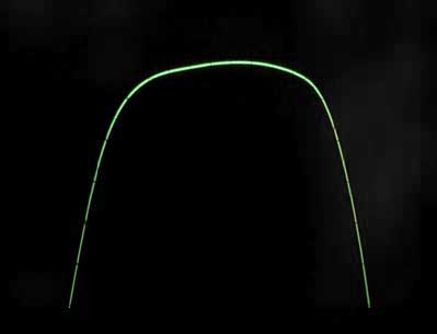

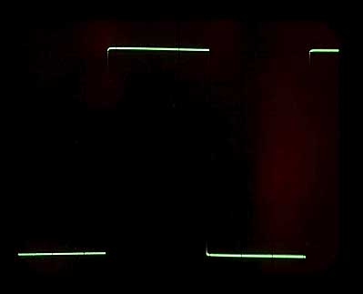

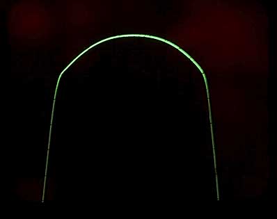

Answer to questions : Antisaturation diode is in this case BAV 21. Bias current is 250 mA.
In all my amps I'm using antisaturation circuit at VAS. This really simply connection ( only two diodes in each polarity ) create switch amplification of VAS to low gain when output voltage is near limitacion. If this stage have low gain, junctions aren't saturated and amps have much more better behaviour in clipping ( much shorter recovery time ).
Personally I highly recomment to use this circuit to Krell's and Leach's builders - pics tell more...
At pic is switch to lower gain ( by 1 kHz )...
