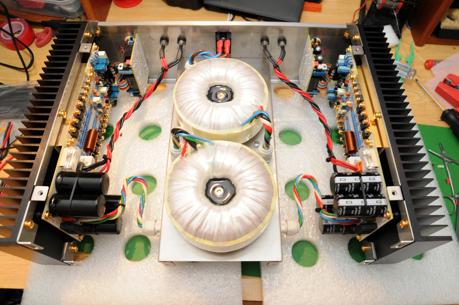

Pavel, very nice work 😎............puts most audio manufacturer's product to shame. You shold be in the chassis/kit business.

I have no idea how your amplifier sounds, but the construction is nothing short of ART! Incredible quality throughout in the design and construction. Bravo!

After you had the finished schematic how long did it take to assemble these nice amplifiers. Just acquiring all of the parts would take a few months.
Are those boards etched or machine routed? To have a set of boards with those dimensions produced at a fab house would be quite expensive.
I hope you do not stay away so long next time. We diy types get a great deal of inspiration from seeing what our projects could turn out like if we get at it.

The boards are not made at home! The big mother board costs quite much but are more order were are talking about 15-20 dollars or less.
If I built these amplifiers it would take me one evening per pcb. What is time consuming is to gathering all parts.

It's funny, how many people have noticed "peasant" cable ties (on electrolytics) on this splendid "regal" design.
Looking at pic. in post 40, I see the transistors leads are bent very cose to their cases.
I hope that was done according to the manufacturer specifications/requirements (stress/integrity issue). Do you see any benefit in routing and soldering them under the board?
Altogether, it is very impressive design.
Transistors leads are bent by maximal radius ( I am using 8 mm drill for TO220 and 7 mm for TO126 ). I am using for it only own hands, any pincers...great radius is much more friendly to the leads....😎

Extending the PCB over the heatsink mounted devices as shown in this post http://www.diyaudio.com/forums/showthread.php?p=1940001 is not the best practice. Due to the high dissipation in the power devices, the PCB (in particular if it has a ground plane) will get pretty hot and, sooner or later, all kind of very hard to debug issues may occur (starting with drying out electrolytics, in particular 85 degs types, and ending with soldering cracks because of the high thermal stress). As much as possible, the PCB should stay off from the top of the power devices like here http://www.diyaudio.com/forums/showthread.php?p=1883792 or, even better, here: http://www.diyaudio.com/forums/showthread.php?p=1866841 , this may provide (according to my measurements) 5-10 degs less at the board level , which could make a significant difference in time.

You are right if the amp would do heavy duty service but at home I think this is a rather good solution and since I have worked with industrial power electronics I don't fear high temperatures any more. 60-70 deg C is nothingBased on my own experience, one suggestion for a future project/layout:
syn08, I think your complaints are based on theory and not real life. Electronics feel better if they run cool but how good is the lifetime for Pavel's amps? Pretty good I think.
Scuse me for bugging in, but Pavels use of stand-0ff blocks for the power devices enables him to mount the boards at a larger distance to the heatsinks.
Airflow between PCB and heatsink should ample protect the components against overheating, especially if the chimney has such a width.

Assuming a 60-70 deg C in the proximity of the case of the power devices is totally unrealistic. I have measured these temperatures, and your assumption means that the heatsink itself would stay at max. 50-60 deg. C.
A class AB amp of 100W/8ohm would have a maximum dissipation (worst case, at 64% output swing) of about 82W. This is really a theoretical value, because it does not take into consideration the supply voltage overhead and the bias power (and you like it hot, isn't it 🙂 ) In the real life this is never under, say, 100W.
Now, assume the best plastic case power devices; they have a Rth of 0.54 deg/W Also assuming the heatsink has 0.5 deg/W (optimistic, what's in the pictures looks more like 0.8 deg/W) and 0.5 deg/W for the mounting (again optimistic) gives a total Rth between the junction and the HS of 1.54 deg/W./ Now, assume you are using 2 pairs of power devices (common for 100W) a quick calculation gives the HS at 50 deg over ambient, the device case at 62.5 over ambient and the device junction at 75 deg over ambient. Take the ambient temperature as 25 deg and do the math. The HS is at 75 deg, the case is at 82.5 deg and the board will be at minimum 75 deg.
This is for only 100W/8ohm, without even considering real load impedances! I'll let other decide if this is acceptable for them, I would personally not even think about running a la longue 85 deg electrolytics at 75 degs, without any margin (in particular about the ambient temperature value). In this particular case, I would either consider a 10% safety margin or, as I am currently doing, provide temperature triggered forced cooling. I set my sensors at 85 degrees for the HS temperature and a microcontroller is taking care of the rest.
