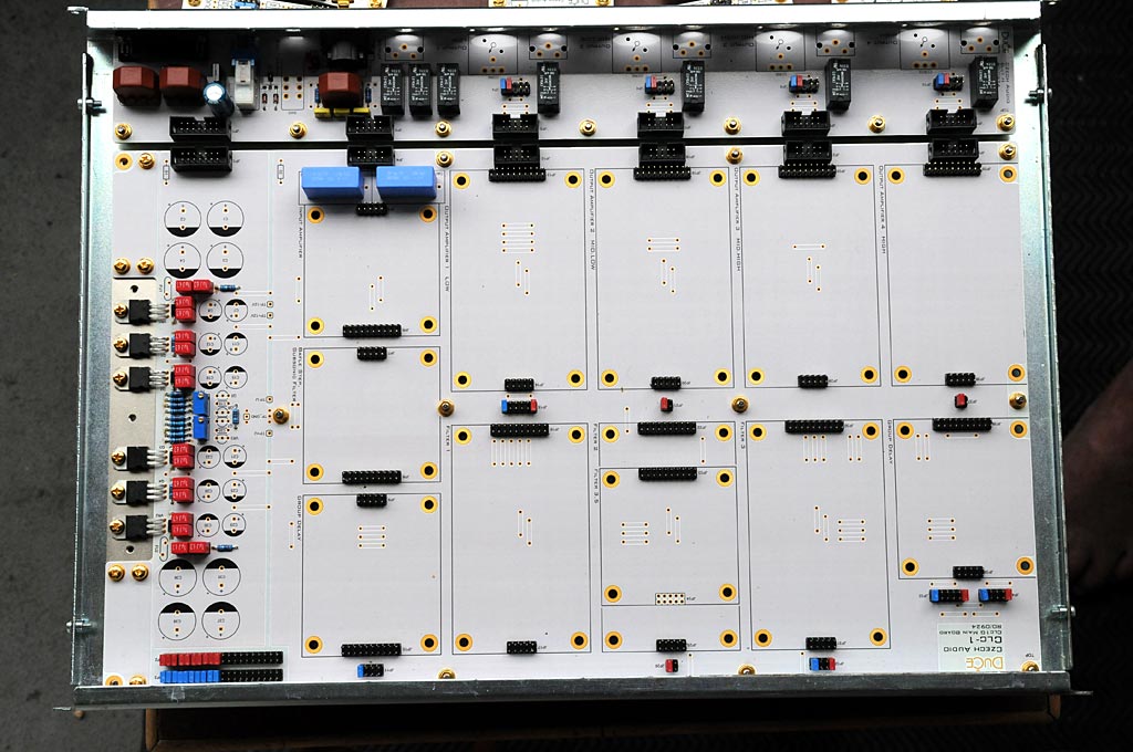

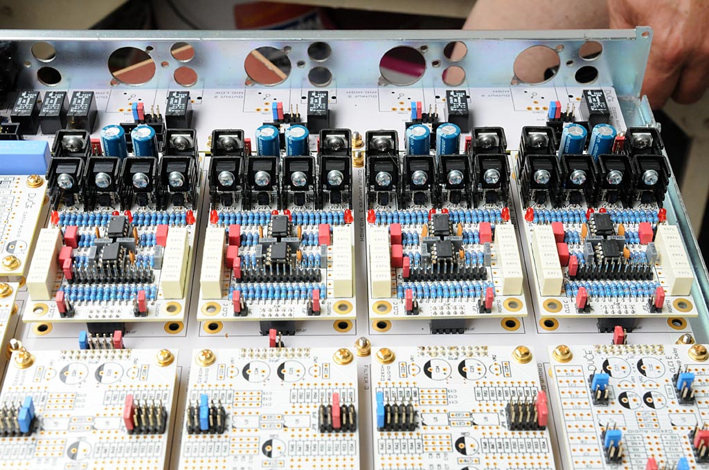

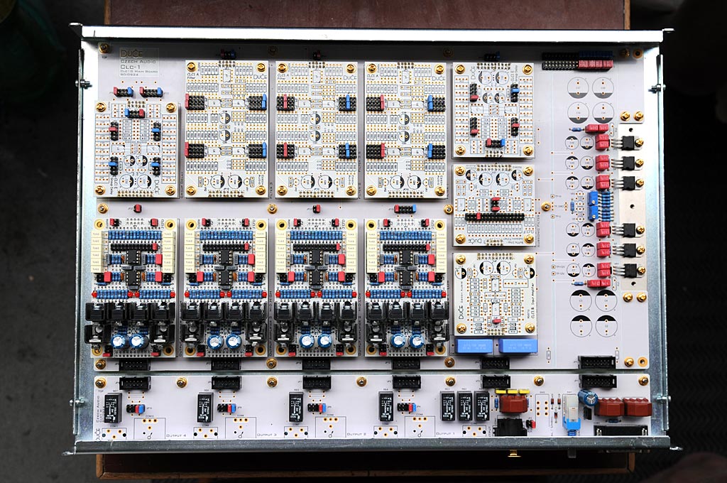

Another project of last years is CLC1 ( CompromiseLessCrossover 😎 ), which is universal analog crossover, 2-4 way, in modular conception, 24 dB/oct in state variable principle, but it is not still ready... 🙂
Case
Case is standard 3U one from Modushop, but my some parts are custom made from brushed stainless steel, cut by laser. Rear panel is overwrite by laser and coated against fingerprints...

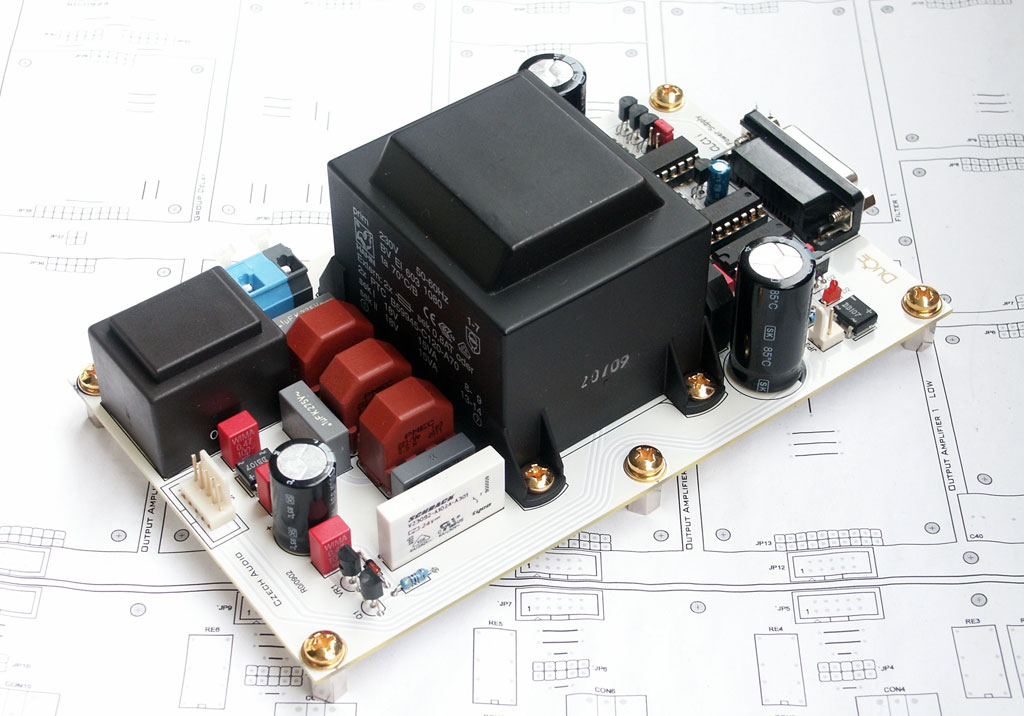

Every my amp ( and crossover too ) you can remote from preamp. By multiamping they are switch on in turn ( for better inrush distribution ). Remote chain is galvanic separated ( no ground loop )....
Real panel...

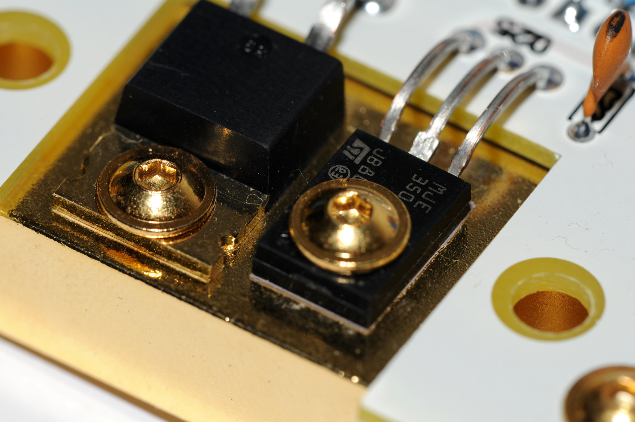

I like sound of well made mosfet amps and this love lasts from the time, when I heard first EBs Hafler 280... 😎
I had build many types of mosfet amps ( Borbelly and Hawksford/Cordell ones with error correction - they are my perfection 😎 )...
Type at pics is my basic one ( designed in 96 ). Look at precize work of my friend Filip Honzarek... 😎
