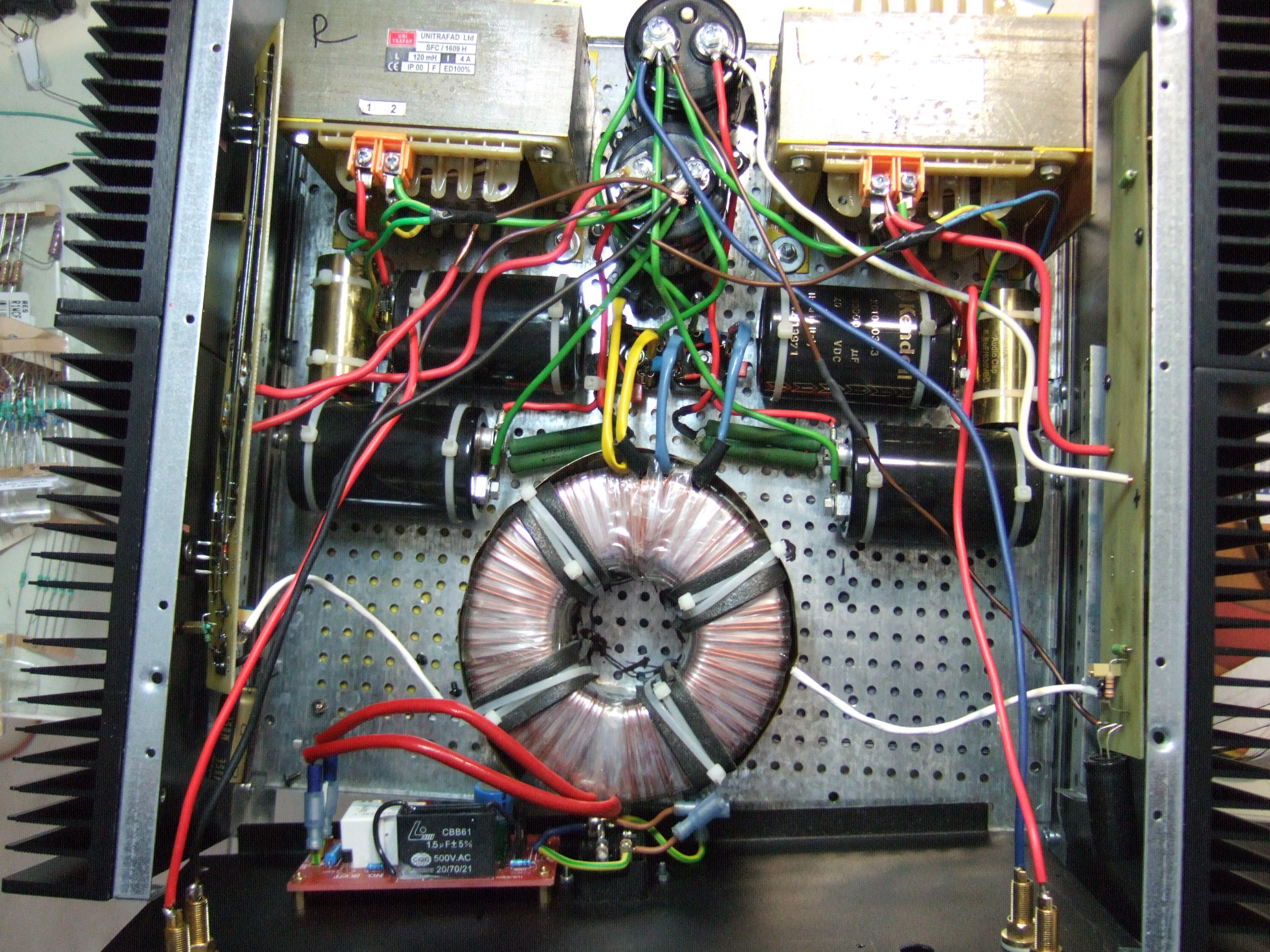

Here is some pics from my Pathos

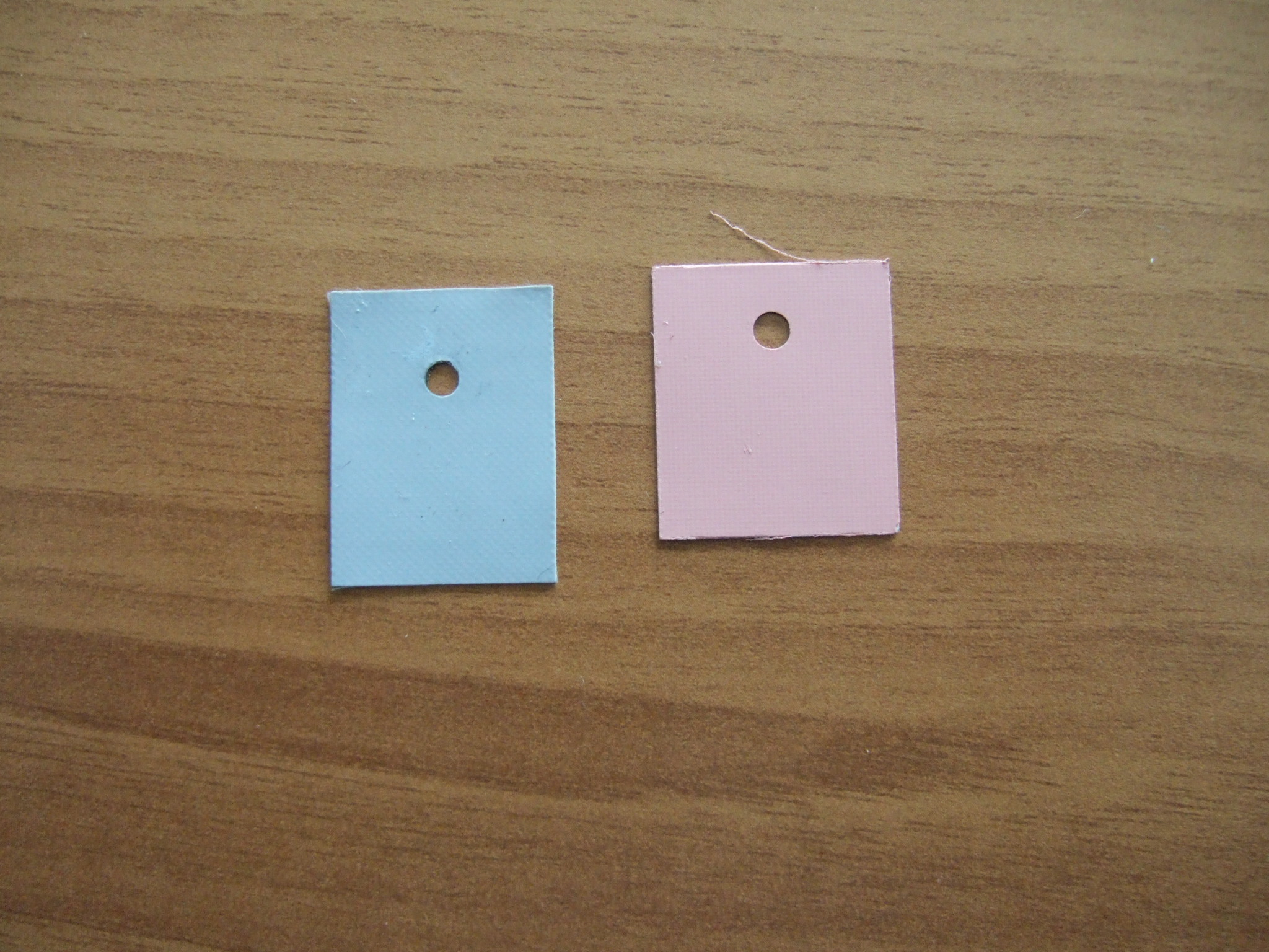

Hi Apolon34,
If you use irfp240 use one pair 15V zeners from gate to source common for all mosfets. R13 - 270k in service manual should be around 130k. Unplug preamplifier section from amplifier section. The mosfets should be very very tight connected with heatsink. Use pink pads like this on the picture not grey. With grey pads the temp over middle leg close to the case of the mosfets go over 100'C. Adjust voltage over choke to be 2.5V not more because at start with preamplifier section connected the voltage over choke will go to 5V !!!! for short. Otherwise you should build this section from service manual with delay relay.
I already noted the gate drive voltage rising at preamp start-up. I corrected the problem a bit by reducing the impedance of the resistor bridge that set-up the idle current. Bump is now much smaller.
I also now use a startup sequence controlled by a uC. Tube heating on for about 1 minute, then H.T then 10 seconds later the +38v for the mosfets.
I did effectively use the grey pads with thermal paste. I don't think using blue or red ones can alone solve all the problems of the amplifier, but maybe I'm wrong.
