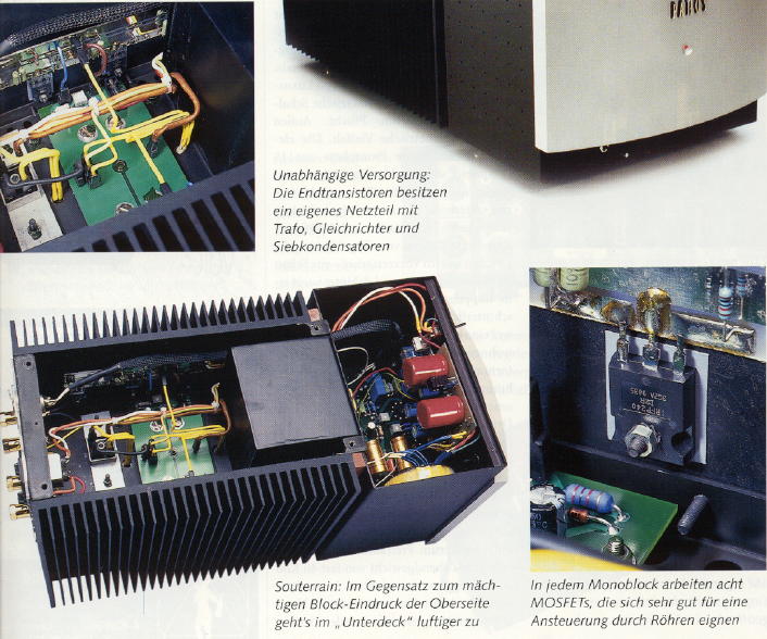

I know the thread is dead, but thought I'd add to the archive. Repaired a Pathos InPower this week. Basically a differental tube front driving a bridged version of the TwinTower amp. The output inductor for each side of the amp is 120mh 1 ohm DCR. There is 3.25 volts on top of it and the sources ( 4 IRFP240 per channel w/.22r between each source and topside of the inductor)
Hey that's 3.25 amps per side (it is a bridge).
It's also direct coupled ! Each side has the 3.25v to ground but nulls across a load, kinda funky. Runs hot as blazes. They also have a choke input supply for the output stage, 30mh 0.4 ohm between bridge and supply caps. Much prettier outside than inside :)
Here's the pic of InPower amp.
One side of one amp died. Gate diodes shorted
and 2 fets were 'open'. Really odd. I suspect since the owner had Quad 63 monitors, the crowbar protection did a number on the amp. There is that potential 3v dc on each side, if you have one speaker lead connected and the other sees the chassis, accidentially, the triac may sense impending doom and shut the dooe :) Just a guess, as we know all audiophiles power down their amps before changing connections, right? :clown:
