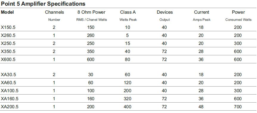

Comparison, I know these are the .5 specs but here also the X160.5 and 600.5 share the same hardware, weight, idling etc..:
https://www.diyaudio.com/forums/attachment.php?attachmentid=994248&stc=1&d=1635774341

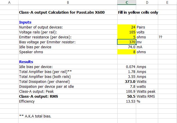

> The XA160 can produce 160 Watts RMS of Class A power and the X600 "only" 40 Watts.
> Is the increased railvoltage to get 600 Watts out of this amp at 8 Ohms responsible solely for the diminished Class A portion?
You already answered your own questions.
Assuming your numbers are correct, and they refer to 8R load.
160W rms into 8R means +/-51V output, and ~56V rails.
Class A bias at 0.5*I max = 3.2A.
Total dissipation = 360W per amplifier only
600W rms into 8R means +/-98V output, and ~105V rails.
For the same dissipation, I_bias = 1.7A.
So Class A power (limited by I_bias) is 46W.
So pretty close to the numbers you quoted.
Patrick

Anyone who went through the process of designing Class A and Class AB would know straight away.
Patrick
Patrick
I apparently didn't 😛, but I've could have used my Class A calculator ...
What about that quirk that the XA160 can't deliver any power whatsoever over it's rated 160 Watts?

Can't reproduce it with the calculations I know.
Ohm's Law: Volt = Current times Resistance
and Power = Current(squared) times Resistance
Please elaborate.
