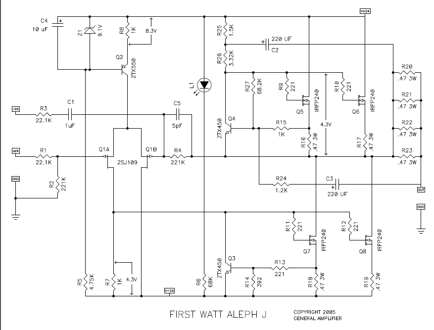

There is a schematic for the Alehp J amp.
Attached.
I can see I need to learn someting new how DC is avoided without a capacitor and without an OT.
Bipolar PSU. Big DC blocking caps are required in single-rail PSU.
Q5, Q6 and Q7, Q8 is not in a PP configuration?
Correct. Not Push-Pull. The top transistors are a Constant Current Source.
but you call this Single Ended?
Yes
So if I learn how this circuit is working it will be a big step forward.

What is the smallest SE amp to build without capacitors in the signal path (or at least without the big electrolytic in the output)?
Could that be the First Watt Aleph J ?
It looks relative simple. Are there PCBs made for these?
How low DC offset can you expect at the ouput without output capacitor?
Are they "self adjusting" or do you need to trim it to lowest value?

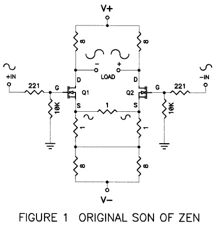

I’m not familiar with most of the Pass amps… how do you have an SE amp without either caps or transformers at the output?

The First watt Aleph J amp posted by 6L6 (schematic) seems to be without capacitors in the ouput?
go to first watt site , articles page , download them all and read

Read first watt F2 and F2J, from Firstwatt site. Well quality of sound means different for different people or it is purely subjective.
If you are looking for SE design similar to 300B, which translates to SE( not push pull ) without feedback and simple , F1 and F2 are the way to go in my understanding. With tubes SE design you have to use a Transformer and with SS you need a capacitor to block DC. It is easy and cheaper to find a good capacitor than finding a perfect output transformer. Also have to remember more complex circuits will need more careful design and it is probably best done by a designer.

easy, look at son of zen, balanced, has dc on output, but equal on both sides, hence none
