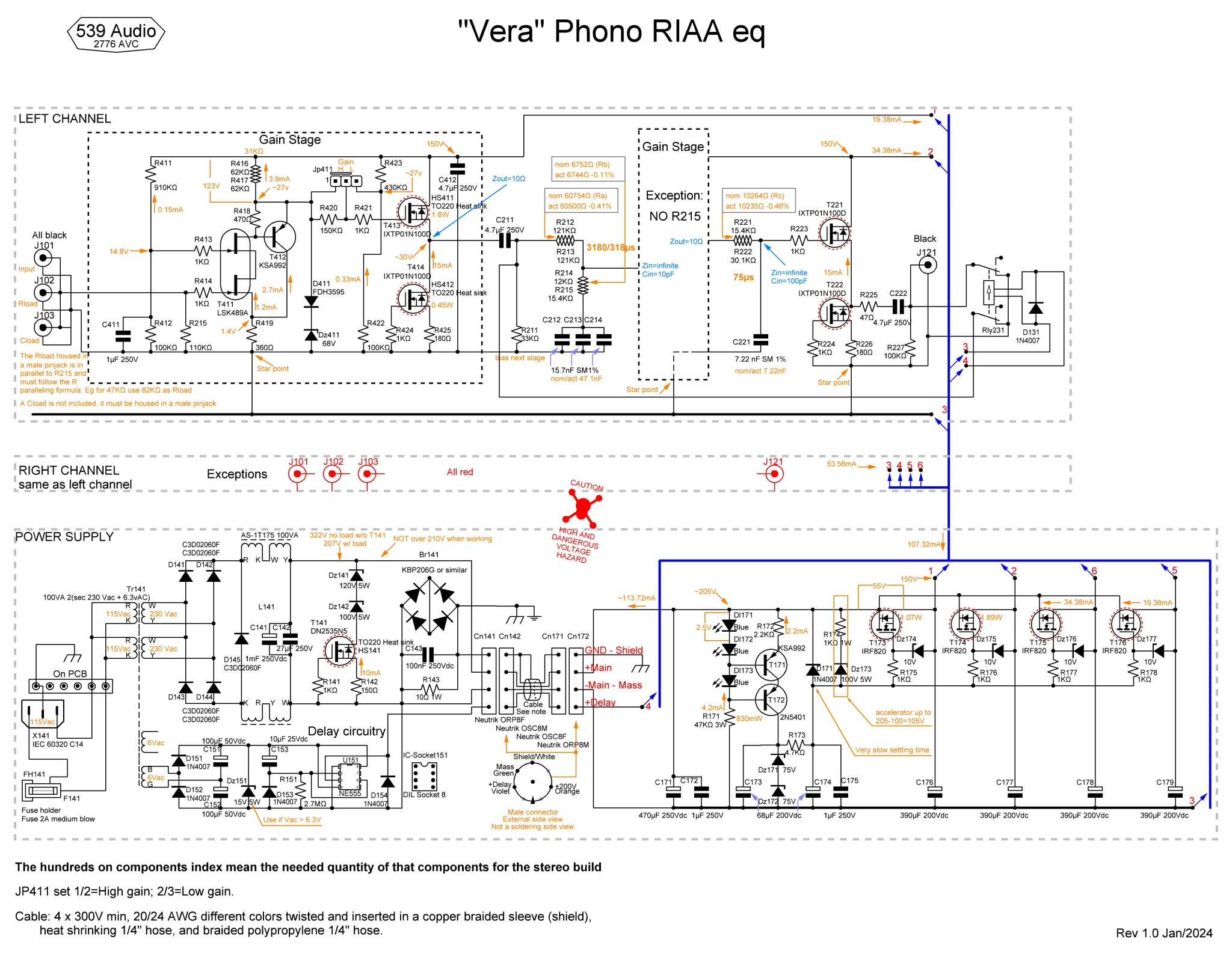

@MarcelvdG
I tried to understand, but I do not have enough skills to follow your calculations. So I understood the raw meaning of your thought, but no more than that.
I'm working on two passive split RIAA networks, and, contrary to the usual sequence, the 75µs follows the 318/3180µs network.
Both the gain stages driving one network each have a negligible Zout; pretend it to be around 10Ω, since it is driven by a buffer made out of a depletion mosfet IXTP01N100D served by a 15mA CCS (same mosfet). The mosfet shows a gm of 100mS in the worst case.
The Zin of the second stage is determined by the gate of a JFET (LSK489), which must be at 0V and needs a polarizing resistor lower than 150KΩ to prevent the JFET from oscillating. It is a bit more complex, but this is out of the scope of the speech.
For this reason, I chose a total R of around 100KΩ to polarize the gate, which is the sum of the RIAA resistor of 60KΩ, and 33KΩ right after the coupling C.
To determine the C I chose an Fc of 2Hz, low enough to prevent phase shifting at lower frequencies. So the C, with a 33KΩ resistor, comes out to be 2.2µF. The maximum Fc I could choose would have been 10Hz, but this does not work as a subsonic filter, so to stay as far as possible from phase shifting, I went for the 2Hz solution. If it makes sense to deal with phase shifting at so low frequencies. But even this one is another topic. Moreover, I will never use a subsonic filter made out of a feedback loop, so I renounced it.
I thought 2.2µF would have been a huge value to drive the 318/3180µs network. The 75µs network does not need to be decoupled, because it drives the output buffer which needs at its gate the same voltage as the source of the buffer driving the network.
But now you put the doubt in me, talking about a coupling C 100 times the RIAA C. Being not able to solve it myself, I'm asking you: please would you like to validate my values? I can fit (barely) a 4.7µF in place of the 2.2µF, just 100 times than the RIAA C. A bigger value would lead to a change brand of capacitors, but I like to use the ClarityCap CSA.
Thank you for your support!
For the split network, the equations get a lot simpler, so I didn't need my approximation.
The 75 us network is simple: just make the time constant 75 us. Still, the annotated resistance doesn't completely match the parallel resistance of the two resistors and the time constant appears to be a bit too small, but maybe you corrected for driving resistance and/or loading capacitance.
The zero with 318 us time constant just requires the product of the capacitance of C212...C214 and the resistance of the parallel connection of R214 and R215 to be 318 us, which it is within a few tenths of a percent.
The difficult part is the pole with 3.18 ms time constant. Due to the coupling capacitor and the rounding, its time constant is actually 3.0979127 ms (which is within 0.1 % from the time constant of the two capacitors in series with the resistors in between them, 3.100806942 ms).
You can get the pole at the right place by increasing the resistance of R212 in parallel with R213 by about 1783.59 ohm, such that (R212//R213) + (R214//R215) = 69027.5917 ohm.
Mind you, I have assumed 0 source and infinite load impedances everywhere.
See also the attachments.
As you can see in the spreadsheet, I've been tweaking the subsonic roll-off to keep R211 at 33 kohm; you could probably just solve the equations with the value of R211 as a constraint and only the 3.18 ms RIAA time constant as a constraint, but I've been too lazy to do so.

I think you overestimate the input capacitance of the T221 stage. If it had a loaded voltage gain of exactly 1, there would be no signal voltage across its gate-source capacitance (which is 98 pF typ. under datasheet conditions), so you would only see its (2 pF typ.) gate-drain capacitance. In reality, its gain is slightly less than 1, so you see the gate-drain capacitance plus a small fraction of the gate-source capacitance.
The calculations of post #7 only apply when C211 = 2.2 uF, but you can fill in other numbers in the spreadsheet of post #8.
My bad, it is a common drain connection. Approximating Cin at 10pF, taking into account some parasitic capacitance on the PCB, the new R is 10392Ω, given by R221=16900Ω||27000Ω=10394Ω +0.02%.
About C211: a bigger C does not represent a problem to the driving stage, and will improve the coupling to the following network, I modified the PCB drawing to fit the 4.7µF, which have at home.

Which EQ should go first in a split RIAA nework?
I came to the conclusion, that in an active circuit that is sensitive to overload, the 75 µs pole should go first. This cuts the treble boost that otherwise could overload the first stage. Example is a transistor or two-stage operational amplifier circuit.
On the other hand, where noise of the active stages is an issue, the 75 µs pole should go after the main amplification. This cuts the noise of all preceding stages. Example is a tube RIAA preamplifier, where there is ample overload margin.
You are right. My schematic should guarantee a good overload margin, and since one goal of mine is to hear the silence when I switch to the phone preamp, I chose the tube-like sequence.
There is a diatribe about this topic between Fulvio Chiappetta and Diego Nardi in some "Costruire HiFi" Italian magazine. Chiappetta designed a tube preamp with the usual sequence, while Nardi used the tube-sequence in his design. My preference is for this second one.
All values in the schematic came from calculations, they are starting-points and need to be validated while live.
Moreover, I wish to push the gain to use an MC cartridge. but I don't know if it will be possible. This is the reason for the high voltage, the attenuator, and the Sziklai solution to raise the LSK489 transconductance, which is low. I want the loadline of the cascode/Sziklai to be as horizontal as possible. I will try to play with both the Rs and Rd and see. I excluded the solution with the bootstrapped follower because could increase the criticality of the stage, which is already critical in itself.
You would need a smaller gate stopper at the input for MC, it's already on the high side for MM. Maybe a high-loss ferrite bead?
When C211 = 4.7 uF, the combined resistance of R212, R213, R214 and R215 should theoretically be 68206.68186 ohm, assuming the other capacitors stay as is. That's without correction for the buffer output resistance. Keeping R214 and R215 as is to keep the zero at the right place, the parallel value of R212 and R213 would become 61462.1563 ohm, or 61452.1563 ohm when you subtract 10 ohm for buffer output resistance.
