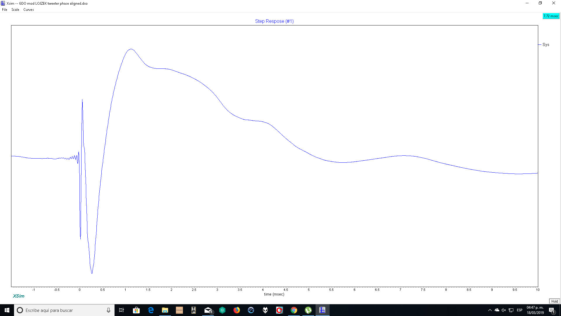

Please show us the step response. Unless you want to have some kind of vintage alike sound, phase aligned speaker is more versatile for many different kind of music including dense orchestral composition, in my experience.
Attached step response of simulation with Xsim all 3 drivers together.
