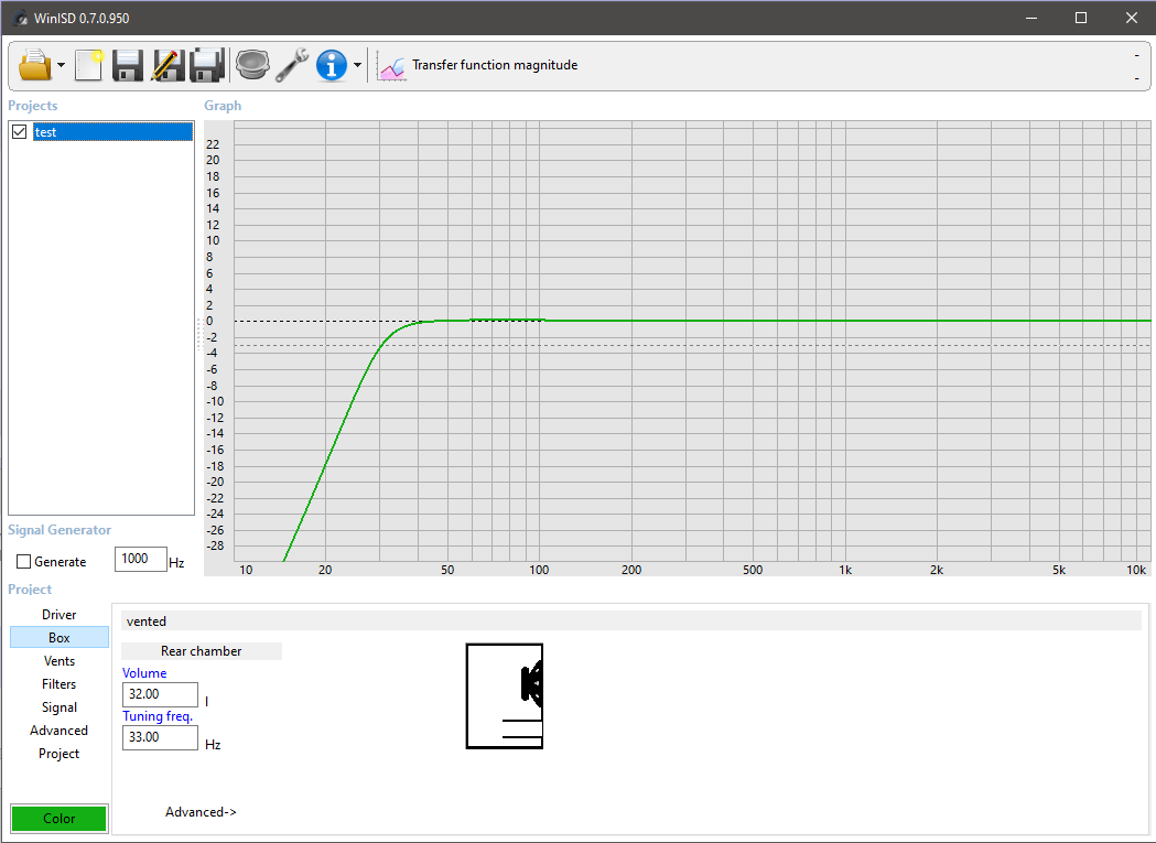

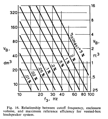

Hmm, 15.12" h x 9.84" w x 11.77" d = 1.013 ft^3/28.685 L gross x ~ 0.75 = ~0.76 ft^3/21.52 L net Vs Dayton RS180-4's ~21.2 L Vas = a near enough max flat sealed alignment/54 Hz Fc.
Per attached, ~20 L = 0.2% eff/30 Hz = ~85 dB Vs the woofer's mid band ~89 dB spl = ~ -4 dB/Fb, so can be a little more/less depending on how much net Vb available and not too much to boost from an SQ POV.

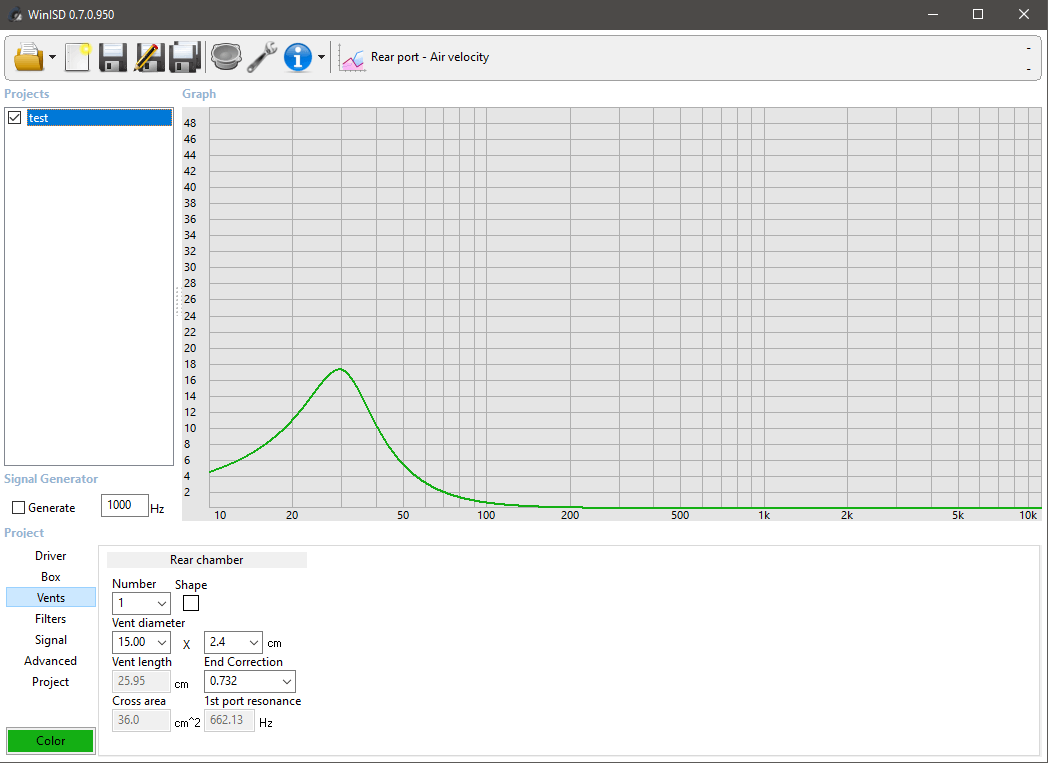

You can tune it a lot lower in a reflex, 30Hz is easely doable in a 32L reflex. If you would use a passive radiator you can probally make it smaller and go as low (but i don't like passive radiators). But I'm going 3 way with a planned build, that was delayed due to all kind of reasons...
This is just a very quick recreation of the sim in WinISD (i checked it in the original design in other sim software also with almost the same result) It won't go very loud off course (a 7" woofer is limited in that), but 100dB with one speaker (103dB for a pair) should be more than good enough for nearfield. Crossover will take some of that, but still good enough. The Epique won't do that on it's own.
But i will use a subwoofer, so i choose closed construction and cross arround 90 to 100Hz, and will make a sealed or a Ripole subwoofer for under my desk. I plan to use an SB26ADC tweeter, but the Seas mentioned above could also be used i think.
