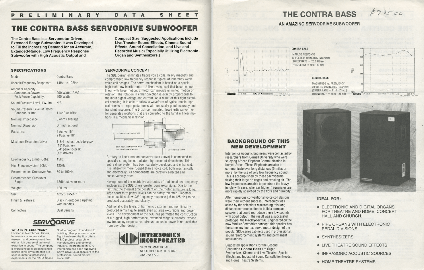

Thank you for that lead! I had never heard of Tom Danley's ServoDrive ContraBass subwoofers before. What an interesting bit of lateral thinking, and what an interesting product and history!...Tom Danley's[/URL] ContraBass project...
Today we have long-throw subwoofer drivers, but a good chunk of the voice coil winding remains out of the magnetic gap at any given time, lowering electrical efficiency. I wonder if Danley's approach (using a rotary motor) produced better efficiency.
To me, Danley's idea is still intriguing. Today we have cheap brushless motors, so there would be no brush wear and brush/commutator "stiction" to deal with.
Cheap "outrunner" brushless motors were made for RC models by the millions, until the bottom of the RC market fell out starting a few years ago. Their downside for this purpose, is the relatively high rotor moment of inertia, as the rotor has the largest diameter of any part of the motor, and carries a plethora of supermagnets glued to it. This high moment of inertia would not be good for high(ish) frequency response.
However, if the "gear ratio" in the Danley concept was stiffened up, so that the motor never made more than 1 turn, it seems to me that there would be no need for commutator, brushes, or a brushless motor configuration. Instead, like an old-fashioned moving-coil galvanometer, the current could be run to the coil via coil springs or flexible voice-coil lead wire, and the coil would simply pivot this way or that, driving the speaker cones with a suitable linkage.
But would this be any more efficient than a bog-standard voice coil moving axially in a magnetic gap? Are there any other engineering advantages to the Danley approach? I don't have a clear vision about any of that yet.

Gnobuddy,However, if the "gear ratio" in the Danley concept was stiffened up, so that the motor never made more than 1 turn, it seems to me that there would be no need for commutator, brushes, or a brushless motor configuration.
I don't think Tom's servo motors turned more than 360 degrees in any of the servo drive units.
The Contrabass specs out to about 91dB 1/w one meter, a better efficiency than a bog-standard voice coil on a 15" driver with two 18" passive radiators, but not much. The wear rate on the belt mechanism was problematic, and the servo motors which were in common use for computer tape drives (IIRC) became very much more expensive, while high excursion drivers became ubiquitous.But would this be any more efficient than a bog-standard voice coil moving axially in a magnetic gap? Are there any other engineering advantages to the Danley approach? I don't have a clear vision about any of that yet.
At any rate, the passive radiator approach really is king for small/low/loud, though does use some watts.
That said, a Sunfire probably can produce more 30 Hz than an Ampeg SVT with a sealed 8x10", and would use no more average power given the fundamental/harmonic ratio of bass guitar.
A combination of something like the Sunfire with an 8" or 10" for 60-80 Hz up could be done in under 2 cubic foot.

Thanks for that, it was hard to tell from what little information is still on the 'Web.Gnobuddy,
My thought was, increase motor torque, decrease number of degrees of rotation. If the motor was designed with a coil that only pivoted back and forth through maybe 10 - 15 degrees, there would be no need for a belt, or brushes, or commutators. Instead, just slap a short lever on the coil, with a pushrod driving the speaker cone, like the setup James Watt invented to turn the motion of his steam engine pistons into rotary motion.
(Only in reverse, as this would be used to convert twisting motion at the motor coil into linear motion at the speaker cone.)
Watt's linkage had to have hinge points because of the large excursions and angles involved. To drive a speaker cone, excursions would be much smaller, so one might get away by simply using a slightly flexible pushrod (maybe made of Nylon or something similar).
This is what the OP on this thread was hoping to hear, I think. Unfortunately, I think we drove her away.At any rate, the passive radiator approach really is king for small/low/loud, though does use some watts.
-Gnobuddy

From one of the comments below that You Tube video:
Anyone know anything more?
-Gnobuddy
Google turns up nothing on "trirodial woofer". Dunno if that is a misspelling on Mr. Leimgruber's part. But the description sounds like a continuation of the old Tom Danley Contradrive Servobass doohickey.Chad Leimgruber said:...a lot of theaters that are using a👎 imax (IMAX) system use technology like this called trirodial woofers...and the(y')re good for really low range sounds (but) useless on anything above 40 Hz...

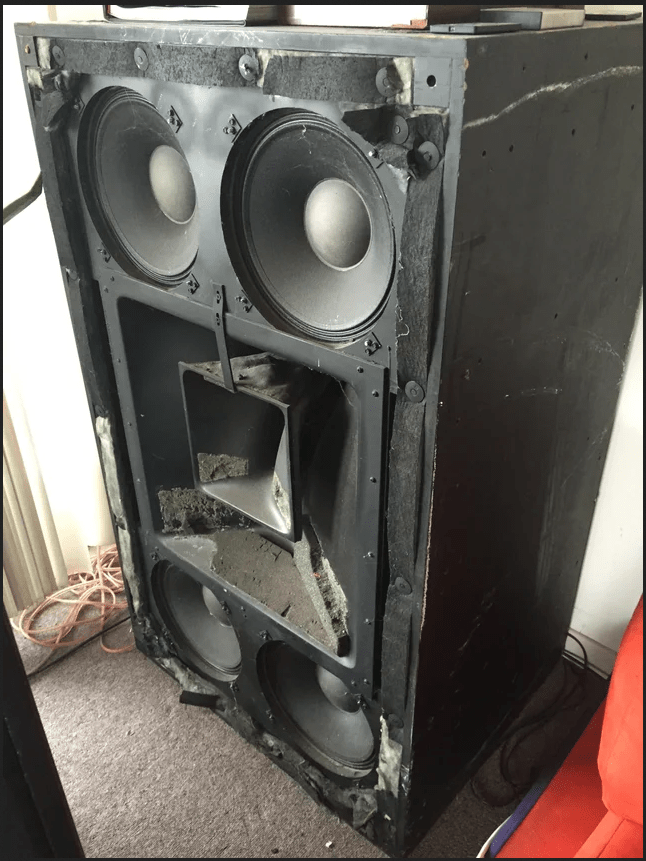

From an interview with Brian Bonnick, Chief Technology Officer for IMAX ( https://www.homecinemachoice.com/content/sound-imax ):
The image attached below was found elsewhere on the 'Web. That is allegedly a single IMAX subwoofer, and those are 18-inch drivers.
By eyeball, that would make the cabinet at least 40"-42" wide, maybe 80"-84" tall. Not all that much smaller than an 8'x4' sheet of plywood (or Styrofoam).
-Gnobuddy
The interview also cites sustained passages at 118 dB SPL in some movie soundtracks.Brian Bonnick said:...Our minus 3dB point is 20Hz. Yeah, it is very low. The loudspeakers, both the sub-bass and the full-range systems, are custom-designed and manufactured by IMAX.
<snip>
(Our woofer drivers) ...have a big Xmax or linear travel, four drivers per cabinet, in custom-ported designs with up to eight cabinets, depending upon the size of the theatre. There is a substantial amount of sub-bass to provide full range when you need it. We make sure you have the horsepower.
-Gnobuddy

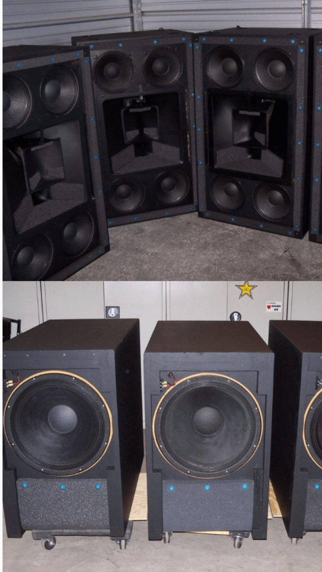

sorry Gnobuddy that's the 3 way top cab of an IMax system and those are 12's

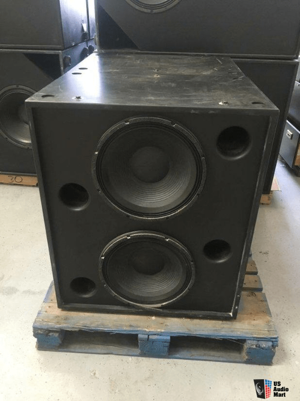

here's an an IMax sub
Thanks. Can you add any details? Driver size? Box volume? Xmax? Driver Thiele/Small params?here's an an IMax sub
TIA,
-Gnobuddy
