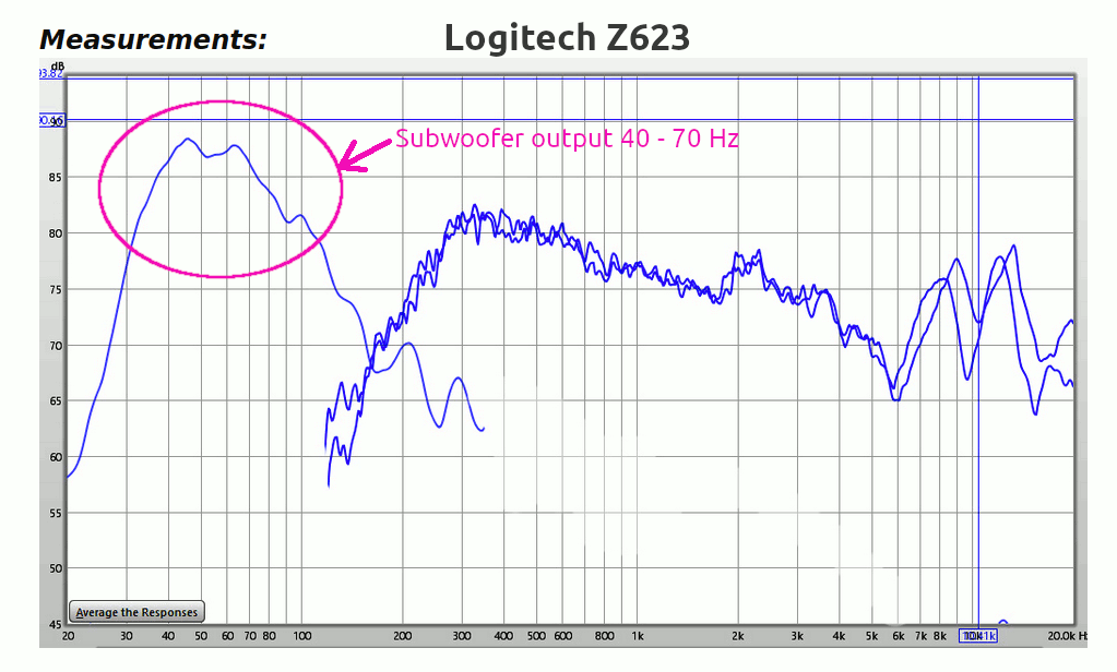

I found a measured frequency response for the Logitech Z623. The subwoofer has most of its output between 40Hz and 70 Hz. It doesn't really do much below 45 Hz. This might explain why it doesn't produce heavy sonic mud that more capable subwoofers do.
The attached plot came from this online review: http://noaudiophile.com/Logitech_z623/
-Gnobuddy
-Gnobuddy

Bear in mind that the review is for the input fed from the "aux" in. When the internal filters and boost is bypassed, it does the lowest fret with an authority that music shop amp cab combos can only dream of. I feel that this combination of driver, port, box and amp somehow has come together in a very optimum fashion. I know I am carrying on like a fanboi but only because I just cannot seem to find a more defined and authoritative package to plug a bass into for anywhere near that kind of money. Please read my tone being totally shocked and bewildered by this thing's ability with a bass plugged in. One thing that just hit me is maybe it is the unit's ability to resist driver distortion and maybe the amp has an awesome peak ability?
I feel the aspects of this unit and what makes it work the way it does with a bass guitar should be explored and developed further
Any idea how the high and mid bass frequencies would get affected? My intuition says teaspooning might be better then clamshell? Opinions?So I've read this thread with interest. Has anyone considered using an isobaric set up as a solution to cab size? Would this not yeild the desired low end with nice tight transients? Just a thought.
I have a 2.1 system on the shelf here that I havent gotton around to messing with yet. The sub features an internal bandpass style mount with a slightly larger passive radiator teaspooned on the face. I totally forgot about this unit
