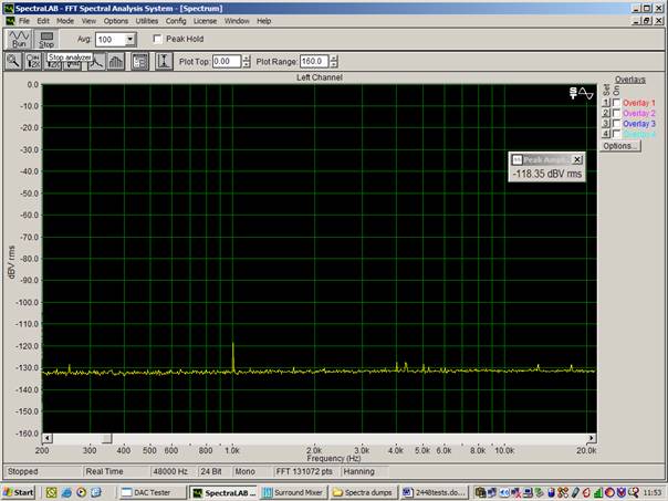

PThe pic below shows the passive balanced PCM1704K @ 0dB and a analog attenuator before the soundcard....still looks better then expected.

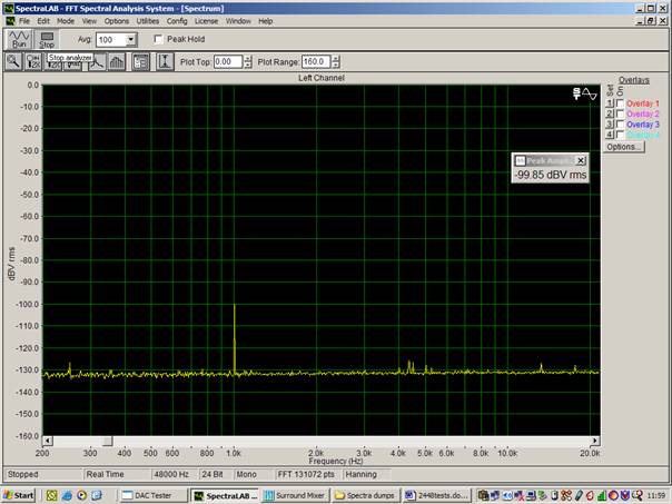

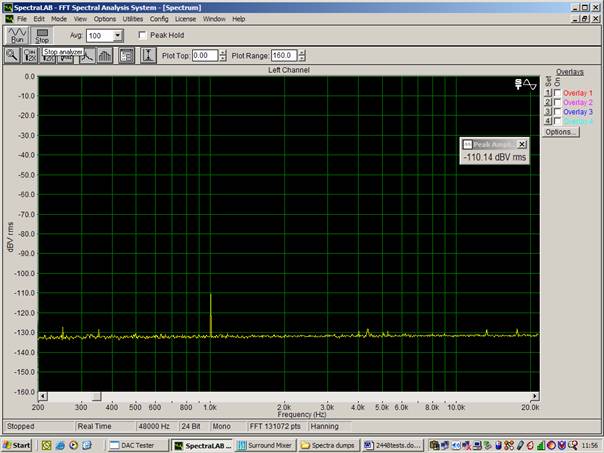

I had to test 24 bit performance and made a few dumps of -100dB, -110dB, -118dB and digital zero still at the poweramp (2*180w) output.
Pretty impressing as well.......
The small spikes @ 4.3, 14 and 18kHz seems to be from the computer/soundcard combo as they are identical if I just short the input on the soundcard.
First out 24/48@-100dB

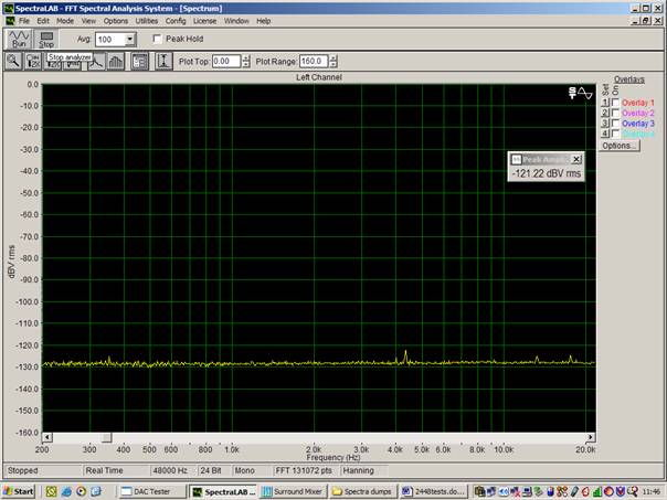

And digital mute just to show I wasn't just lucky getting the -118 reading.
Also shows that spikes orginating from somewhere else but the dac/poweramp combo.

A 8 said:
-118dB...I guess the TDA1541 would have a hard time matching this😉

Seems the distortion is hidden under the noise.
Also such low signal level doesn't exist on CD ? 😕

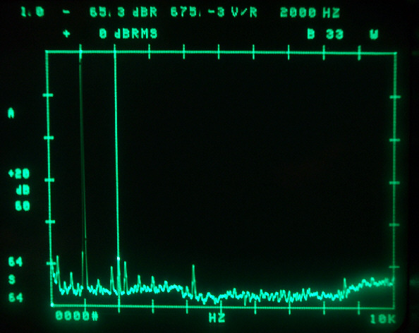

I got two -60dB signals, one from Pedja and one from another forum member.
One had lower noise and I don't remember which one. :bawling:
This is one of my 1541 with os, don't remember which one:
Worst harmonic is K2 is -65dB

Right, however CD is not the only source availible to us. Concerts on dvd in 20-24/48 LPCM makes a big difference when run through a 24 bit dac vs a 16 bit one and can become very engaging.
DVD-Audio through this dac when mastered right is also VERY nice.
I am seriously interested if more bits are better
Well at -60 dB there might not be a big difference but at -100dB and below there will be a significant difference..😉
