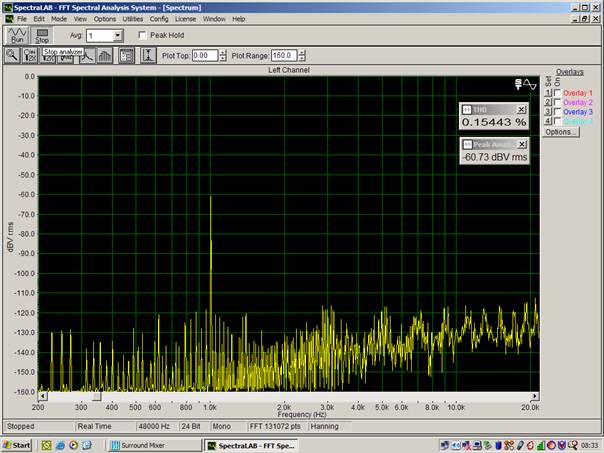

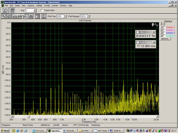

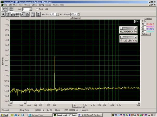

-60dB plots....
I am disturbed about the -60dB dumps.

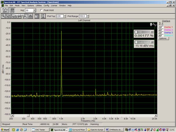

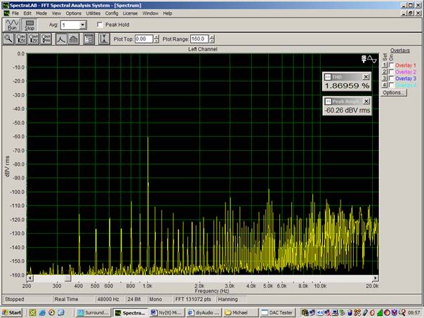

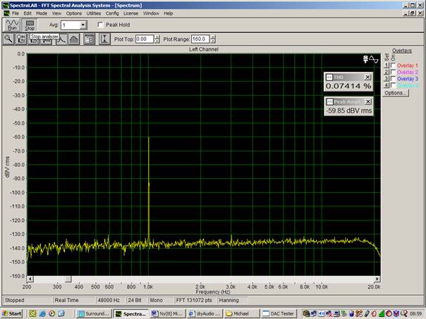

I started a new series of tests playing with bit dephts and another data source ie the DAC Tester that was kindly provided by ULAS on the forum and a Sony CDP.
All pics are spdif direct.
First out is a SONY CDP 16/44....
Could it be that compared to the -70dB signal, with -60dB there are more bitd switching in the DAC chip and those extra switching bits are bad by accidant in the Sony ?

Also, looking at your pics I see similar hash on the non dithered signals.
Could it be that the "hash" only shows when analyzing 16 bit non-dithered data on a 24 bit processing system?
A 8, if that may help, you can download both dithered and undithered, 0dB and -60dB sine signals (.wav files) from here and burn by yourself to CD. You have there all the files analyses as such, so you can know what you are working with.

That hash is the regular part of the conventionally generated signal. That’s why dither. The difference can be seen normally on 16 bit system.Also, looking at your pics I see similar hash on the non dithered signals.
