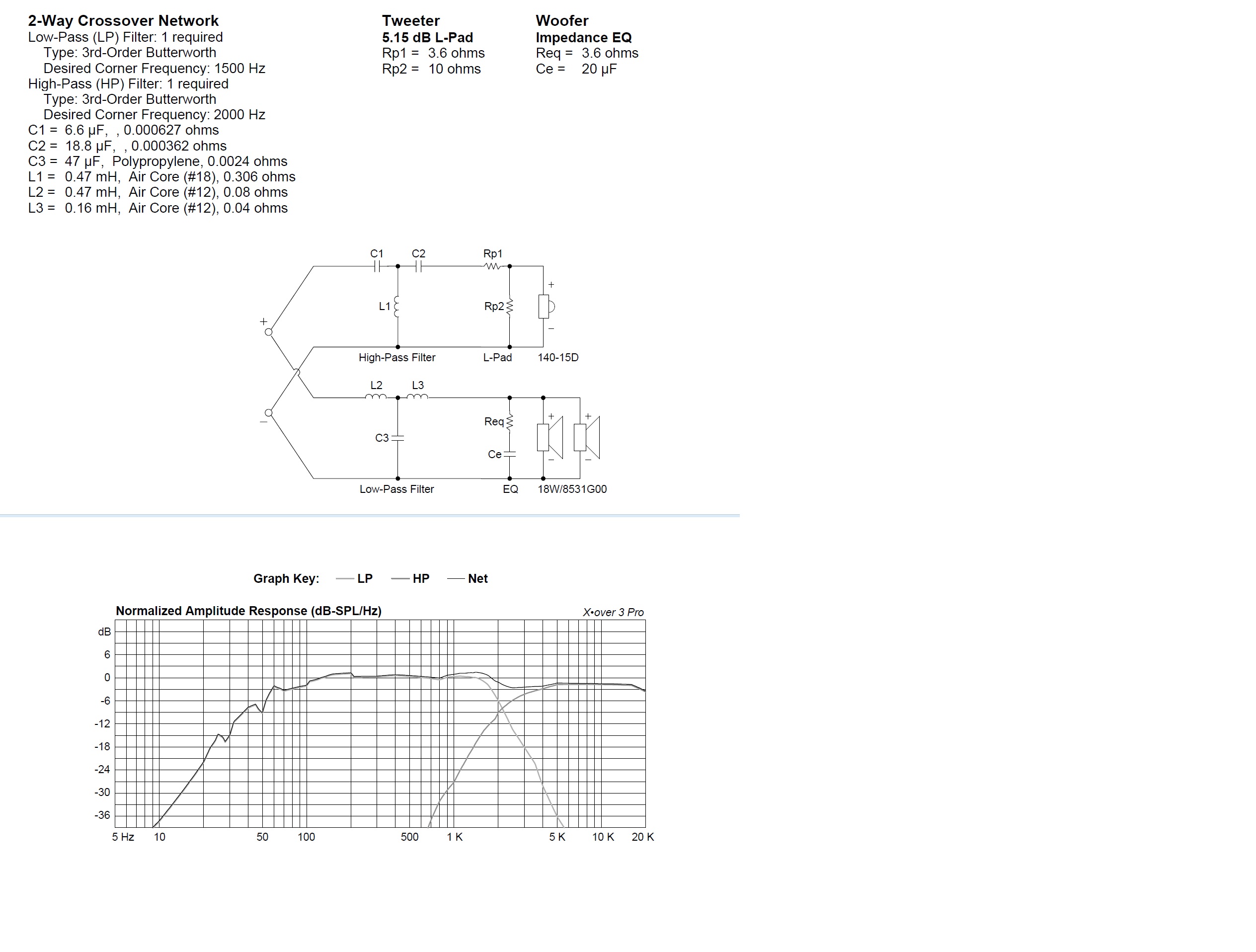

One last try...i found out madisound provides xo schematic for drivers they sell for a fees thinking to go that route...already talked to one sales agent might go that route saves ton of time....
I used their service years ago too. It will get you close, but it won't be perfect since they aren't measuring the drivers on your baffles. You're still picking up an Omnimic, correct?
Close is good enough then zero for me right now...
about mic yes or else u will kill me if i dont buy that 🙂
BTW: i talked to solen guys they already have made the XO using same drivers...only thing they use two SS 18w 8ohm driver in parallel to get a effective SS 18w 4ohm what i already have and phase and other diagrams looks perfect...i might need to change some attenuation on tweeter...this is so far the best bet for me...
SS crossed at 1500 and Raal Crossed at 2000
http://www.solen.ca/pdf/kits/ananyakit.pdf
Any inputs again...
V
talked to solen people and they say this XO will work perfect with the driver i have....as they have two 8516 in parallel effective resistance is 4 ohm for them
I am close to ordering all parts from parts-express only thing not sure about tweeter attenuator....
i hope even i get decent XO as shown in graph i be happy
