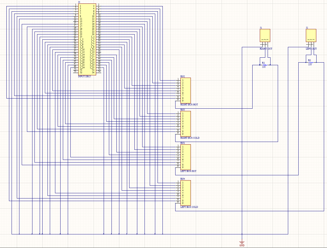

Hey everyone, I'm a recent graduate from electrical engineering and I want to start working my way into the audio field.
I want to create a passive analog summing mixer with 16 balanced inputs and 2 balanced outputs to use in my personal studio. Basically all mixing and panning is done ITB, summed through this mixer, and then amplified by a mic preamp to make up for the attenuation loss. It's a simple concept and a very easy design for me to take on since this is my first.
I'm not very concerned with the schematic design or functionality, but I have little to no experience creating PCB layouts. Especially in the audio realm where things may be done differently. I was wondering If someone could take a look at this layout and review it and offer suggestions/improvements.

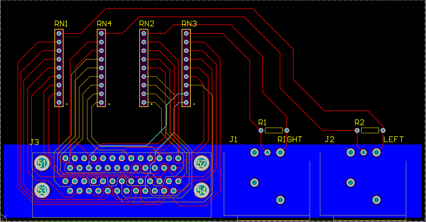

Grounding. I've seen a million different opinions on what to use, and I have ZERO expertise on the subject (star vs plane etc.). Would one of these be better for my specific design? How do I implement it in the most effective way? If I can use ground plane (like I am currently), what area should it cover?
Routing. The dualport dsub killed me. Is it ok to use multiple layers in a design like this? How could I improve my routing? Is 10mil okay for trace width?
Are the placement of my connectors ok? (CAD is not my strength, and I want to be able to use an enclosure properly)
A few things to note:
I want all connectors to be rear facing, so there will be some unavoidable black space (upper right). That's ok with me.
I want to use the dualport dsub connector for the inputs in order to save the most space, even though it makes routing a nightmare.
It honestly blows my mind that I can go through 4 years of electrical engineering and have zero experience working with any kind of PCB design in classes or labs. Thank you for any help, suggestions or ideas, it's been nearly impossible to find this kind of info anywhere.

What's the source impedance? Signal levels? Load impedance? If its all low impedance a groundplane is probably simplest. With all differential signals ground loops aren't a big issue anyway.
No need to go down to 10mil traces where there's room for thicker, its not a logic board, not that it will make any difference.
The signals are all balanced line level coming out of an audio interface with low impedance, and the output would be to a mic preamp. The load impedance will be about the same as the input impedance of the summing mixer (6.8k), as are the source and output impedances (180 ish).
Thanks for the advice, are there typical/ideal trace sizes for audio signals?

If it's a metal box, PIN1 should go to chassis and not to the PCB. (Pin1 dilemma), then just a wire to connect The PCB ground.
I would use a ground plane covering the whole PCB as You intend to use low signals.
What's the purpose of the two resistors ?
Funny that you linked that page, I based my design around the info I found there!
Since you mentioned it, I'm really hoping you can help me understand this. I see mention of chassis grounding whenever I look up grounding related to audio. And it makes sense to me theoretically. But I have yet to find any info on HOW to actually implement this in a real design. Would I literally be soldering a wire from pin1 to the chassis? and then how should that connect to the PCB ground plane? I've been looking for these answers for a while, and I haven't had any luck so far.
Those resistors are shunt resistors that help set the output impedance of the device. There's a formula I used that can be found on the page you linked that factors in the number of inputs, input impedance and desired output impedance.
You solder a wire from each PIN1 to the chassis. Use the fixing bolt for example.
You then solder a wire from the ground plane to a bolt on the chassis.
Or .. solder all 1's together and then a wire to the chassis. That's what most folks do.
Try what works best in Your situation.

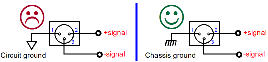

So I can keep the PIN1 to chassis and signal ground completely separate and that's ideal? As illustrated in the picture attached.
What about the DB25 then? There are essentially 16 balanced inputs (positive, negative, ground). Should the grounds of this connector be treated the same way (to chassis)?
Yes, pin 1 should be connected to chassis as close as possible to the entry point, and should not be connected to signal "ground" (0V or common), but keep in mind that signal ground, somewhere inside your enclosure, will be connected to earth/safety ground/PE/chassis/etc. (pick one) somewhere.
See heading "Chassis Ground vs. Signal Ground" and Figure 4 in the below:
Grounding and Shielding Audio Devices
Same thing, connect them to chassis as close as possible to the input connector. You can daisy-chain/bridge these ground conductors with a thick, low-impedance conductor if it's easier for you.
Makes sense. Interestingly enough, this circuit appears to have no signal ground then... The only "grounds" in this device are the PIN1's of the DB25 inputs and XLR outputs. Is that normal?
So... without a signal ground, could I simply connect all the PIN1's together and then connect them to chassis at one point?
You don't have a signal ground in a typical balanced XLR interconnect cable either.
Yes to the latter question, as long as you're reasonably close to the entry connector.
Maybe I'm not understanding something, what's the purpose of RN1 through RN4? And what does ITB mean (for you)?
The RN's are just bussed resistor networks. They're 8 resistors that output to one pin. There are 16 balanced inputs from the dual DB25, broken up into left/right channels (8 stereo pairs). Each stereo channel then has one bussed resistor for the hot pins and one for cold pins, hence 4 total resistor networks.
By ITB, I mean I mix all my audio as though I normally would (including panning) digitally in a DAW. My audio interface will have 16 analog outs via an identical DB25. I group tracks and assign outputs in my DAW and then send them to my summing mixer, and then record the output as the printed mix.
