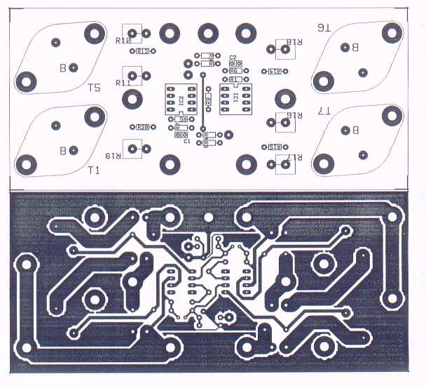

jazzy said:
Pls. for comment or suggestion!

This looks simply great!! And very compact. Can we use TO3P's as well?
JH will love it.
Did you build it?
/Hugo 😉
PASS-JAX2_JH Pcb.
Netlist,
Proto- boards will be finished tomorrow.
I already have all parts so the amp. will be finished in the next few day's.

My only suggestion is possibly making provision for Ro to be a precision trimmer (1k or so). This is the magic resistor since it can alter so much of the amp - gain, feedback, and frequency slope. I can see my self wanting to play with the value...
Sawzall said:My only suggestion is possibly making provision for Ro to be a precision trimmer (1k or so). This is the magic resistor since it can alter so much of the amp - gain, feedback, and frequency slope. I can see my self wanting to play with the value...
Thanks for suggestion - it will be done!

Maybe I missed something. It seems that this PCB is for a power amp? Is there another hread about a PASS-YAX2-JH schematic?

Nice, but how about arranging the power trannies along one side so you only need the one heatsink😉
Check the whole Size for the T03
It looks to me that the whole size is to small for the standard lead. The leads are about .040" so the whole size should be about .045". If these are plated through, you should consult with the the PCB vendor about the loss in diameter from plating.

Which post from the MSSwCF-thread holds exactly that schematic?
Or could you post the schematic here, jazzy?

Post #610 from 17. Apr. 2003

Nice layout BTW!

My present version is of P2P. The wires are running beyond the “audio freak” distances and the arrangement smells of non-professional.
In comparison, your PCB looks much nicer. 😎
