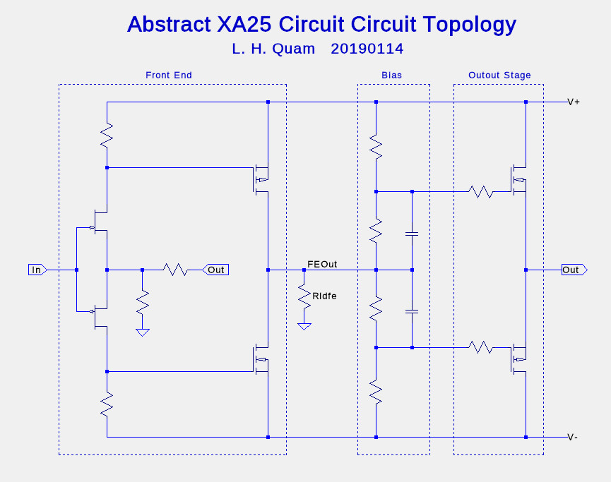

I have built something similar to the XA25 which has the circuit topology shown in the image below. Simulations of the amplifier show the open-loop gain (OLG) as follows:
[FONT=Helvetica, Arial, sans-serif]Rldfe OLG[/FONT]
[FONT=Helvetica, Arial, sans-serif]none 70dB[/FONT]
[FONT=Helvetica, Arial, sans-serif]2.2k 52dB[/FONT]
[FONT=Helvetica, Arial, sans-serif]1k 45dB[/FONT]
[FONT=Helvetica, Arial, sans-serif]The OLG of the built amplifier is slightly lower than the simulations.[/FONT][FONT=Helvetica, Arial, sans-serif]none 70dB[/FONT]

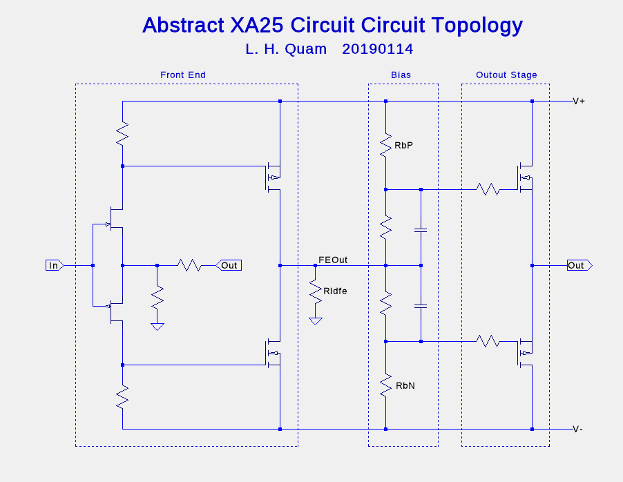

I forgot to mention that the AC load on the front end is the parallel resistance of Rldfe and the bias network. Ignoring the capacitance of the output FETS, the bias network presents an AC load of RbP || RbN. For my amplifier RbP || RbN = 16.5K Ohms.

Getting around this for the XA25 vas stage actually involves more loading
of the input devices, which is compensated by the greater gain of the
undegenerated vas transistors. ..........
more loading - most probably means lesser (than usual) ohmic value of drain resistors on input JFets , thus smaller gain (than usual) of input JFets
though , by simulations of Real McCay ....... OLG is damn high ......... even if we count on fact that in vivo it is smaller , it seems Pa started making MC preamp , ending with wakoo power amp

Reducing the value of the J-fet drain resistors cannot compensate the huge gain if the VAS transistors, not degenerated, only with a load at the FE output I got values of OLG Nelson seems to speak of....
