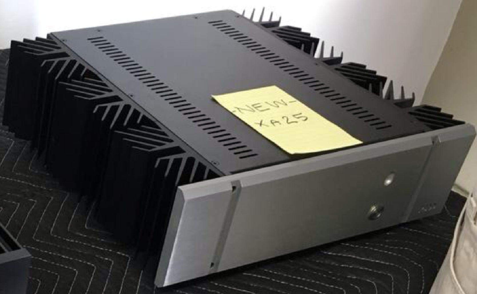

I saw one at a picture from BAF2016. So i googled this:
Pass Laboratories XA25
Read the description and look at the artwork picture. A new amp SE with hockeypucks. 700W 40 A 😀

Based on specs it's almost certainly push pull, but the description "single ended circuitry" seems to contradict that.
More Papa magic by the sound of it.
I saw one at a picture from BAF2016....with hockeypucks. 700W 40 A 😀
Nice!
with IXYS IXFN ?
Two transistors beacause CCS maybe ?
Always interesting amp non surprise....oh yes 🙄
Perhaps a variation on the Aleph CCS?
Yeah certainly possible, even Mu Follower can exceed well past the quiescent bias point if setup correctly.Perhaps a variation on the Aleph CCS?

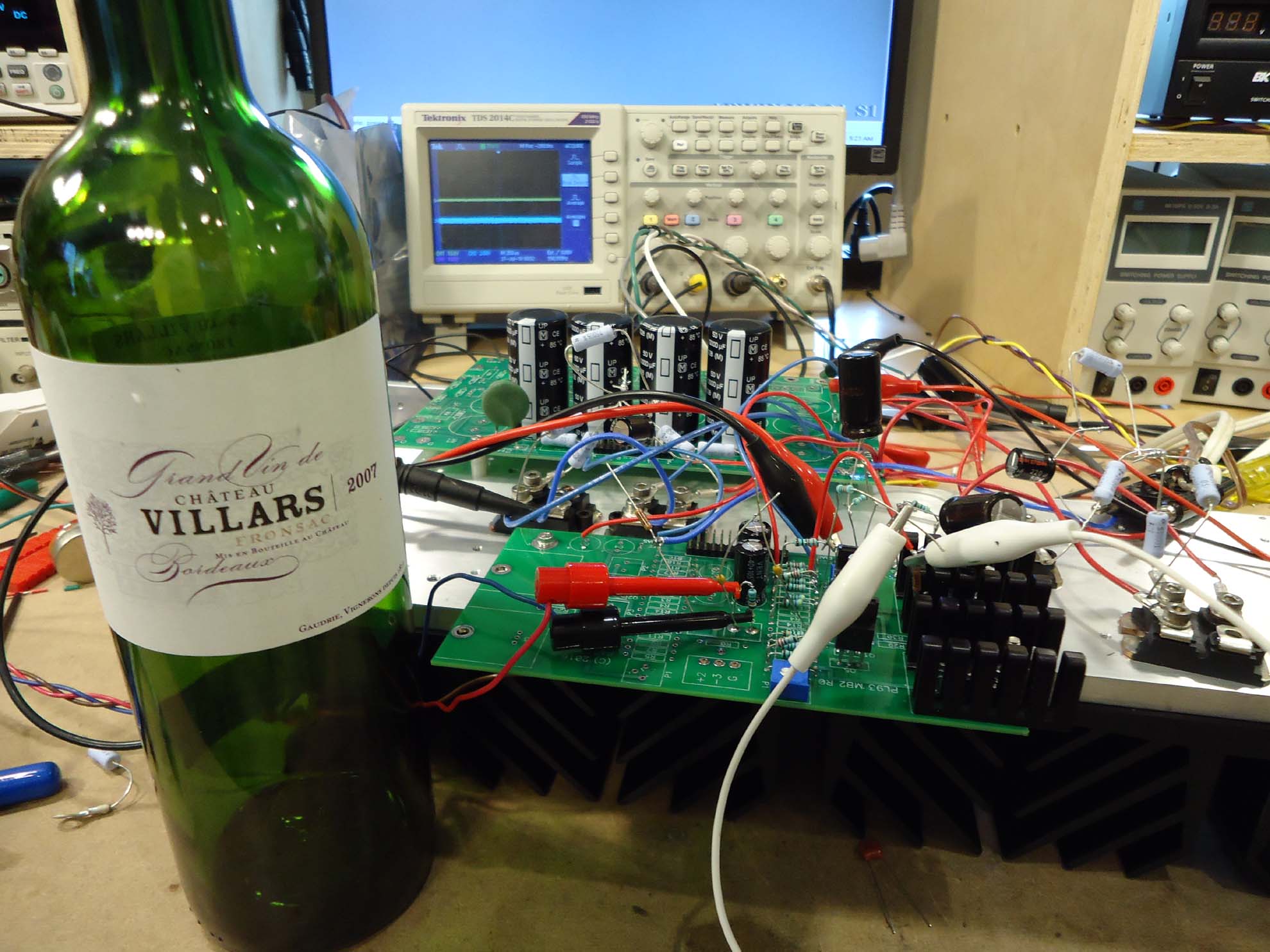

Is this the amp from the "Villars" pic?
Likely not. From the Villars 2007 thread:
Nelson Pass said:I was exploring was the ability of cascoding to improve the Gate-Drain
capacitive nonlinearity of the hockey pucks. In this case it was not particularly
good. I will add that there are no additional plans for this circuit approach at
this time...
Single ended may even mean that the circuit is just not a balanced circuit like the rest of the XA series.Perhaps a variation on the Aleph CCS?
I'm not willing to bet the house on it either way.
I did a quick mock-up in SPICE based on the description linked in the first post. While just a basic mu-follower, it simulates very well and matches the stated specs fairly well.
clever cheapskate can always joggle with approach to and difference between balanced , symmetrical and differential .......
The only problem is, this seems to suggest a different front end,I did a quick mock-up in SPICE based on the description linked in the first post. While just a basic mu-follower, it simulates very well and matches the stated specs fairly well.
"The simple front end circuit uses uses two pairs of NOS complementary Fets in common-source mode"
If you look at the F1 it's described as a Ballenced Single ended so I assume the same term could be applied to the X series of amps. FIRST WATT F1
The latest XA .8 series amps have complementary push pull output stages, although they do have a small amount of single ended bias.
I wonder whether a Taylor Current Source (source follower output) might be used.
Would that be considered single ended? Or is that cheating.
The artwork linked above doesn't show the two large power resistors mounted to the center heatsink on each side.
