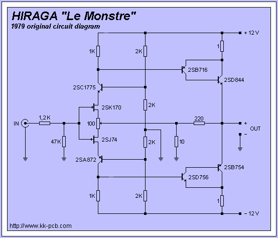

when it is simple as Nelson says, it could be something like the "Le Monstre"
instead of one SK170 two, same for SJ74 to allow higher bias for the J-Fets.
At the output something with the higher transconductance Monster hockey pucks, complementary.
only difference Nelson made a real MONSTER out of it!

"The simple front end circuit uses uses two pairs of NOS complementary Fets in common-source mode"
In the first description it looked like a 2 stage system with a double buffer at the input.
I initially thought that as well, but "two NOS pairs" more likely means 2SK170/2SJ74 driving 2SK2013/2SJ313 in an F5-style arrangement like half the front end of the supersymmetric amps.
