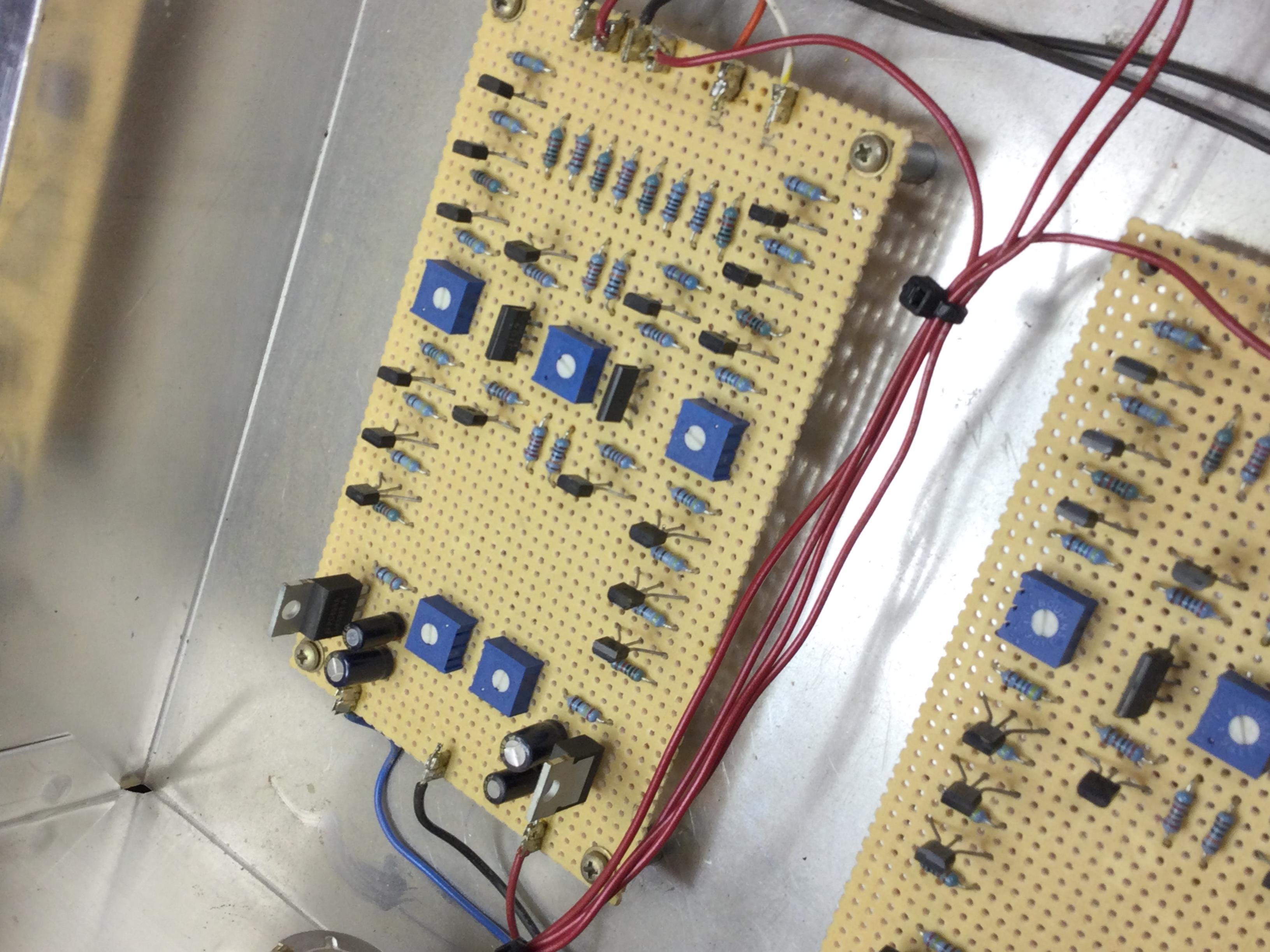

I think when the output current of the mirror is significantly larger
than the input current you probably want to think of it as a gain stage.
The question of why one might switch to having a second stage in the
front end has a simple answer in my case - I wanted to use the Toshiba
2SK170 / 2SK74 Jfets for the inputs instead of the existing power Mosfet
parts. The folded cascode or current mirrors require current from the input
pairs as large as the output current which has to drive the capacitance of
the output stage.
10 mA bias simply didn't cut it, and I wasn't ready to parallel large
quantities of those parts. In hindsight, it was a good decision...
