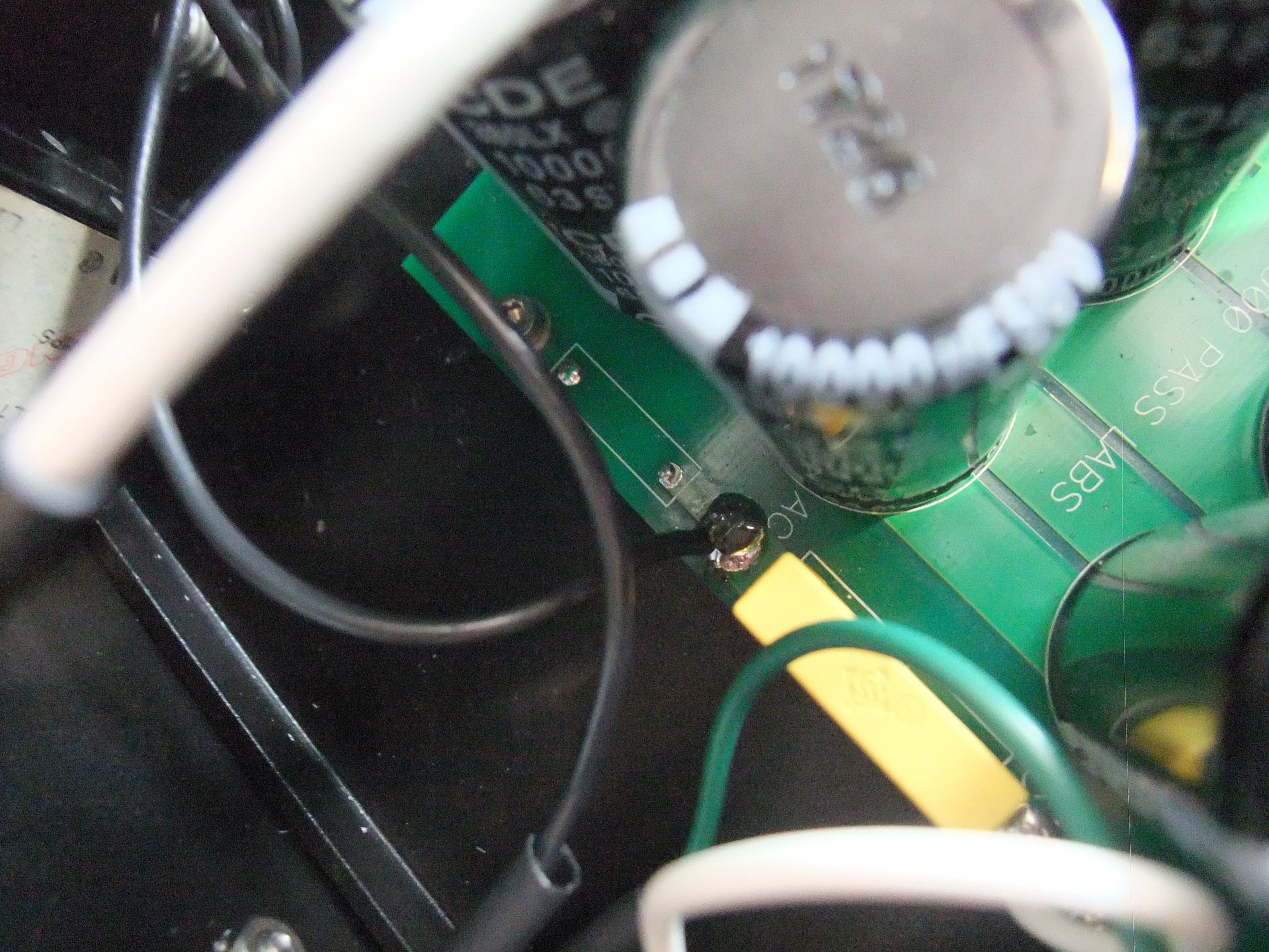

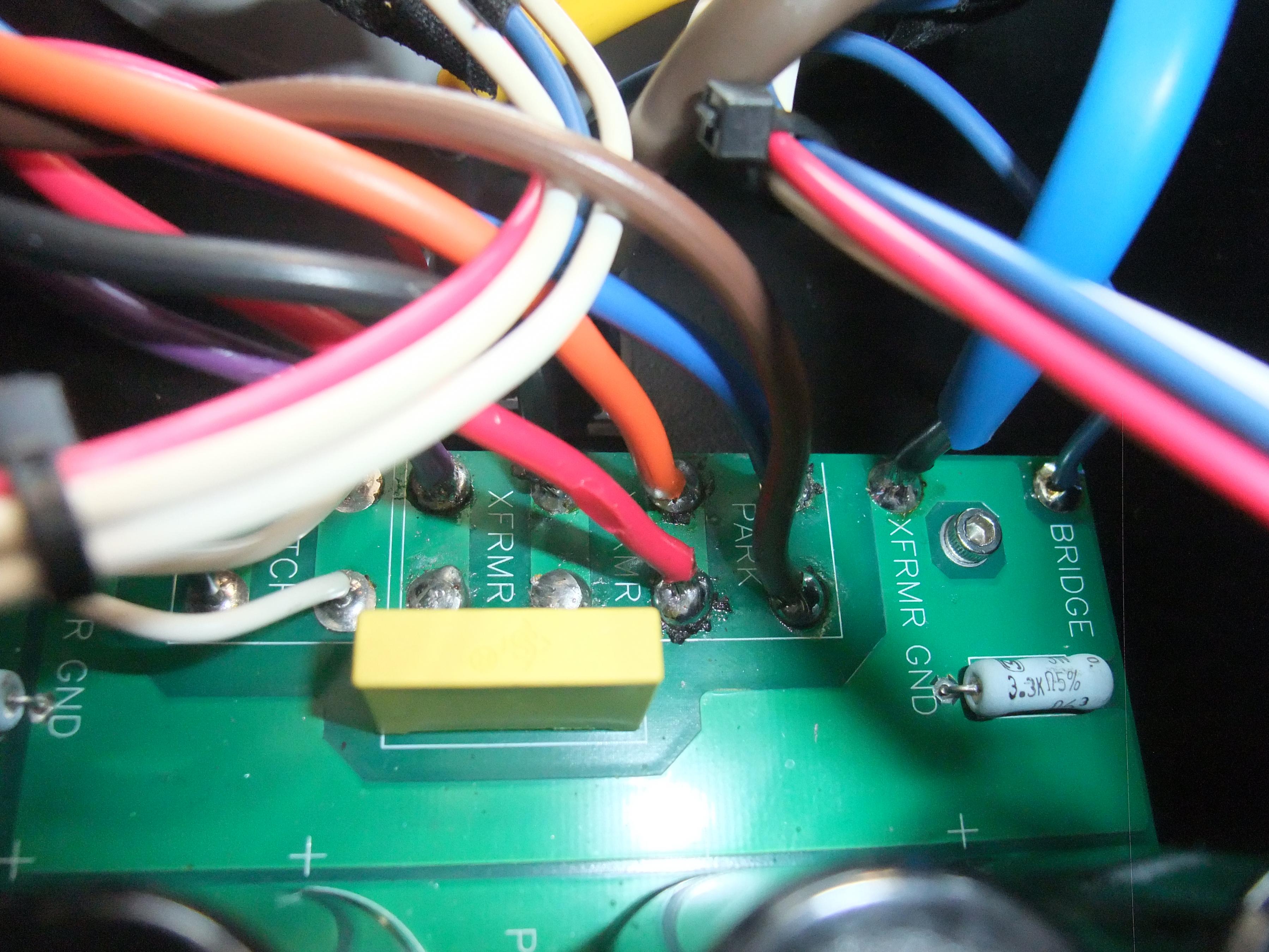

After removing the doubly present capacitors between the 230VAC manis connections and the chassis no audible hum is present.
Two capacitors was on the supply PCB (fifth and sixth image) and two in the integrated filter of mains input plug (seventh image, replace by an input plug without integrated parts).

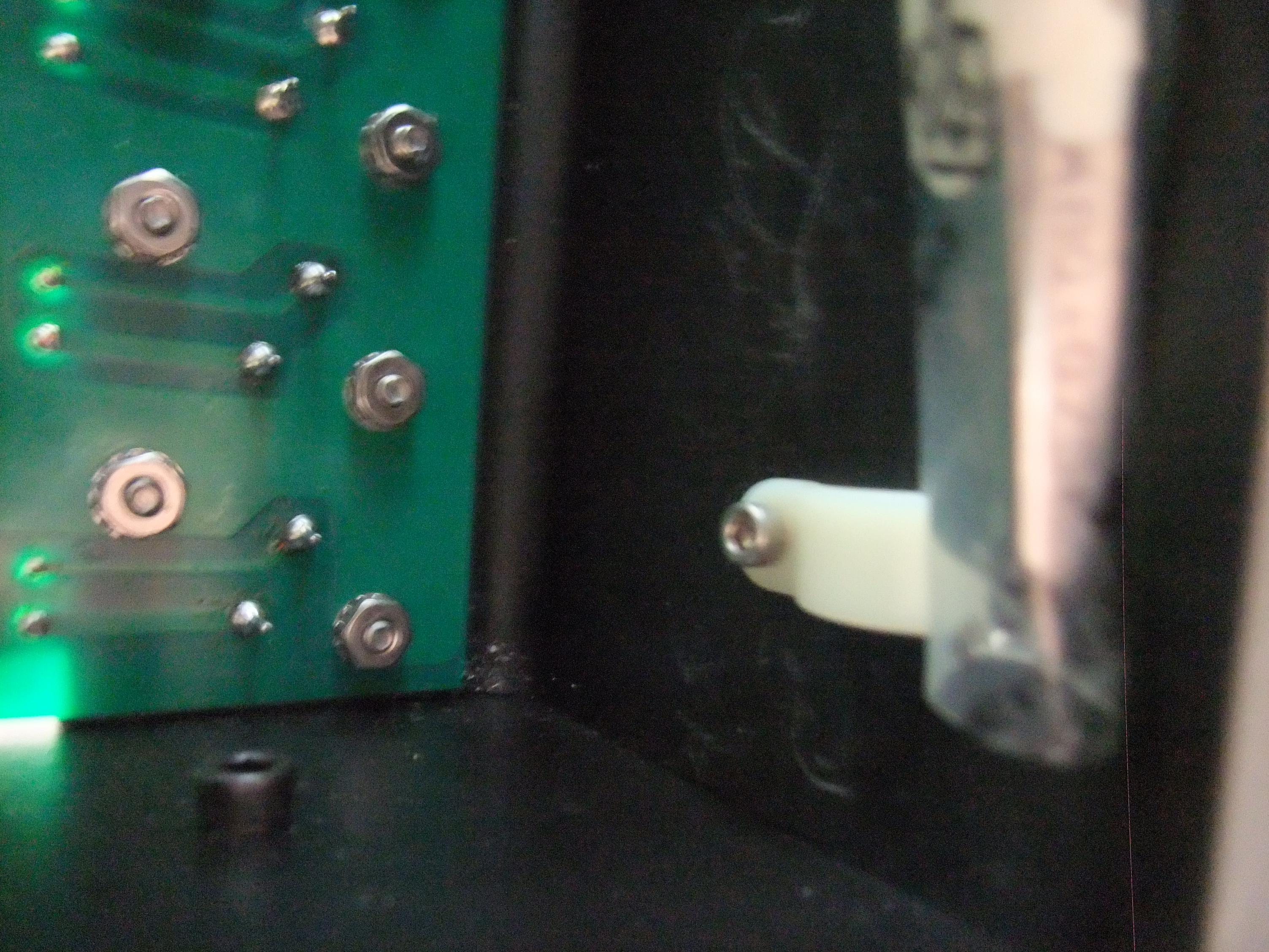

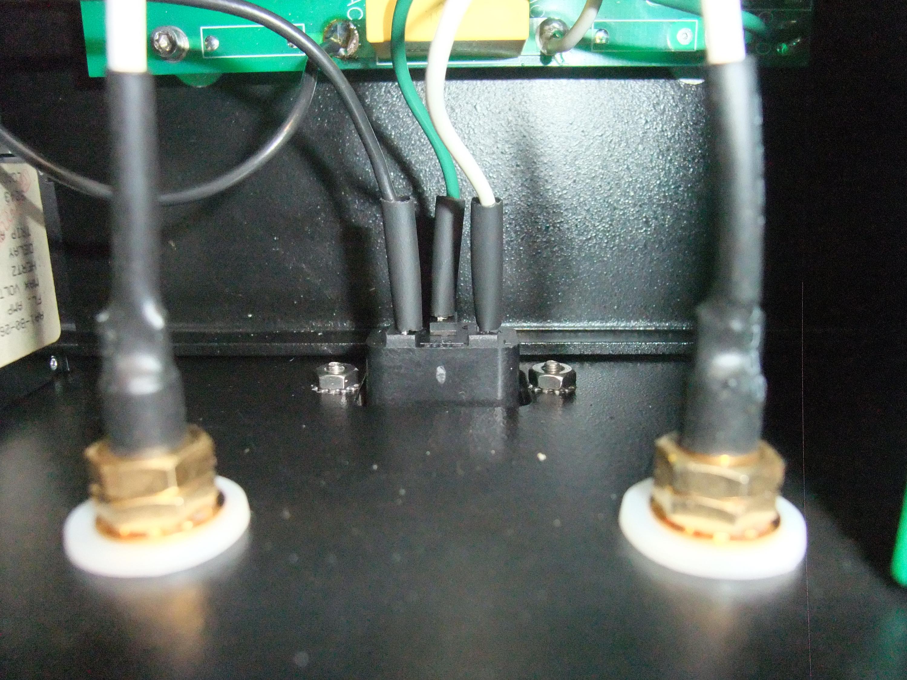

Last both images show the clamp resp. clip for fixing the thermal fuse. But it is impossible to do this.
The final step requires obtaining a good quality clamping fixture as well as drilling new holes in the heat sink (disassemble again is necessary unfortunately).
I'm not really enthusiastic - a detailed report of all deficiencies will follow together with the residual circuit diagrams.

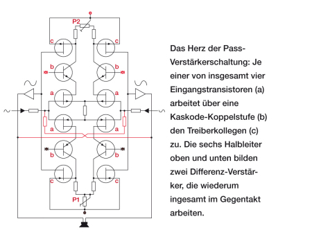

according the instruction manual resp. owner's manual the circuit topology from x250 is according those from SuSy patent - go to
PassDiy
i. e. designed as folded cascode and thus a single gain differential amplifier stage (that means lower open loop gain).
according my own created schematic from X250 the circuit topology consist of a differential amp as input stage and a voltage amplifier stage (VAS) as driver for the following source follower. This topology is very similar and more close to that of the simplified schematic from first image in the attachment than that of the SuSy patent

i. e. designed not as folded cascode and thus two voltage gain stages (that means higher open loop gain).
This image was published in German's magazine "Stereoplay" from 2008 (second attached image is the cover), test report from INT-150, issue from july.

For me the reverse engineered X-250/UGS3 circuit contains THREE STAGES:
1) The input pairs
2) The VAS (actually current mirrors, NO its not a folded CASCODE)
3) The power output stages

But for people for whom it is both important to acquire the best possible sonic quality and who want to know why that is so, this is a very important detail in the circuit.
These differences also exist in the circuit design of operational amplifiers and, as a result, different focus areas arise;
this is a typical one gain stage architecture - go to page 10 under

The schematic from PDF in post #7 underI did replied to your question:
As far as I know, none of the power amplifiers from the X-XA-XS series actually have a single-gain stage according to the patent (folded cascode)
Pass X250 concept ?
looks interesting, because it is much more close to those topology from SuSy patent.
When I replace the current mirrors (which serves as level shifters) by a folded cascode (of course with simultaneous change of the polarity from the signal inputs), then I will get the topology from patent with only a negligible difference:
Instead of a folded cascode I have a nesting of a normal and a folded cascode.
But definitely then there is only one voltage gain stage (according the patent) present.
Without having tried or tested it myself, I am sure that the replace of the UGS module by this circuit from post #7 provide better sonic results by a listening test, as long as no new errors nestle in the implementation.
BTW - the attached file from post #12 under
Pass X250 concept ?
shows also a schematic with two voltage gain stages, which is close to my own created schematic from X250, but
possibly with an improved offset setting (location of VR2 for offset between the outputs and GND could be crucial here).
