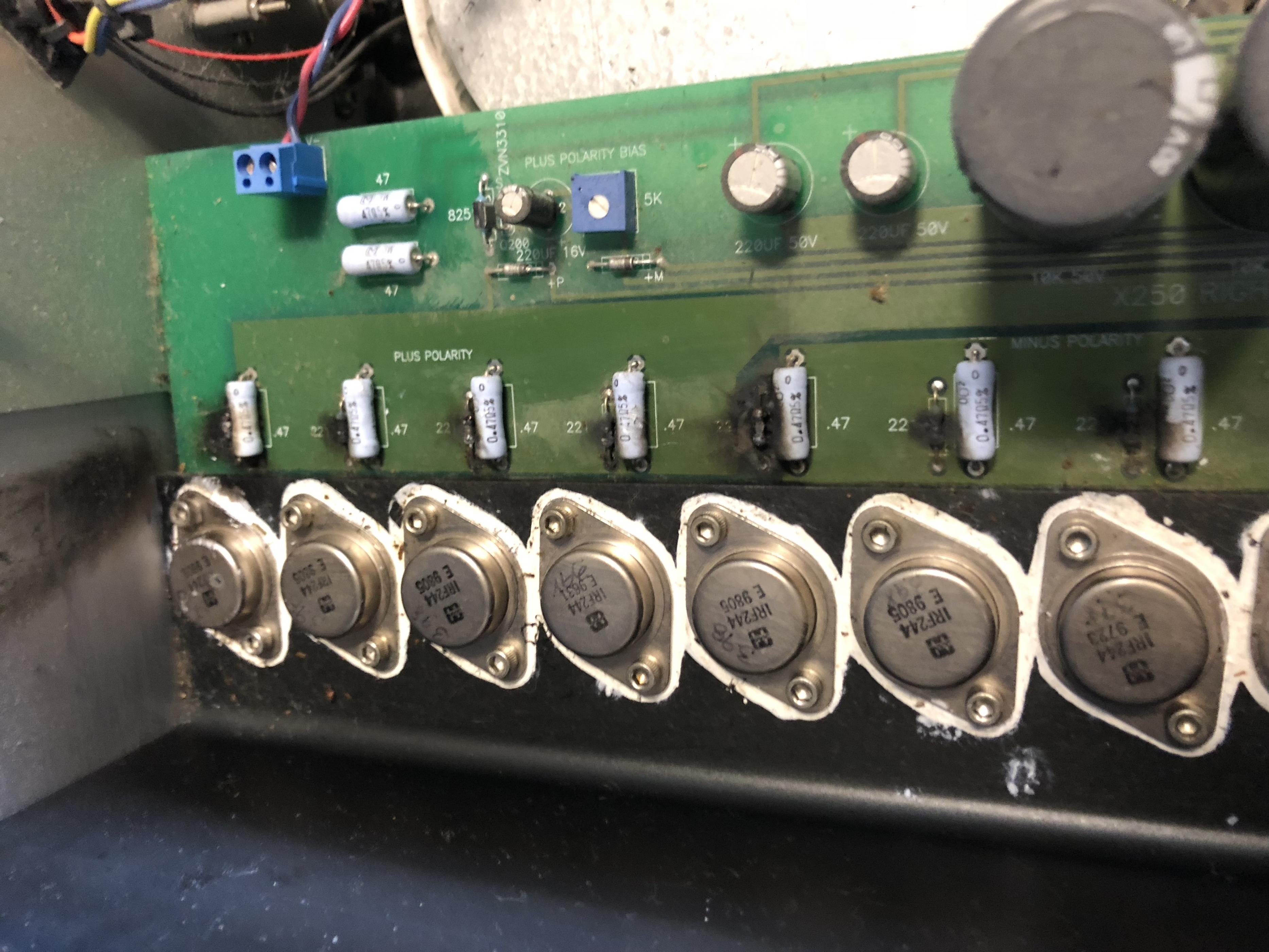

Those boards look pretty bad. You need matched devices and maybe boards. Are you in the US? We fix anything we have every made at a price nobody can beat especially if you smile. Current repair back log is zero.
+1Start looking for nos irf244 or replacements.
it may cost as much as the amp itself

What could be the reason for the D-G-S-shorts in the MOSFET's and the burnt gate-stopper resistors ?I’m not sure is this the right place for this. I bought a known broken X250. Right channel is out. I’d like to fix it myself. How hard of a repair? Where to get parts? Story in pics below.
Maybe too high idle current ?
I have measure between 45-50mV at each 0R47/3W source-resistor (i. e. ~ 90-100mA) (S/N 11651).
What is the correct value and which range of variation between the individual MOSFET's can still be accepted ?

N-ch power mosfet are all IRF244 (not IRF240)
P-ch power mosfet are all IRF9240.
Was this the genuine condition or have the MOSFETs already been replaced ?

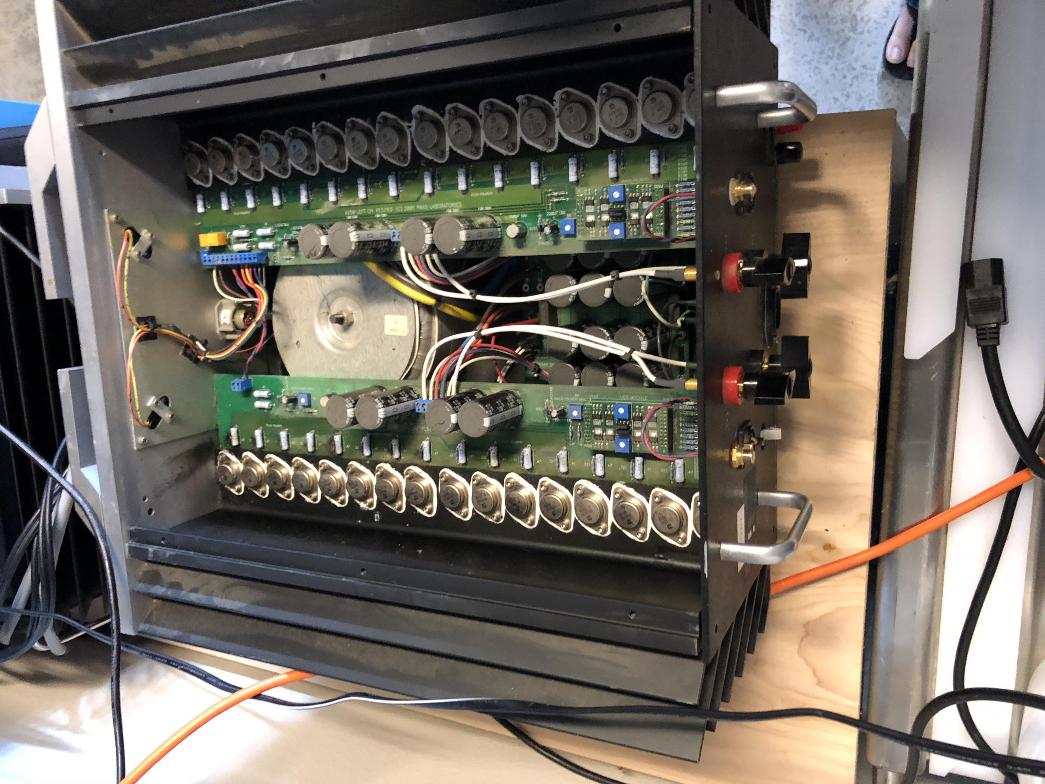

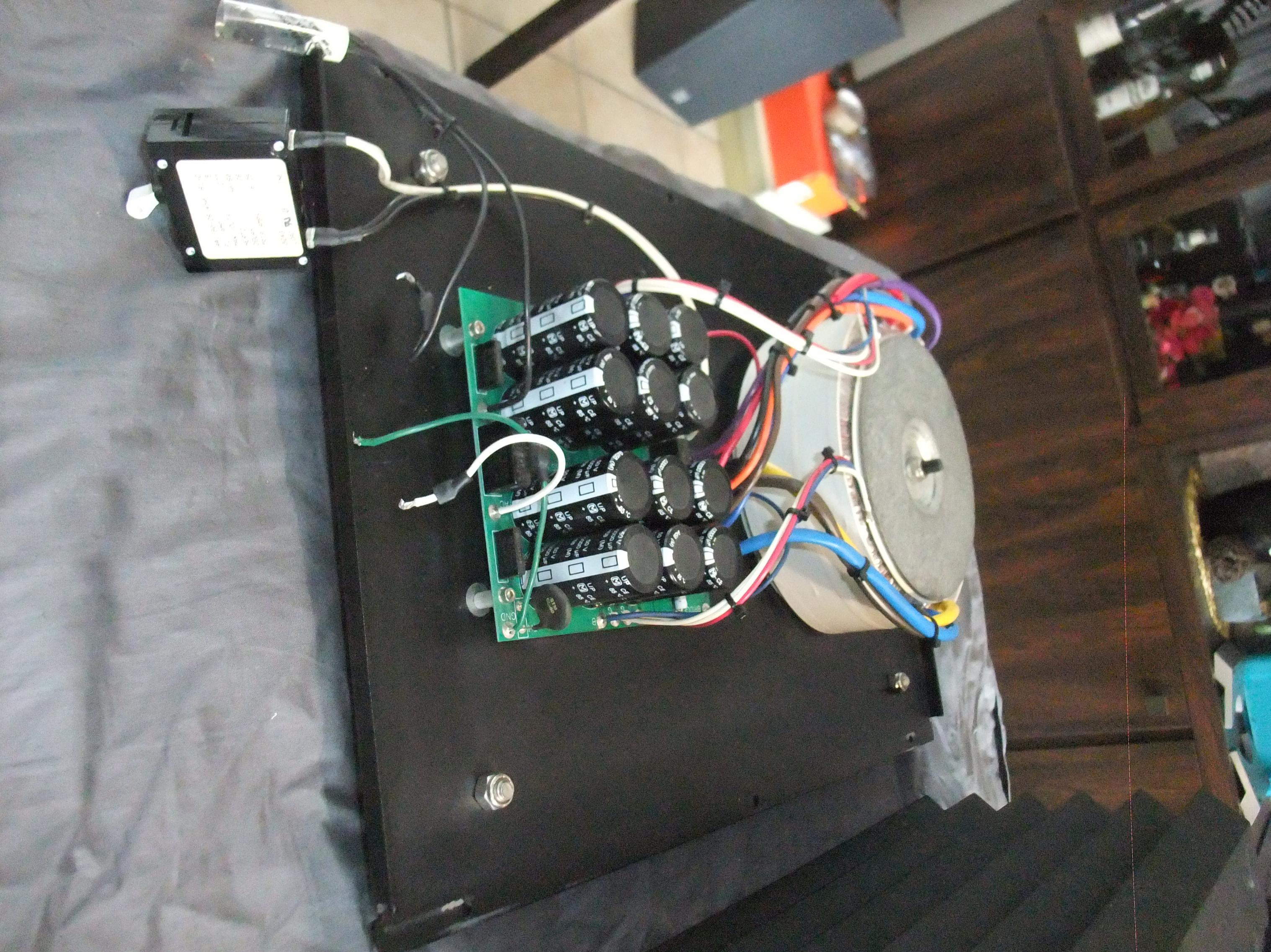

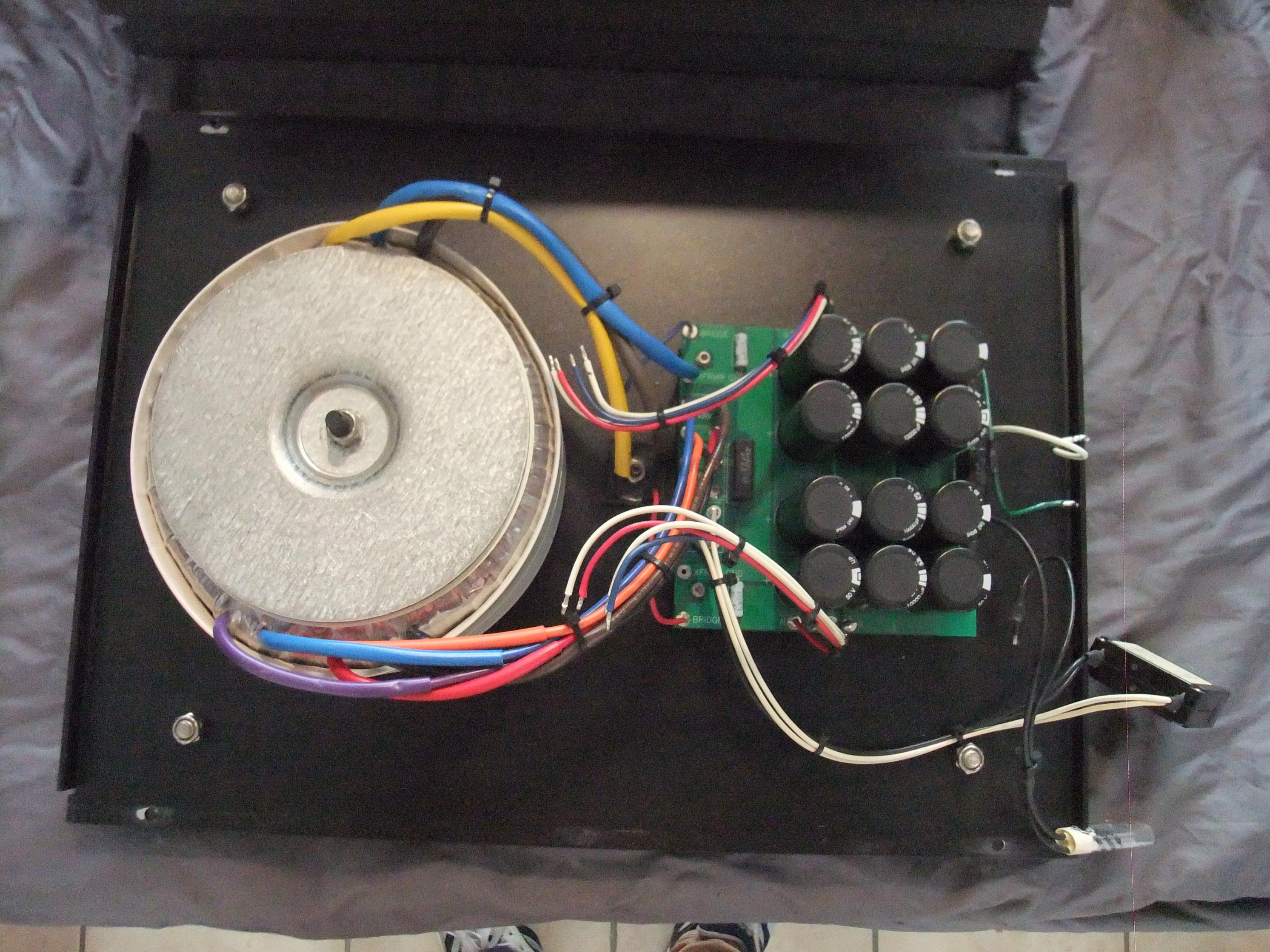

X250: Stripdown, Clean, Recapping and Schematic creating
First image: Unusual Main switch: Single Pole White Toggle Circuit Breaker. Supplier:

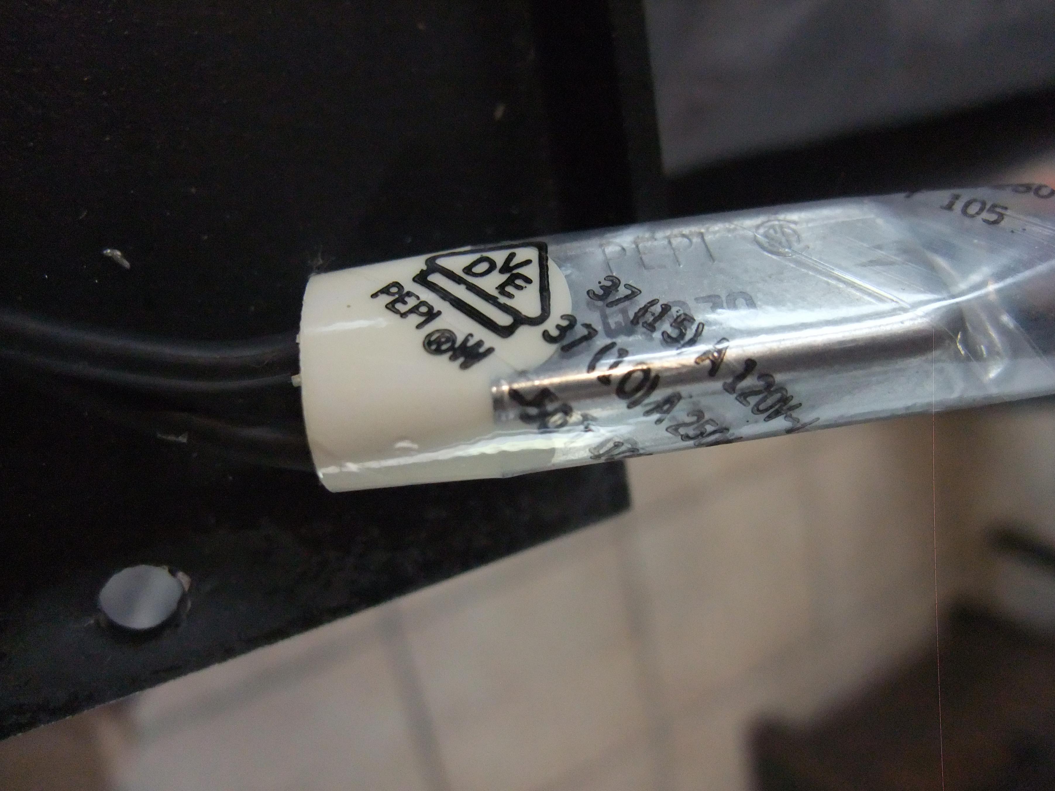

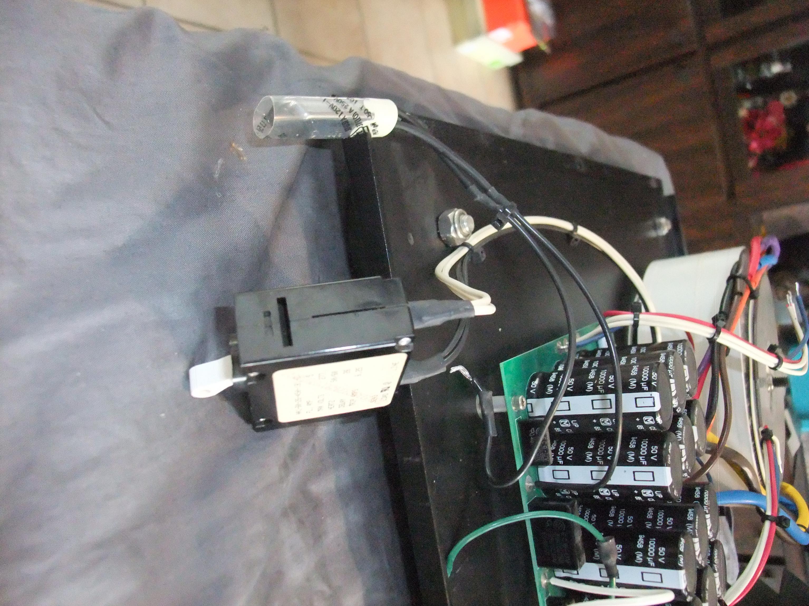

Second-third Image: ATC Semitec PEPI Thermostat
PEPI Thermostats and Thermal Protectors | ATC Semitec

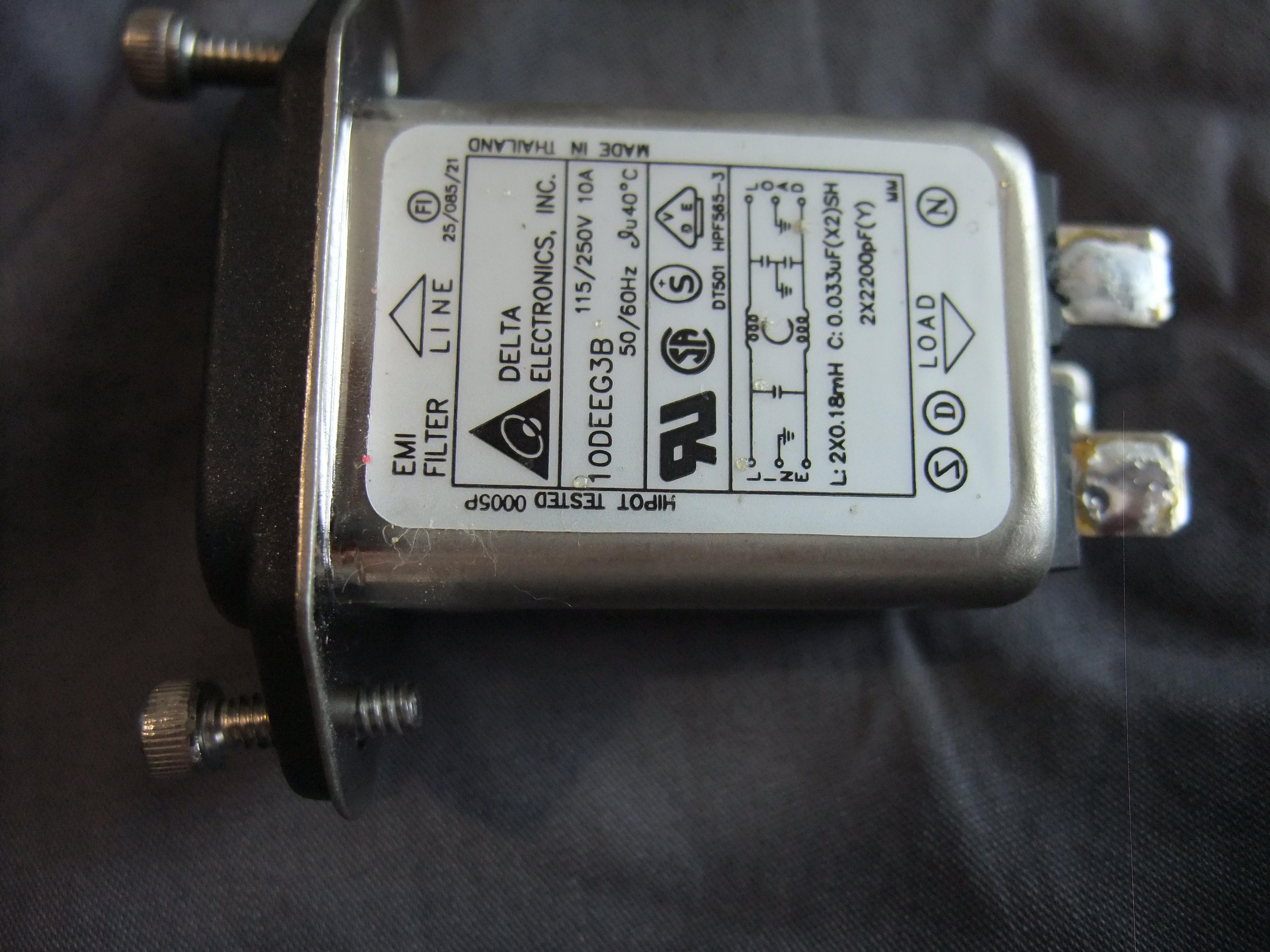

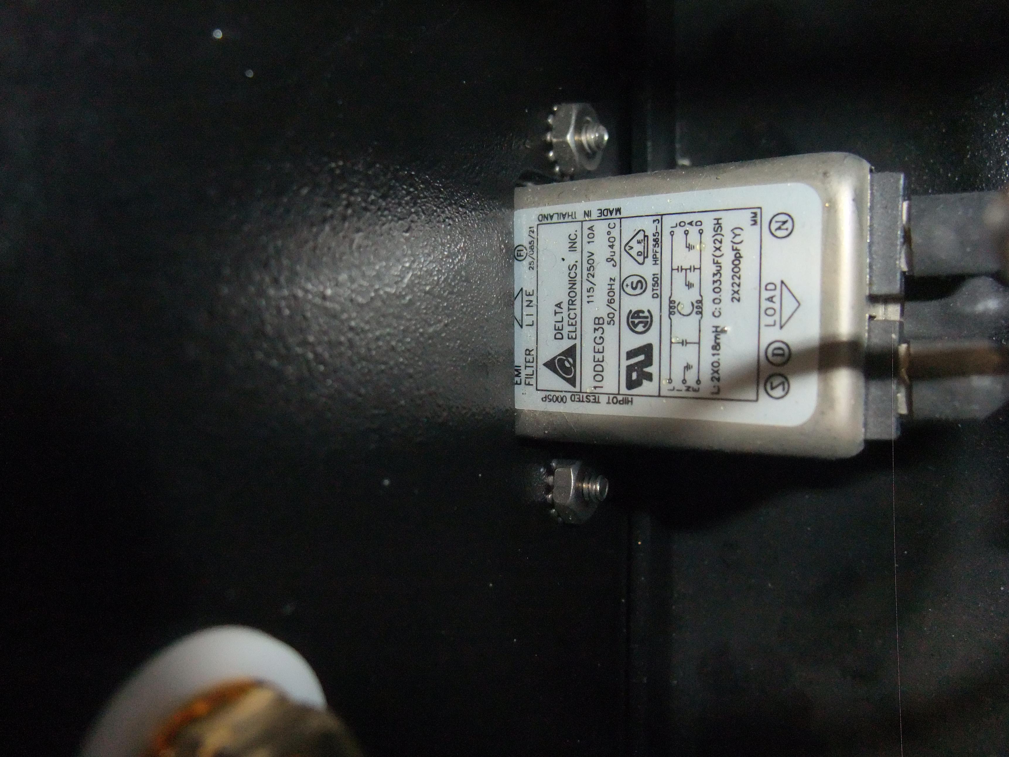

Fourth-fifth image: mains power entry connector (plug) with Emi/Rfi filter IEC 320/60320-C14 (IEC Inlet Filter)
Delta Electronics Manufacturer Part Number 10DEEG3B

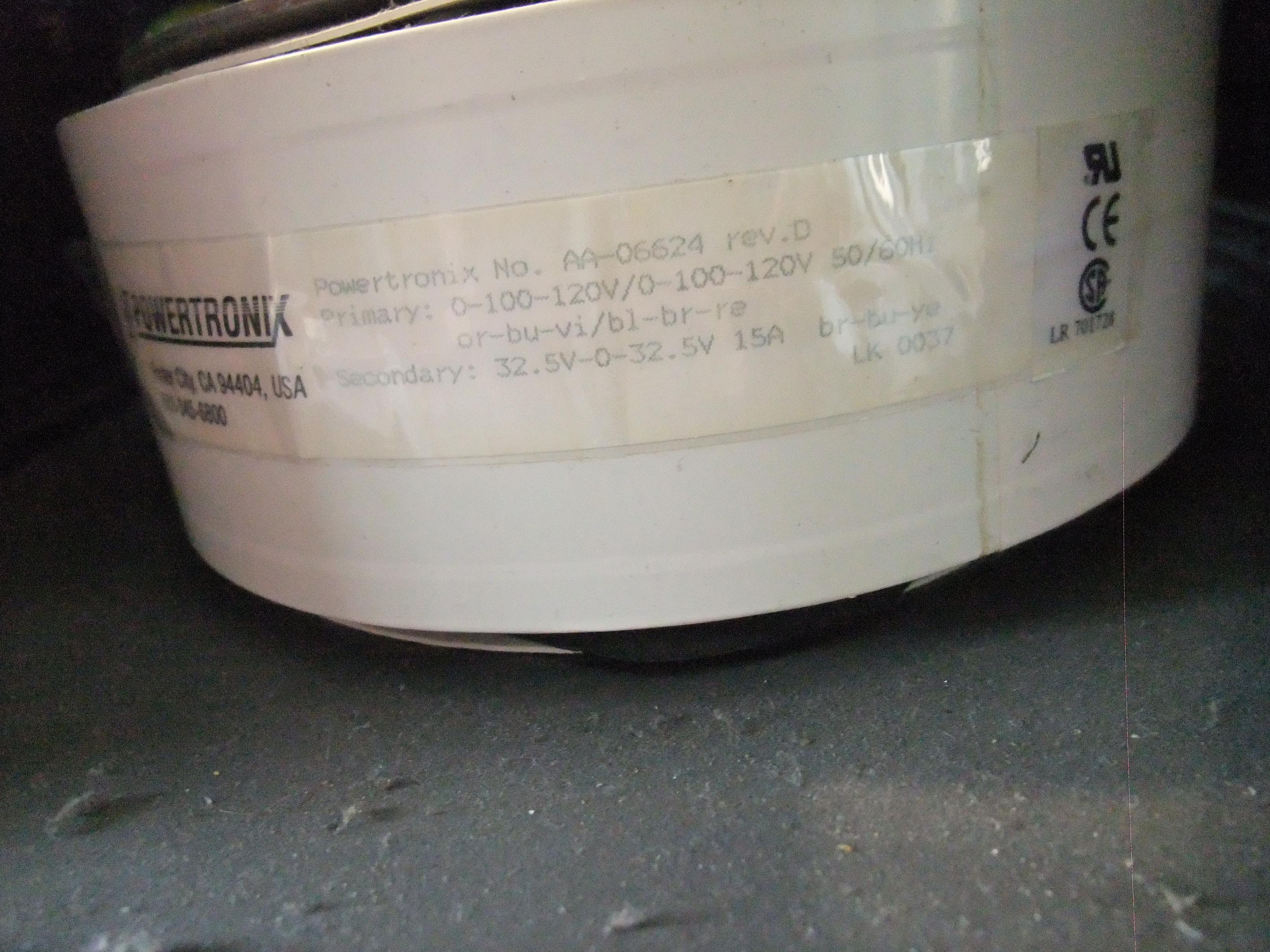

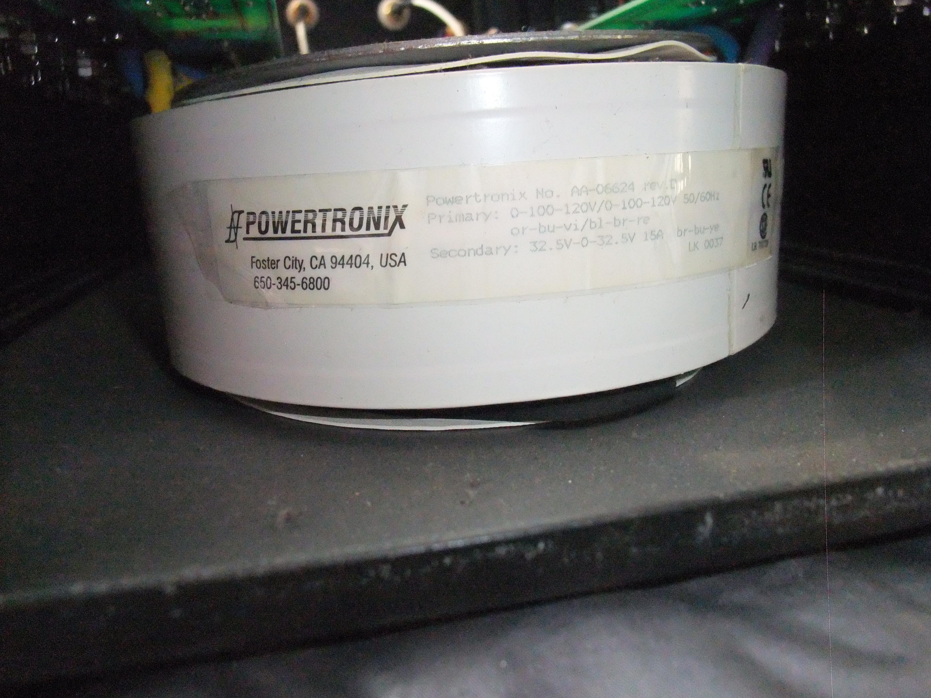

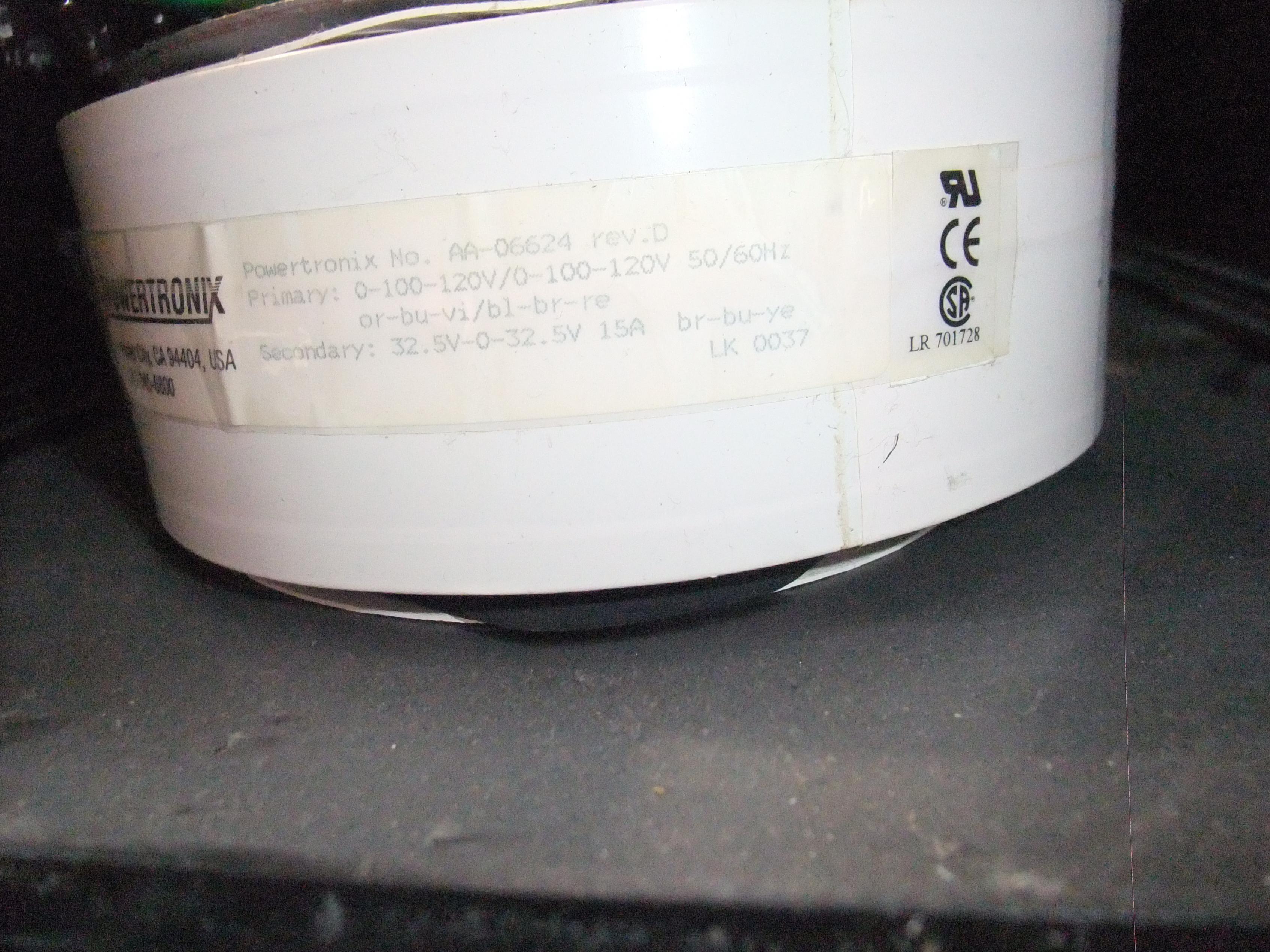

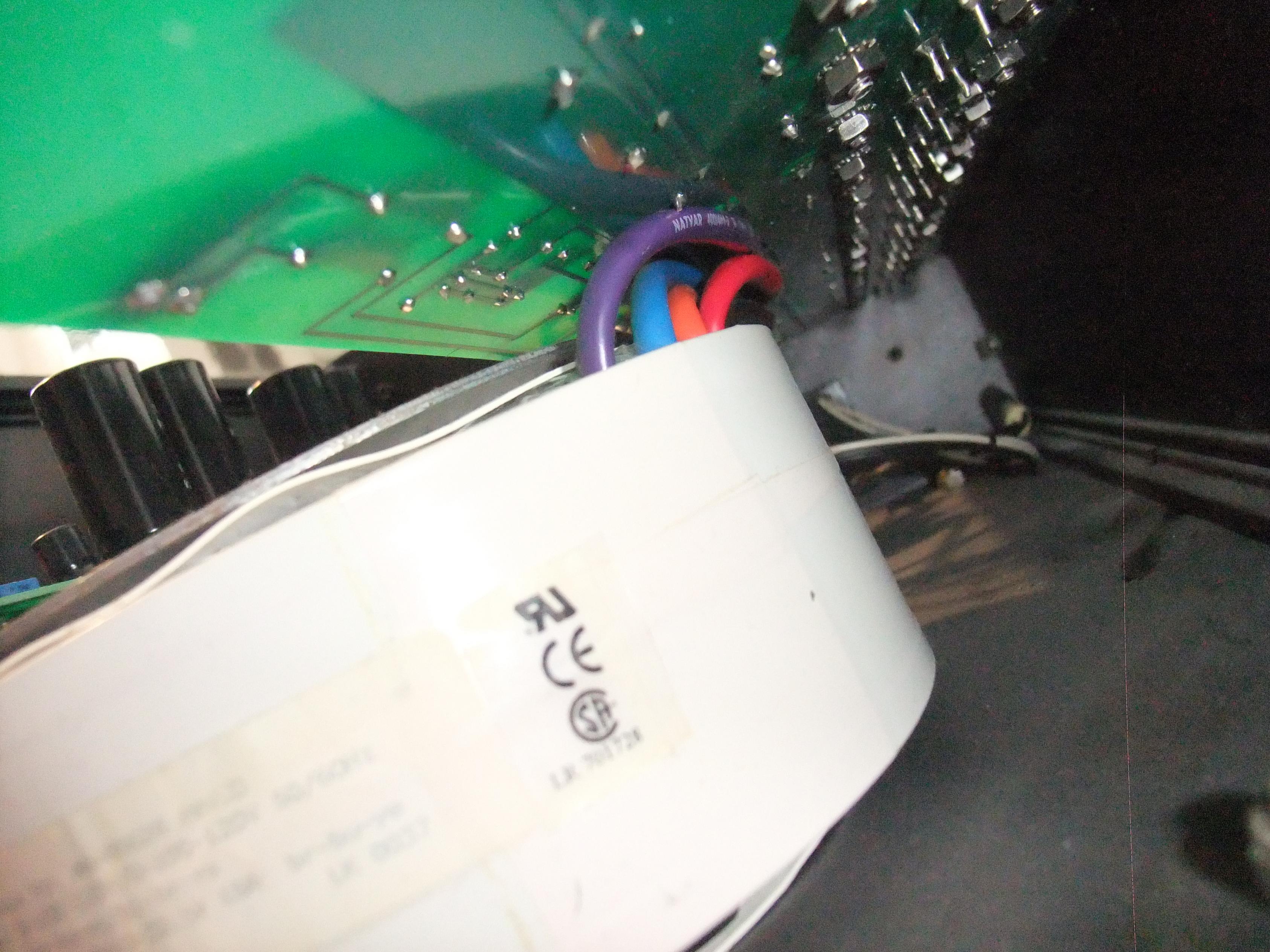

from sixth Image: Toroidal transformer POWERTRONICS AA-06624 rev. D, 2x32V5AC, 15A, LK0037
Transformers - Powertronix
A-Series White Toggle Circuit Breaker - Single Pole10A - Blue Sea Systems

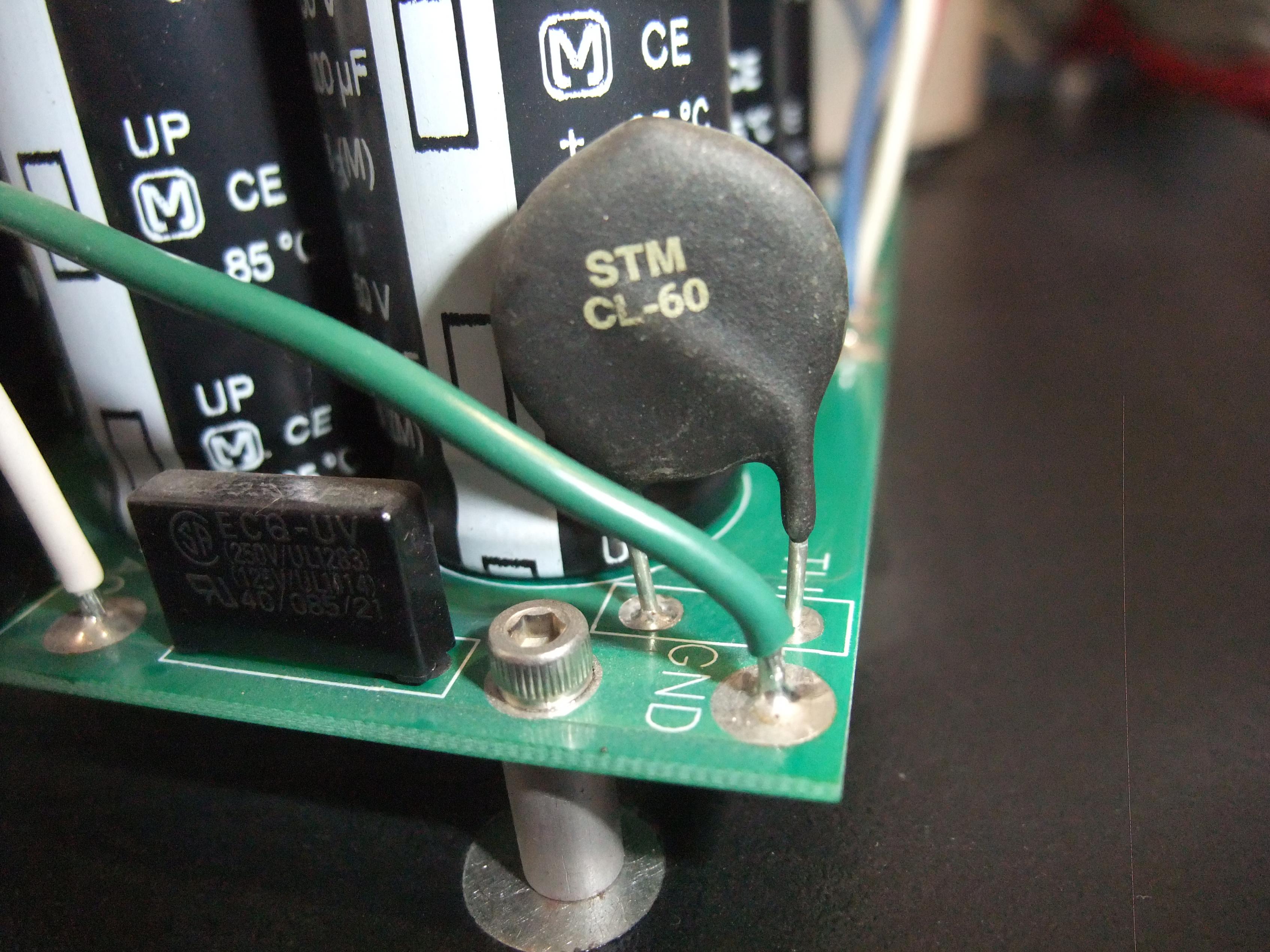

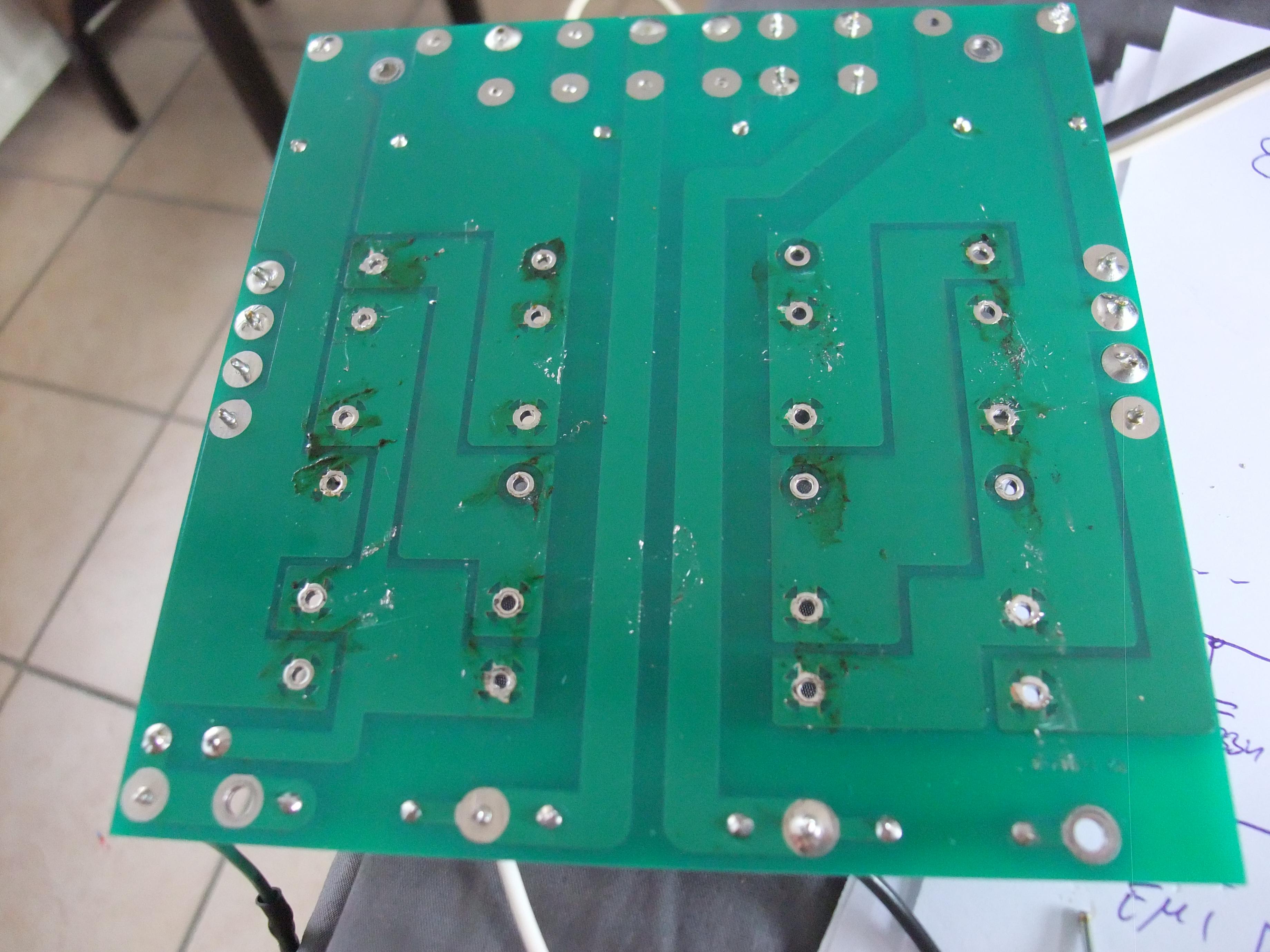

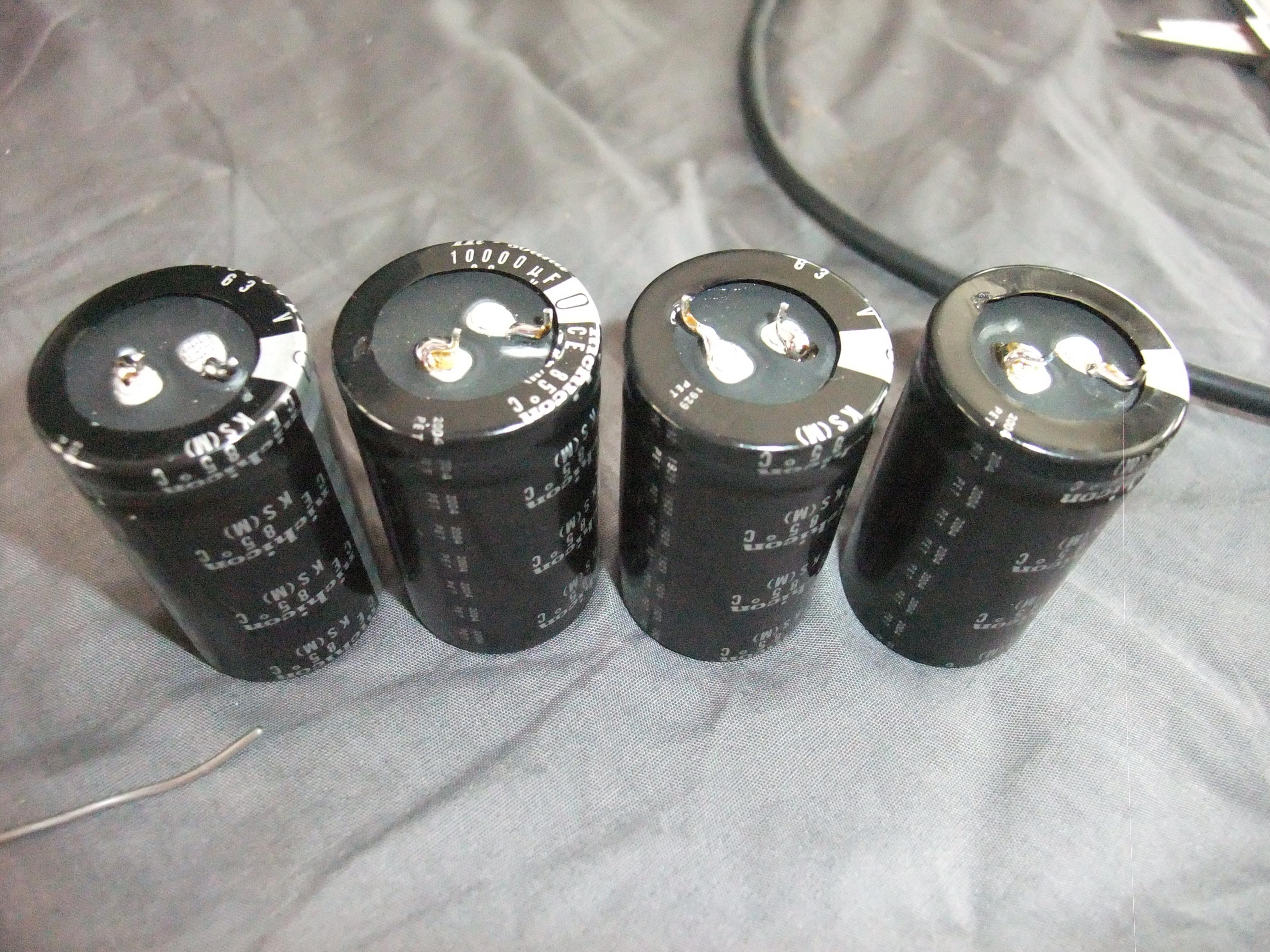

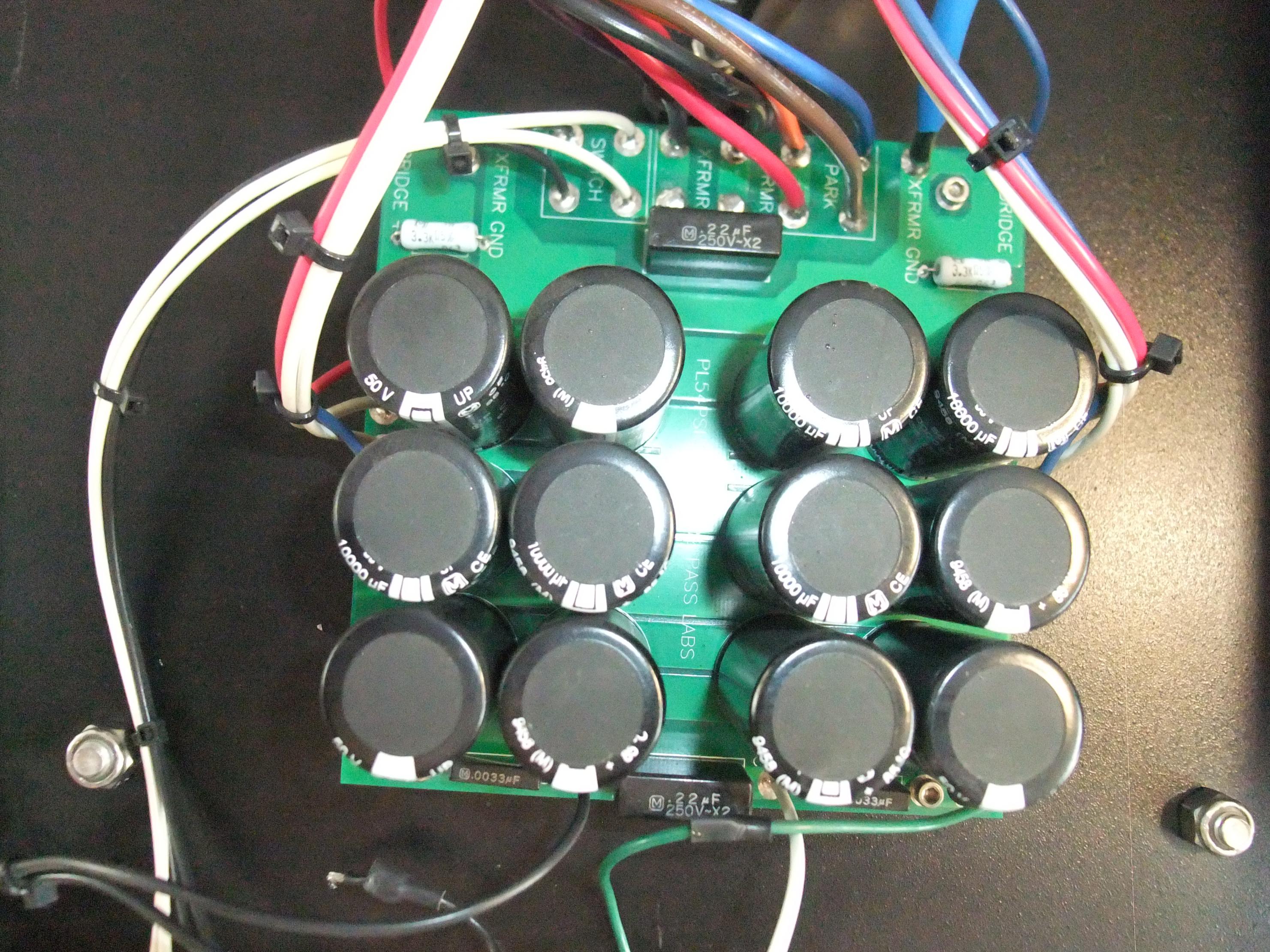

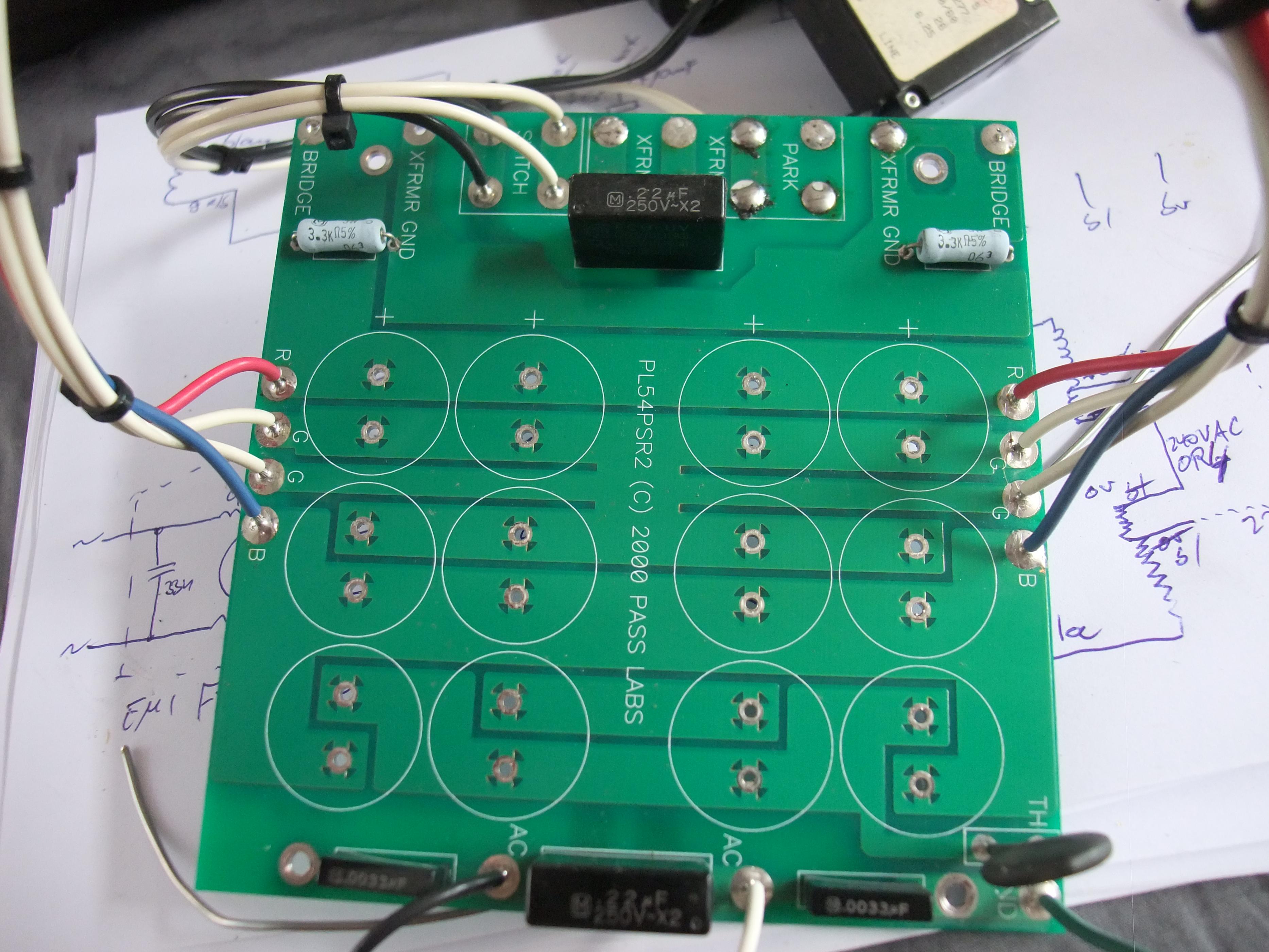

power supply PCB recapping
