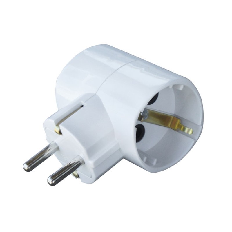

let him know that "ungrounding" some link in chain is normal (as long all is chained with interconnects) , if some link is making ground loop
in our neck of wood that thingie is called "lopov" - useful to test gadget without safety GND , simply removing safety GND tabs from it
if test is successful , making dedicated mains cable without safety GND is trivial

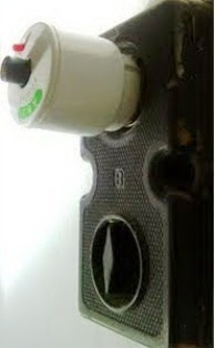

ZM alread give clear advice, get a picture of your MCB to confirm your house VA rating. when you mentioned old house fuse, i remember my hometown old house with ceramic socket fuse, it's placed after MCB and usually located at inside home. is it the one like I attached?
my family 900VA can survive 450VA transformer with huge cap bank, also tried aragon2004 without tripping the mcb or the fuse. that is already 50% of the VA rating.
with the X150 manual says "The X150 has a power transformer rated at 800 watts, continuous duty", I assume it might be 800VA.
with your claimed 15A house installation, it supposed not to trip. cmiiw
